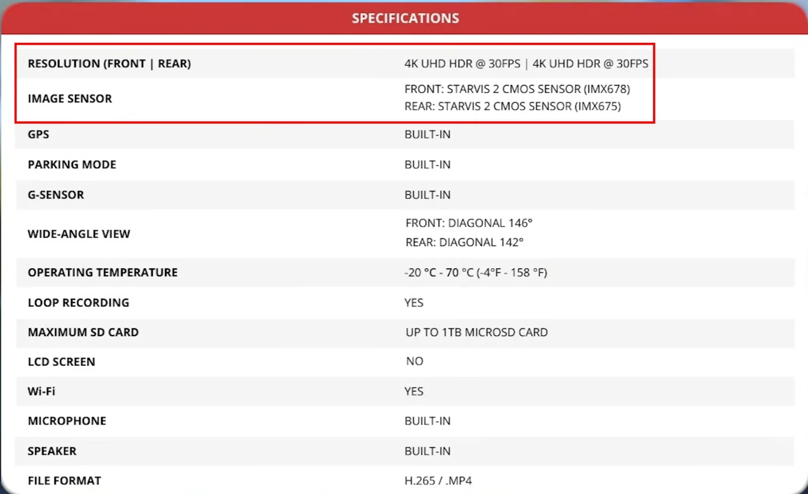

@BlackboxMyCar recently released a video discussing the Elite 10 dash camera. Unfortunately, the sections of the video where they list the specs for the Elite 10, they incorrectly state the Elite 10's 4K UHD rear camera has HDR support [which it does not] and that the rear camera has a Sony STARVIS 2 IMX675 [QHD] image sensor. I posted a comment on the video so they correct that information.
Here are two frame grabs from the Elite 9's 2K QHD rear camera with HDR and the Elite 10's 4K UHD rear camera without HDR. You can see "HDR" in the Elite 9's rear camera status line text while that is not present in the Elite 10's rear camera status line text. I believe Pittasoft will not be adding HDR support for the Elite 10's rear camera.
This is the specifications info page BlackboxMyCar show twice in the video:
The Pittasoft/BlackVue sales page for the Elite 10 is a bit misleading as well. The TAB for the image sensor and HDR support states "DUAL HDR", but that's not correct. In the lower section it states "HDR support on on the front camera". I'm sending an email to Pittasoft to get that corrected as well.
