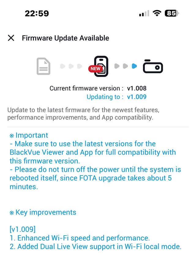

BlackVue ELITE 9 Firmware (v.1.009_2026.06.11)​
Elite 9 firmware 1.009 is now available for installation via the BlackVue app and the BlackVue website.
