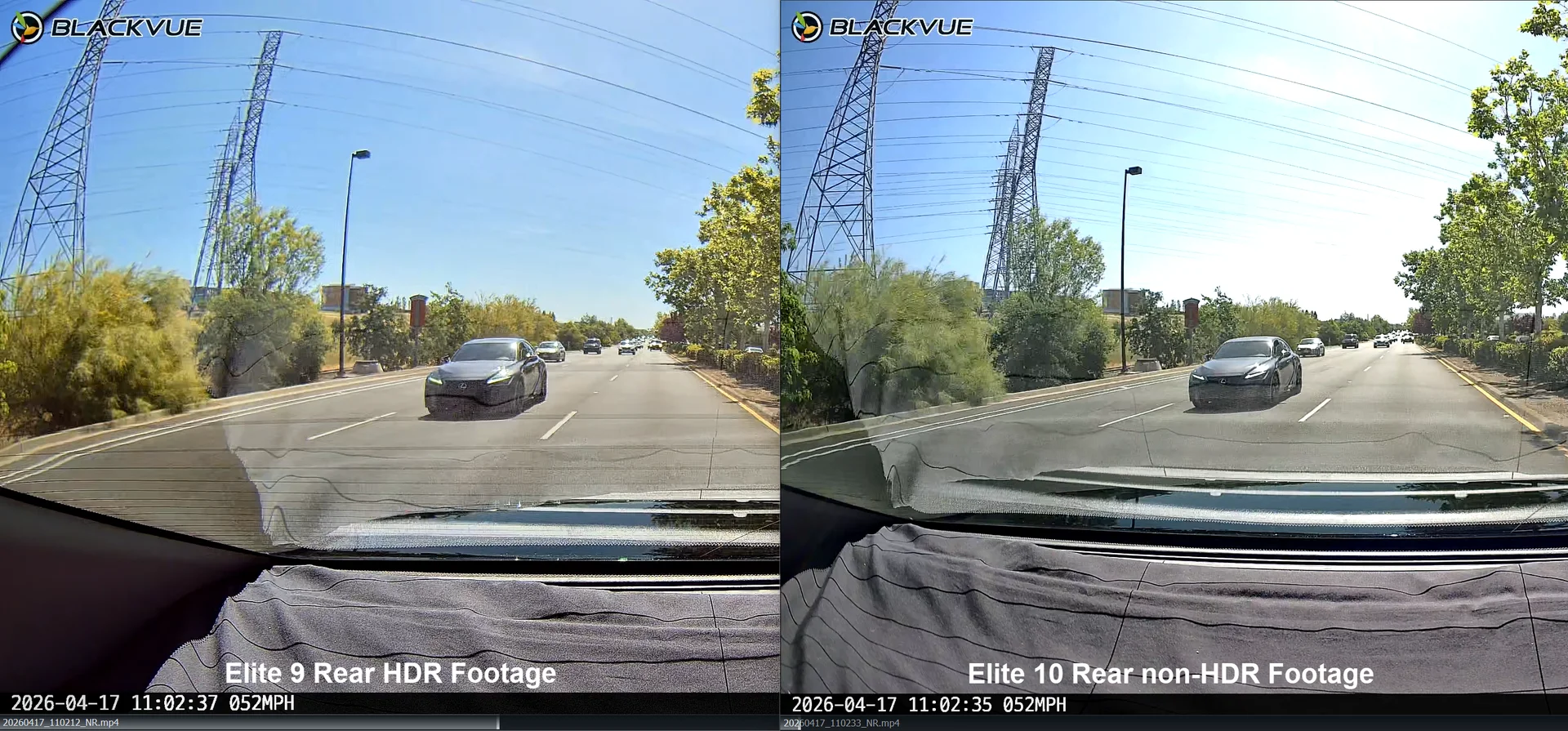

Looking at the Elite 9's 2K rear camera HDR footage compared to the Elite 10's 4K rear camera non-HDR footage, you can see how yellow the Elite 9's rear camera HDR footage can be.
The shrub on the left side of the image is very yellow looking in the Elite 9 rear camera footage. The Elite 10's rear camera footage has more realistic colors.

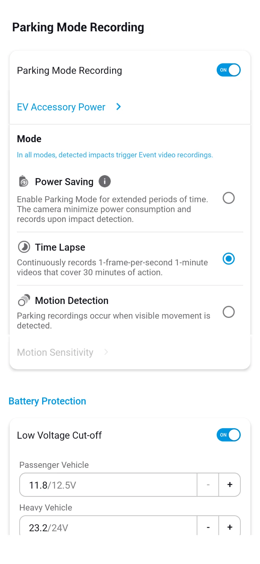

Sounds like you may have parking mode set to low power mode.
The camera goes in deep sleep when in parking mode - and try Cloud turns off to preserve power.
Change parking model option to time lapse instead and see if that changes your issue.
I have to do this when I plan on downloading footage, then remotely change the settings back to low power mode when I'm finished, so the camera goes back to sleep.

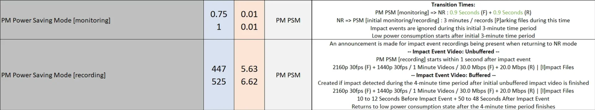

As @Dan-UK1415 mentioned, you most likely have the parking mode configured for power saving parking mode. I explain the manner in which that parking mode works back in Post #13 of this thread.
When the vehicle and/or battery pack ACC power provided to the dash camera is turned off, the dash camera will enter an initial monitoring/recording state for 3-minutes. During that 3-minute period it is creates videos [ignoring impacts]. After 3-minutes, the dash camera goes into power saving mode. If the CM100G LTE connectivity module is connected to it, that also shuts down when the dash camera enters power saving mode.
The dash camera waits for an impact event to awaken it again. It will start recording 1-minutes video(s) within 1-second of the impact being detected. If the CM100G LTE module is present, the dash camera powers up the LTE module and a BlackVue Cloud connection is established. That's when a push notification and any file uploads to the cloud take place.
After those video(s) finish recording, the dash camera goes into a 4-minute monitoring state, but this time it's not creating any video files. The LTE module remains powered at during this time period. If qualifying impact event takes place during that 4-minute monitoring period, the dash camera will create 1-minute buffered video(s) [10-to-12 seconds before / 50-to-48 seconds after]. When the 4-minute monitoring period finishes, the dash camera returns to power saving parking mode waiting for another impact event.

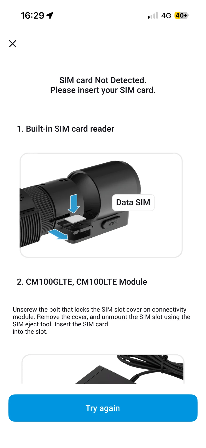

Thanks for the responses I do indeed have power saving mode on. What was throwing me was that blackvue tech support told me that when in parking mode the red recoding light should be green (unless detection or recording then goes red then back green once recording finished. I hear the cam say it’s done into parking mode but no green light. Maybe this is because of power saving mode also, not sure
Also I have to say I am not impressed so far. The cloud connectivity is just awful. It is hit and miss weather or not I can go into live view mode or playback videos. The are isa great signal so should have no issues in that respect. The big selling point for me for this cam was being able to remotely monitor if needed and it is just not performing. Firmware is all upto date
Check your SIM data connection and also what status the camera is in.
The Cloud/remote view function turns off when in low power parking mode, to preserve power.
If you change the parking mode setting to time lapse or motion detect parking mode, then cloud connection remains turned on all the time, but battery drains quicker.
Yes I have it on motion detected and same issues
Now getting this constantly when it was working and connected..this thing is so glitchy I wish I’d have got another now
