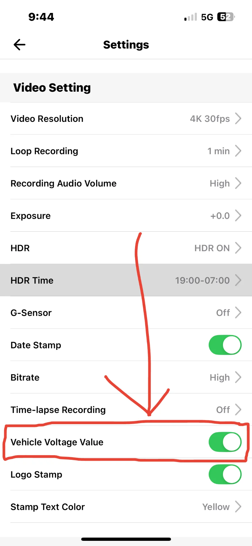

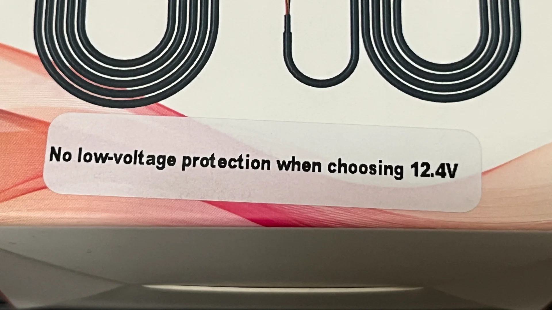

Does HK6 with no cutoff version display the voltage on the recordings from the dashcam? I just got one and the voltage display is gone.
Not all Viofo models have a voltage stamp. The voltage stamp can also be disabled in the dash cam menu.
I just checked.
What camera are you using?
Perform factory reset / default settings, and try again.

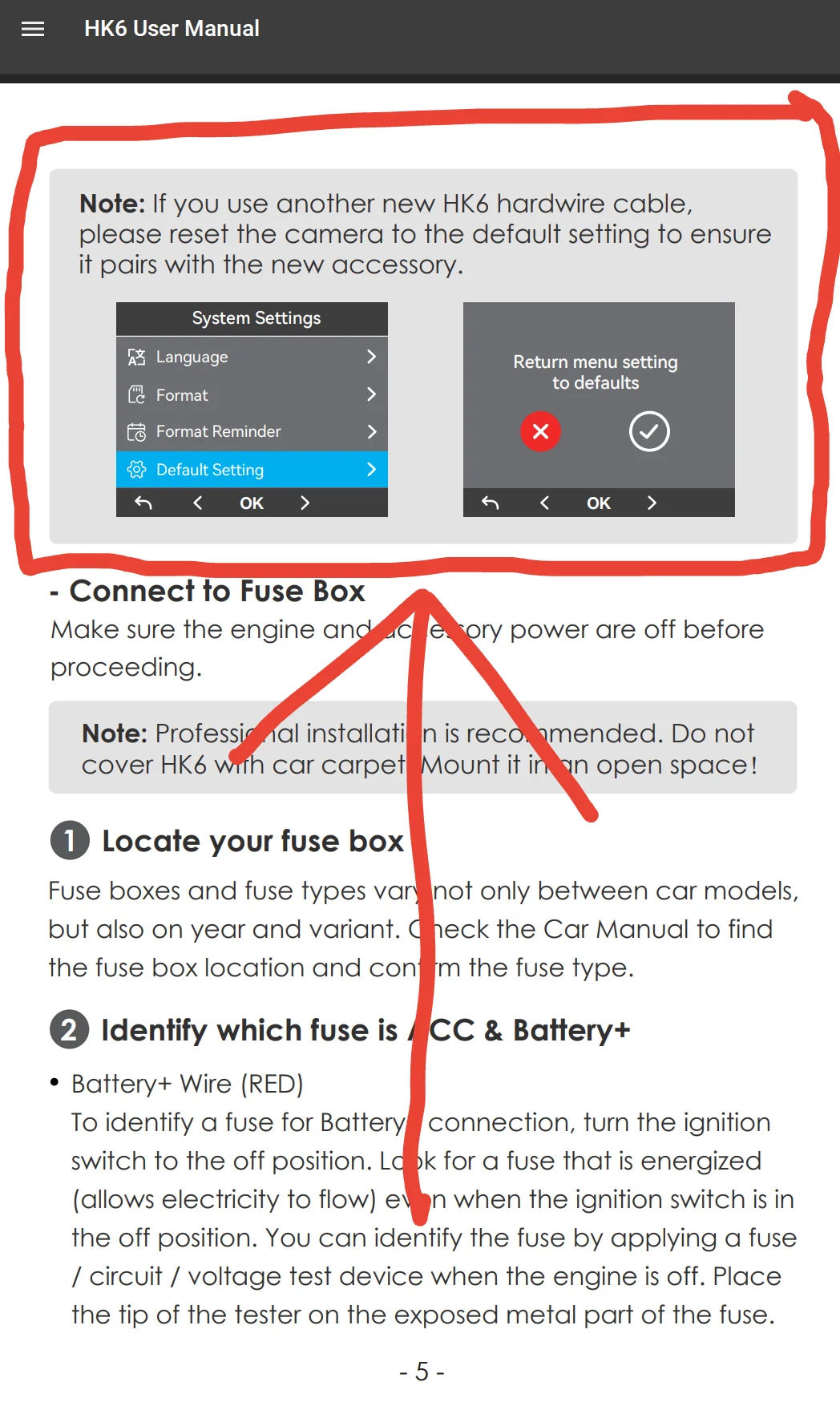

I have a A329S. I had the regular HK6 and it displayed the voltage no problem. When I switched to the HK6 with no voltage cutoff the voltage display is gone. And I just noticed today that I can’t set the voltage cut off for the hybrid parking mode says I don’t have a hardwired kit but I have the HK6 with no cutoff installed. I’ll try the factory reset and see if that fixes it
I’ll try the factory reset and see if that fixes it.
@Chuck McCoy said:
If we were classmates you would be in so much trouble for not RTFM 🤣
See page 5 of HK6 User Manual;
Well the new HK6 didn’t come with a manual, I’ll use that as my excuse 😬🤣. You’re good šŸ˜‚

Using the BP100 supplied dash camera power cable will give you all of the parking modes available in the A329S. The one thing it won't do is provide the voltage level being output by the BP100 like the HK6 would provide. The HK6 uses Bluetooth to broadcast the input voltage level observed by the HK6 to the dash camera. The A329S can present that voltage level in the video status line and it can use that voltage info for the "Vehicle Battery Protection" feature for the "Cutoff Voltage" feature. No using the HK6, you will still have hybrid parking mode available to you, but you can only use the "Cutoff Timer" feature to switch from AED,Time-Lapse,Low Bitrate to LPID parking mode.
If you obtain an HK6 with a setting for no low voltage cutoff, that will allow you to take advantage of the largest amount of the stored charge in the BP100 [like the 12V power cable supplied with the BP100]. The HK6 will broadcast the voltage level provided by the BP100 to the A329S and you can then take advantage of the "Cutoff Voltage" feature in the A329S in addition to the "Cutoff Timer" feature. The installer will need to splice the hardwire cable [the cable with just 3-wires] provided with the BP100 with the wires from the HK6 so it can plug directly into the BP100 dash camera output power port.

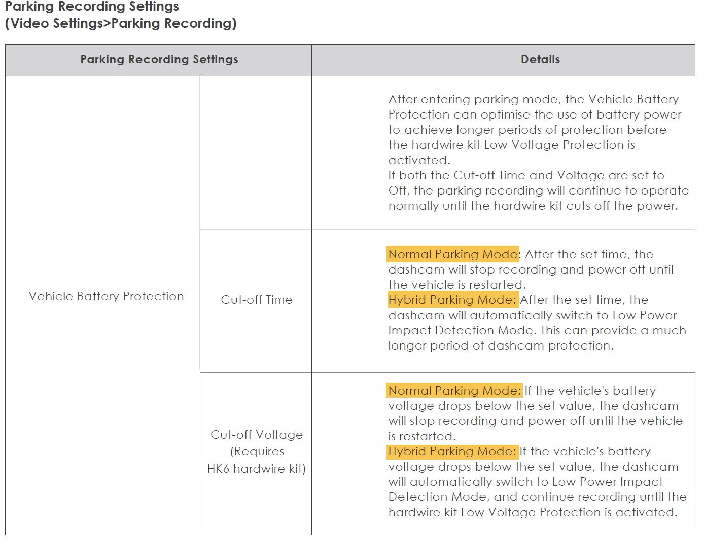

The dash camera doesn't decide to go into hybrid parking mode, that's a user choice in the dash camera parking mode settings.
With hybrid parking mode selected and when vehicle/battery pack accessory power is turned off, the dash camera will begin operating in Auto Event Detection [AED], Time-Lapse, or Low Bitrate parking mode until any of the "Cut-off Timer", "Cut-off Voltage", or "Cut-off Battery Percentage" [starting with firmware v2.1_260702] features have met their monitoring condition [time, HK6 Bluetooth published voltage, or VIOFO battery pack published charge percentage]. When any one of those cut-off monitoring checks have detected a parking mode transition is necessary, the dash camera switches from AED/Time-Lapse/Low Bitrate to Low Power Impact Detection [LPID] parking mode.
You can use the "Cut-off Timer" setting when the dash camera is powered by the HK4, HK6, or the VIOFO battery pack dash camera power cable.
You can use the "Cut-off Voltage" setting when the dash camera is powered by a HK6.
You can use the "Cut-Off Battery Percentage" when the dash camera is powered by a VIOFO battery pack [BP100 for example] and the A329S/T/WW/TC firmware is v2.1_260702 or later
The HK4 and the HK6 hardwire kits have their own low voltage cut-off feature. As you mentioned there is a modified version of the HK4 or HK6 that replaces the 12.4V low voltage cut-off setting on the hardwire kit module making it operate with the low voltage cut-off feature being disabled. The hardwire kit's low voltage cut-off feature is intended to be the thing protecting your vehicle's battery [when it obtains power directly from the vehicle].
When the dash camera's parking mode is set to "Hybrid Parking Mode", the dash camera's "Cut-off Voltage" setting will be the voltage level that the dash camera will transition to LPID parking mode. When the dash camera's parking mode is set to AED, Time-Lapse, or Low Bitrate [not via the Hybrid Parking Mode selection], the "Cut-off Voltage" setting will result in the dash camera powering off instead of switching to LPID parking mode. See pages 49-52 of the A329S user manual for a chart for those settings.
You'll notice the A329S "Cut-off Voltage" setting options are very limited [12.4V/24.8V; 12.2V/24.4V; 12.0V/24.0V] since that feature is primarily meant to be used with a hybrid parking mode configuration and it being the voltage level to transition to LPID parking mode.
If you're powering your dash camera with a dash camera battery pack, there's no direct/real need to have the hardwire kit's low-voltage cut-off feature functional. The lowest voltage level the HK4/HK6 hardwire kits low voltage cut-off feature can be set to is 11.8V. A dash camera battery pack can safely provide power into the low 10V range. Setting a modified HK4/HK6 to 12.4V via the slide switch on the hardwire kit, that disables the low voltage cut-off feature allowing the dash camera to get additional parking mode runtime [11.8V down to low 10V range].

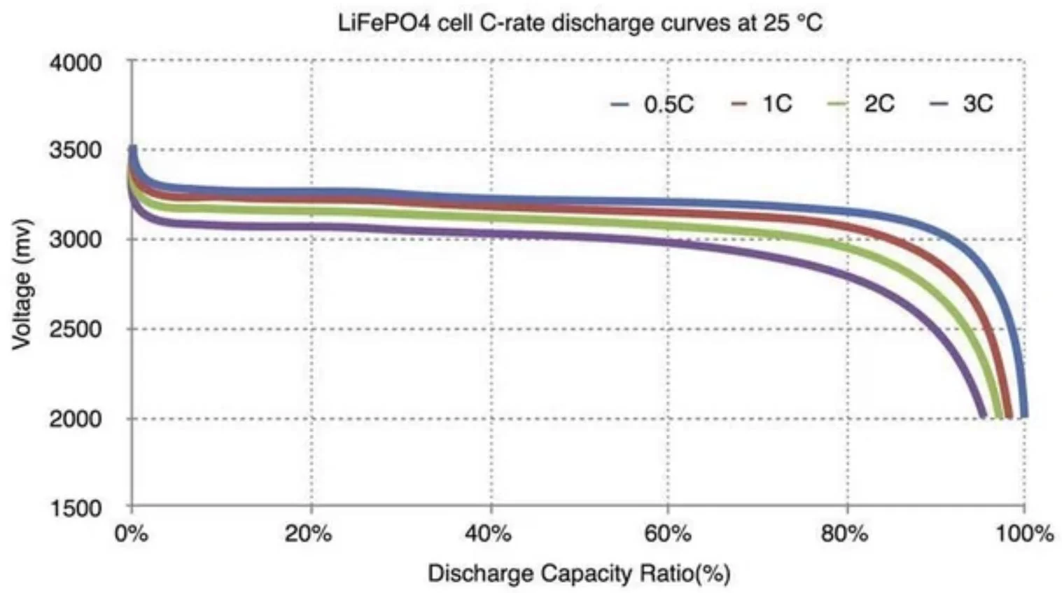

Right OK so that proves you can't really estimate the battery percentage life itself to the exact voltage.
The voltage has a varied reading.
OK that puts that to bed for me.
I wanted a hardwire kit to be equivalent to around 20 percent battery life but you just can't do that exactly with voltage.
