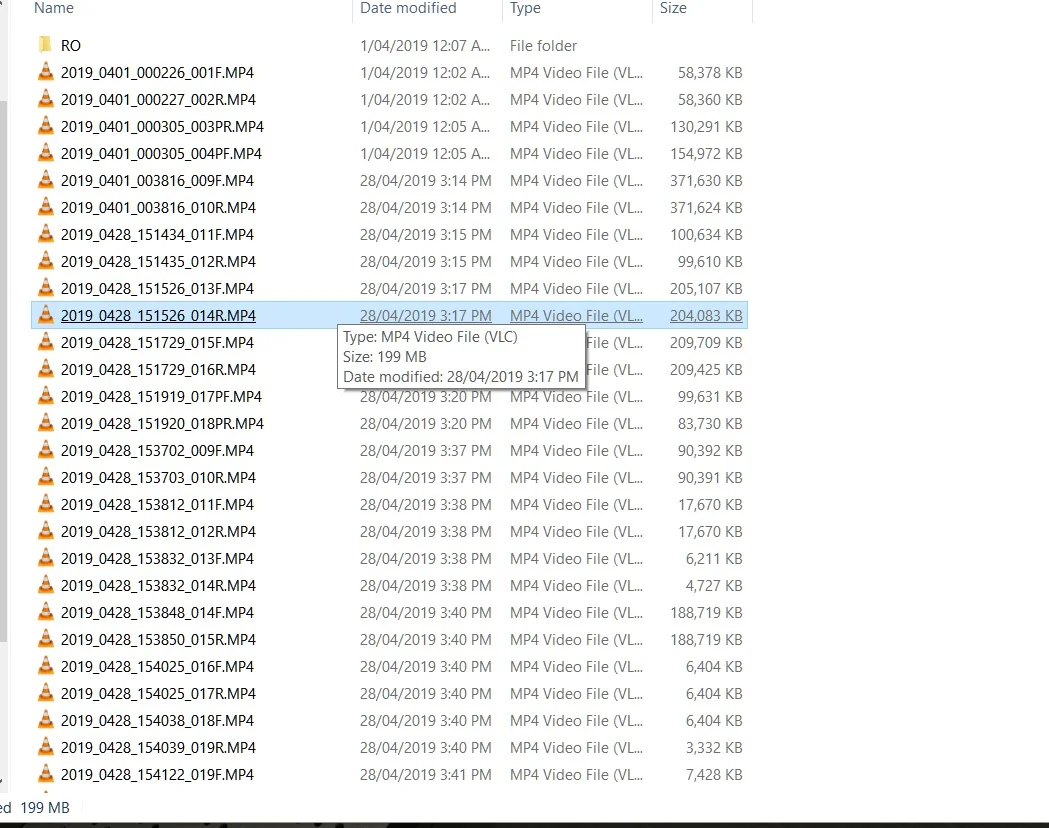

Great concept but its very buggy at the moment. Driving along it will just stop recording and then restart again. Look at the file sizes from my drive to the shops. Some clips are 6 - 10 seconds long at max.

May I know what settings do you need? Do you use hardwire kits, 2 wires or ACC hardwire kits?
I use the viofo 3 wire hardwire kit.
