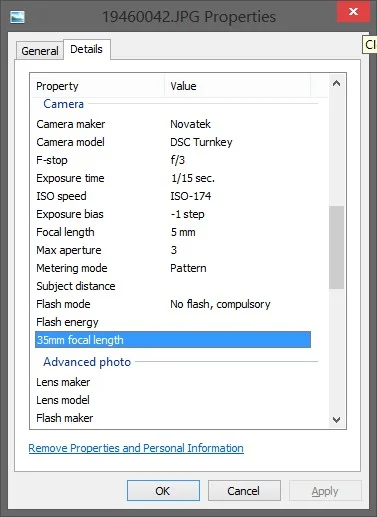

I have the same camera, but the firmware is 20121113, probably the date of fabrication. 😉 I don't know if it's a fake, but is a Novatek DSC Turnkey, unless the chinese managed to "fool" the chipset to show false informations. 😀
