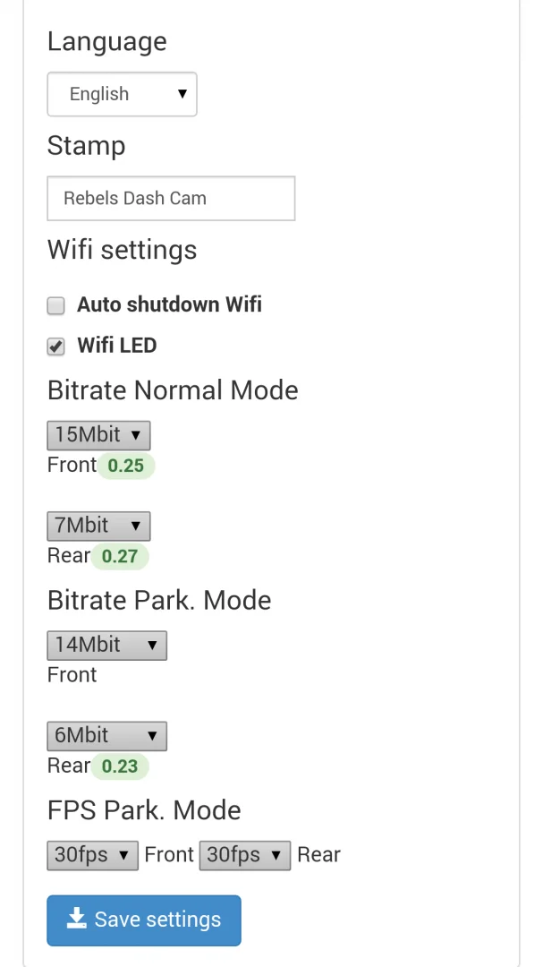

These are my settings for my Dash Cam. I don't get any stuttering. Any higher and I do.
