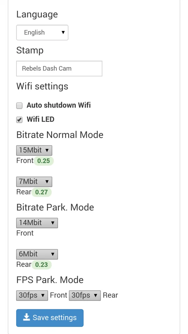

Alex what does the green numbers below the bit rate mean?
I do not go to custom firmware, I drive a stock DR550GW-2CH_v1.019R (2013.11.27)
Why? Less problems?
I was happy with custom firmware on 400 and 500, 550 lot of extra functions that interfere with each other. It is enough to increase the bit rate and the rest to leave the default, but the guys have progressed much further, they are great, but for me everything else is superfluous.
Someone like always something flash, I'm tired of this.
Yeah I can understand that. With your v1.019R you can change the bit rate yes?
