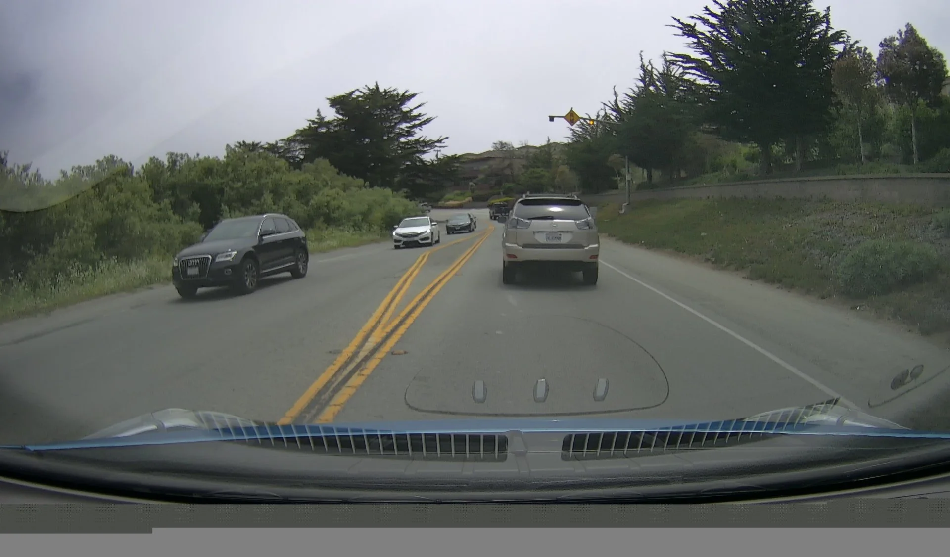

I am testing DDPai Mini 2 and I am a bit thrown off by the lack of clarity...is this consistent with what others have?
I mounted my Mini 2 on the rearview mirror so the angle is not perfect as it gets a lot of the dashboard but even so, I would expect sharper results at 2550x1440 resolution(although it is only at 10.5mbps bitrate). I will try to post comparison with my A307 dashcam which has almost identical bitrate at 1080P(11.5-12mbps). I will try setting the camera to the 1080P mode. I have a feeling the footage will look better with the lower resolution at the same bitrate.
I am able to make out the place of the car in front of me but the cars to the sides are pretty blurry.
This was Peninsula/ San Francisco CA area with 60 degree sunny weather. I took pictures with the cellphone DDPAI app while stopped at traffic lights.

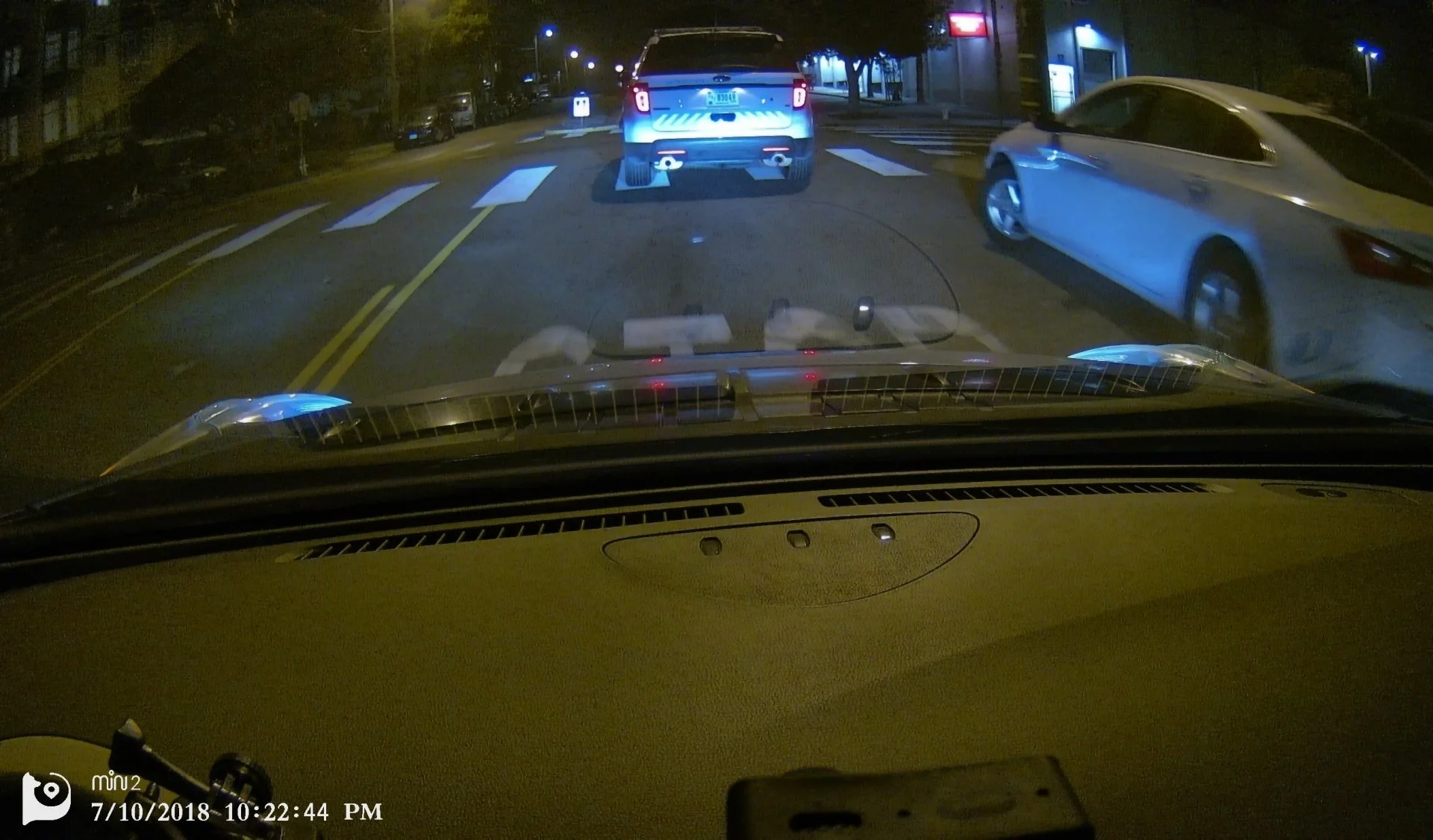

Night time quality is ok and I can make out the plate in front of me if I get right up on the other bumper and the vehicles are stopped. I tried taking picture grabs even with slightly movement like rolling to a stop and it gets blurred.

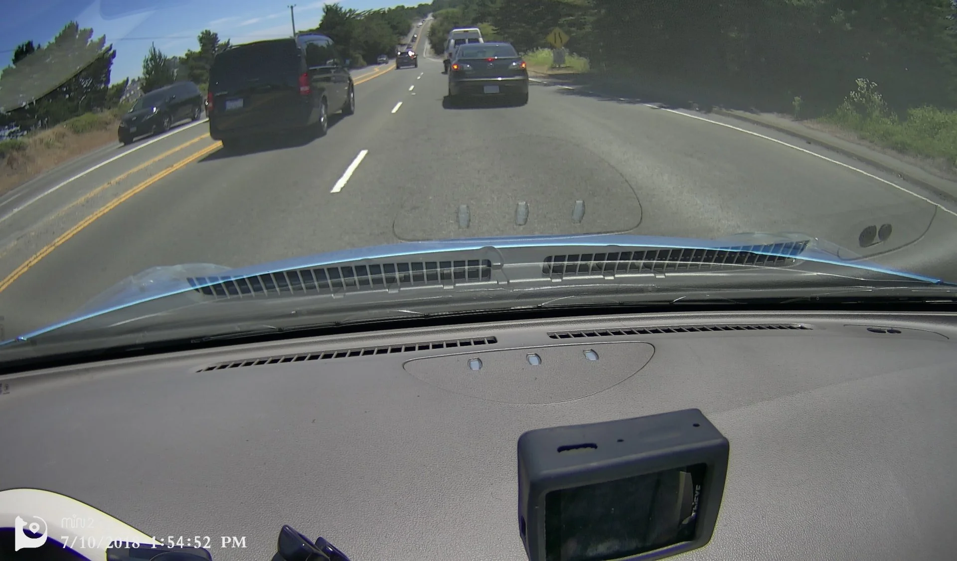

Something wrong there , images are grainy .
I removed the dash mat and despite the glare, the quality did improve.
I recorded in 1080P in daytime and 1440P during the night. I will record daytime in 1440P with mat off to see how much better the quality will be. Though for some reason I could not download any videos over Wifi today on two separate tries. Not sure what the issue is...I was unable to check the quality video wise.
I am impressed at the clarity of the plates with some lights. The plates get blurred during motion but during mostly stationary movements they are fairly good.

You need to reposition / possibly use the cinema view to get rid of that dash board as the view is centering on it .

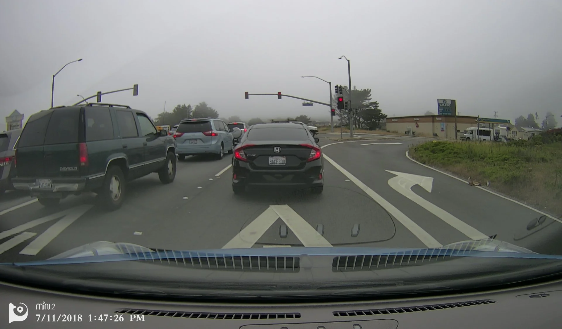

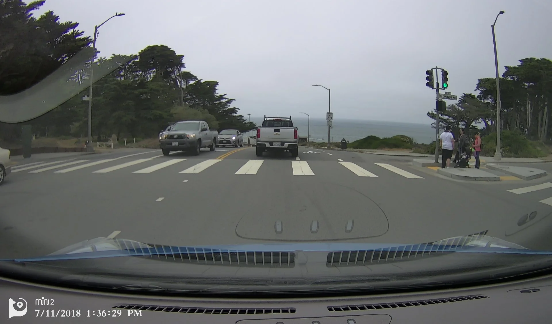

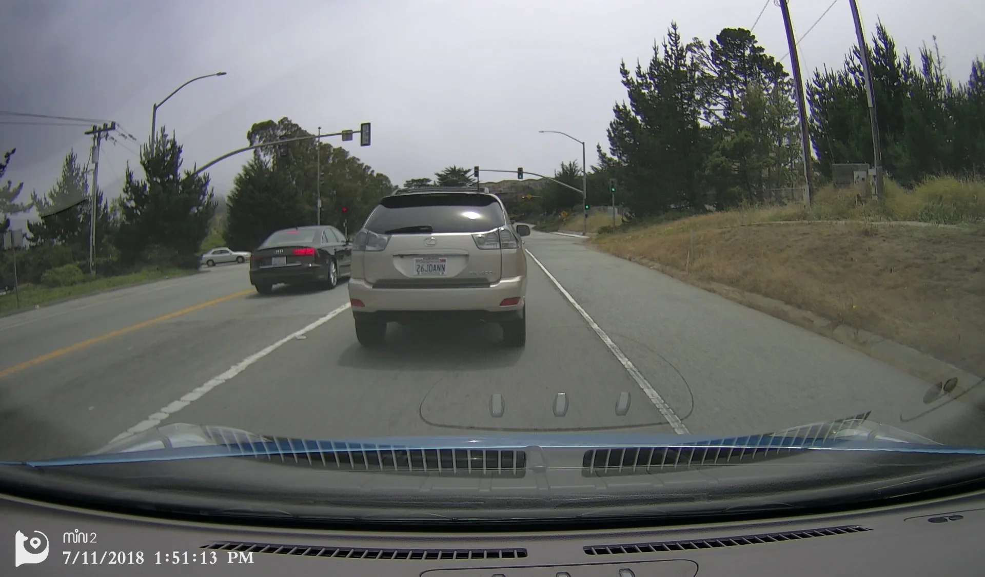

Since photos through apps were saved directly to my S8+. Here are the photos from today. Camera was repositioned, dash mat was removed, and camera was set to 1440K.
The camera has good/great video quality while stationary with decent amount of light however it does not handle vibration too well. While driving it is very difficult to catch any plates of passing vehicles.
