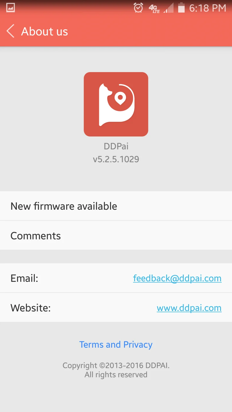

And here is my latest fw on mine here in the United States.
3.5.2.10 is another release I haven't seen yet. Will check the Chinese forums to see if there is any feedback. The consensus seems to be on the Chinese forums to not upgrade, or to roll back to a previous firmware. Google translate is terrible though, even with it, it's hard to understand what is really going on.
I'm holding out and not updating just to be safe until I see some more positive comments.
