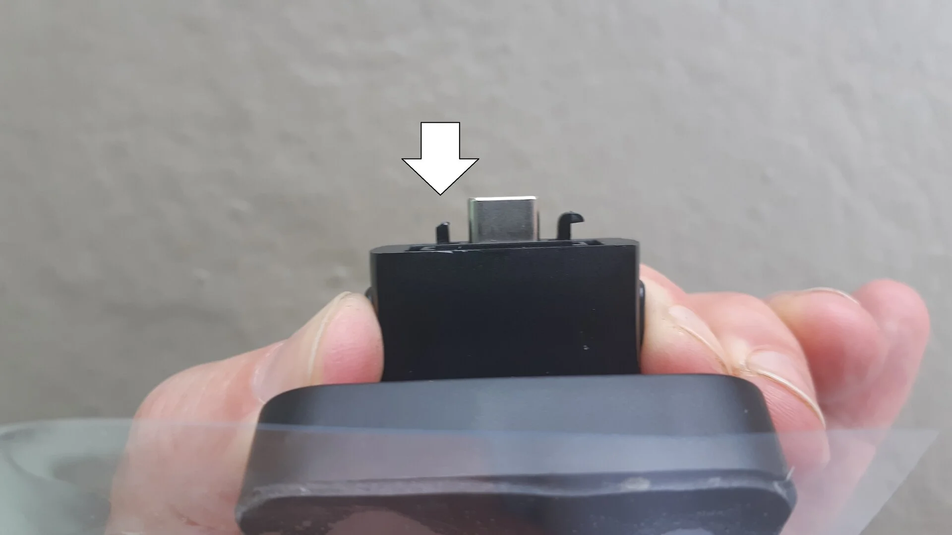

Hi friends.
Clip broke and DDPAi Official does not provide replacement parts, does anyone know where to buy?

Unfortunately there is one problem: standard mounting bracket. I did some research on its wiring using a simple multimeter:
the CC1/CC2, SBU1/SBU2 pairs are shorted and the SBU1/SBU2 pair is passed through to microUSB D+ (green cable).
microUSB D- (white cable) is not connected. Now i'm wondering how do they use the hardware kit.
