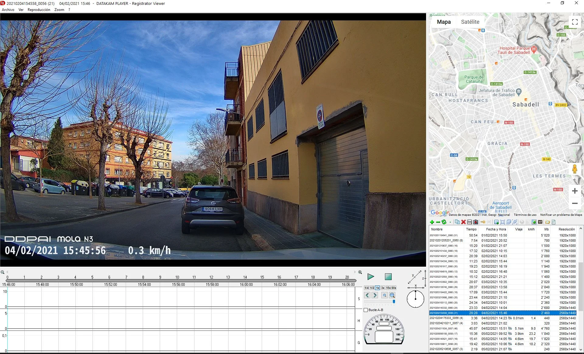

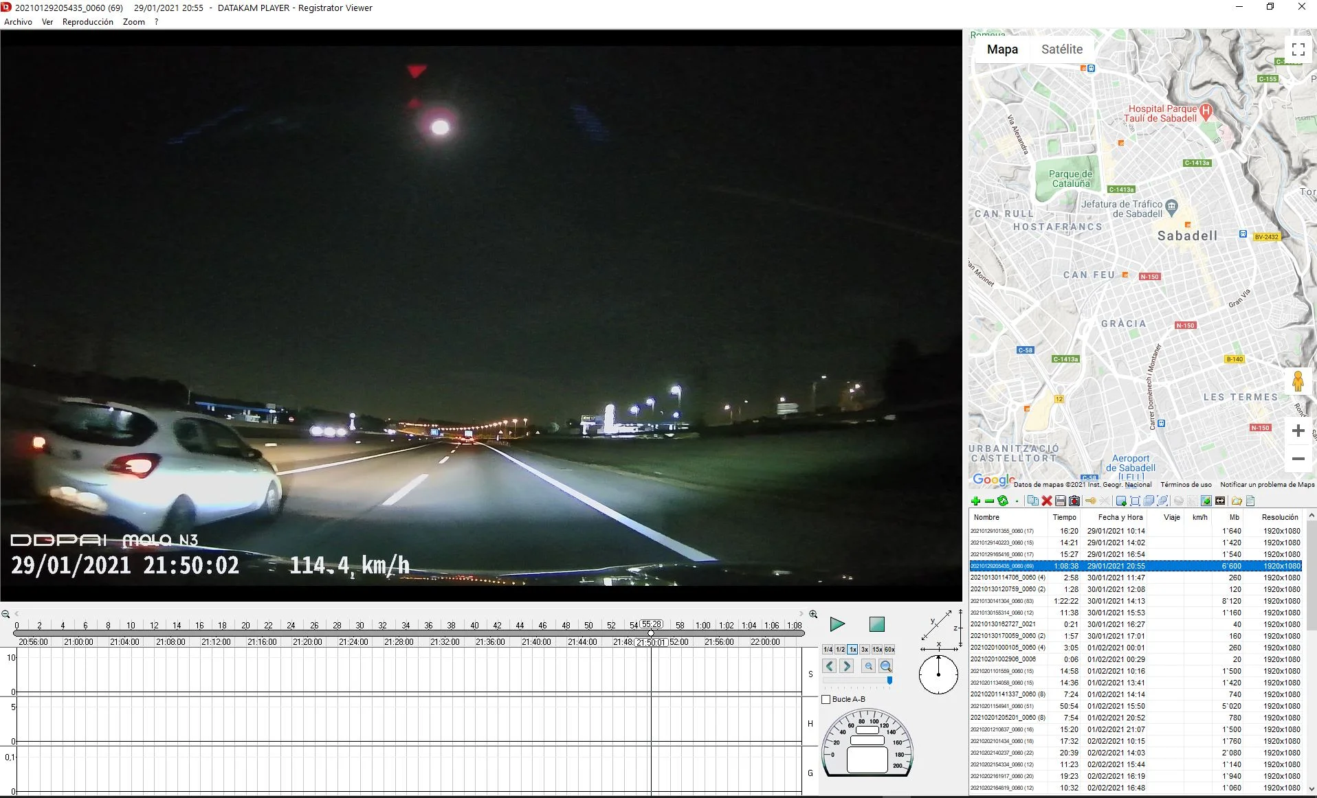

I have returned to testing and copied the entire contents of the microsd card to a local folder.
I have observed that no information appears from the GPS data prior to a certain date (02/04/2021). Before that date, the info of the traveled routes (distance, speed, height, etc.) does not appear.
After that date, the GPS data does appear.
I've checked twice by copying all files back to a local folder and the same thing happens again.
I have looked in the local folder E:\DDPAI MOLA N3\DCIM\203gps and there are no .GPX files older than that date.
However, in the local folder E:\DDPAI MOLA N3\DCIM\ 200video\ front there are still all the .MP4 video files prior to that date.
The oldest video files in E:\DDPAI MOLA N3\DCIM\200video\front are dated 01/29/2021. Videos from that date (01/29/2021) play well but without GPS data.
Any idea why they might not appear?

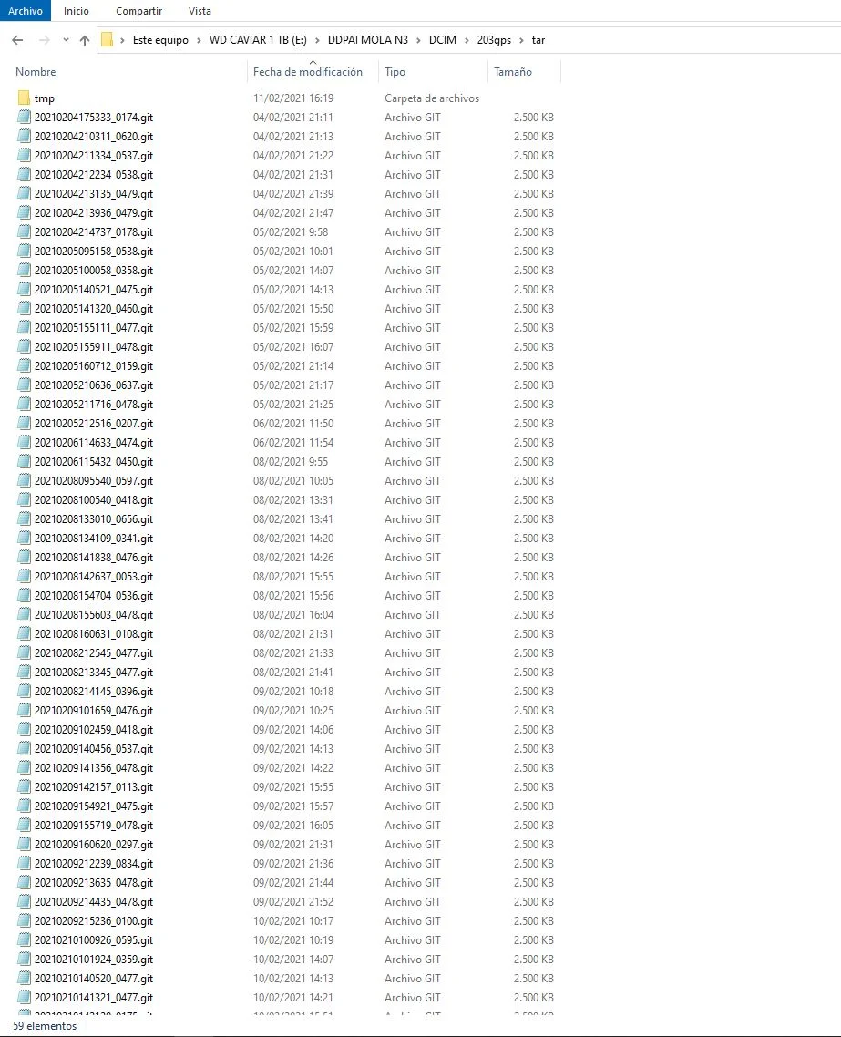

See if you have the gps files for those dates archived in the 203gps\tar folder with the extension as .git. If they are not there, then there is a chance that the camera might have erased them permanently.
Vea si tiene los archivos gps para esas fechas archivados en la carpeta 203gps \ tar con la extensión como .git. Si no están allí, existe la posibilidad de que la cámara los haya borrado de forma permanente.
I have looked and they are not all gps files. Older .GIT files are also dated 02/04/2021.
I guess the camera must have erased them.
