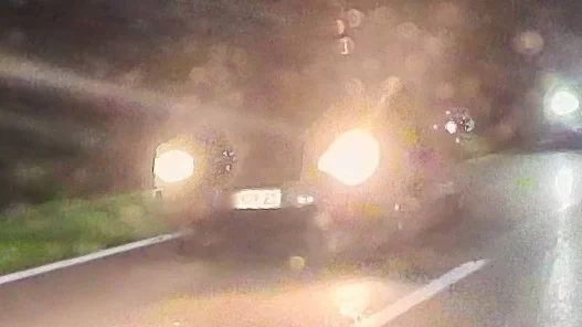

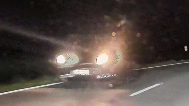

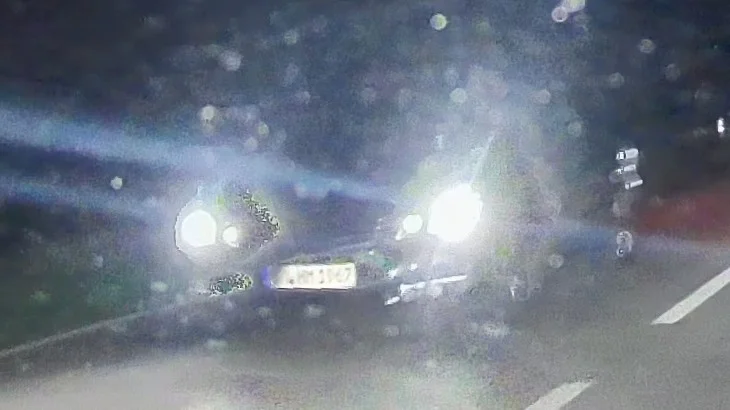

I checked a huge selection of night time footage.
While the Z60 Pro easily handles daytime footage, it is just not able to capture the plate like its competitors.
In most cases, the plates can not be identified. There isn't much missing to make out the plates.
It seems like the HDR needs some improvement.

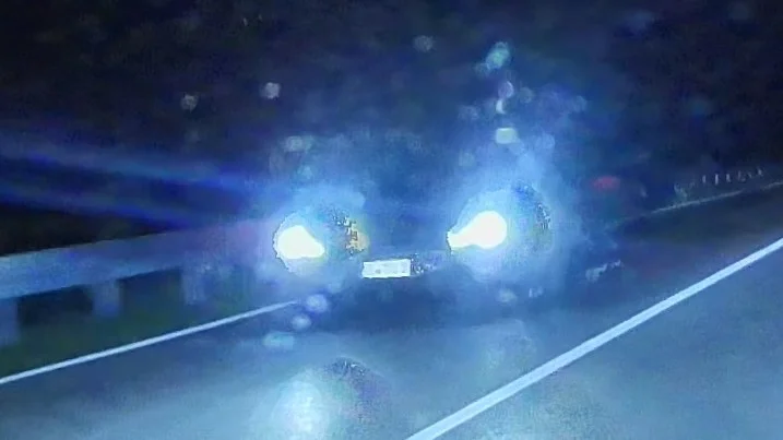

View attachment 83789View attachment 83790
These two plates can actually be read.

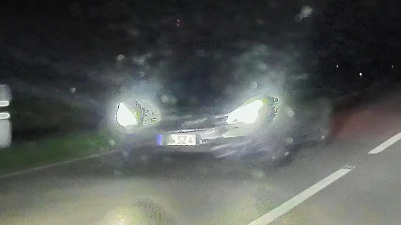

View attachment 83791View attachment 83792

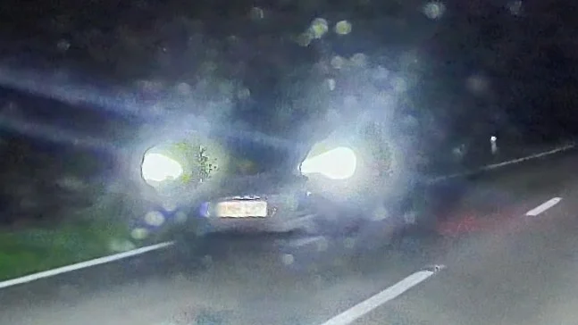

View attachment 83793View attachment 83794
View attachment 83795View attachment 83797
If DDPAI spent some time adjusting the firmware, I bet they could improve it to make most of the plates readable.
It is not that "the HDR needs some improvement" as such as probably it is impossible to set the HDR to a level that it can automatically(!!!) adjust itself to handle any and every lighting scenario. No, it needs a manual "exposure value" setting (example: Viofo-style) in the software! So a future firmware update and ddpai app. update can fix this painful shortcoming. I have already let DDPAI know about it and they unofficially acknowledged that the introduction of the "exposure value" setting would be extremely useful in a future software update but they have other priorities as well so this might not be top priority at their end. Until they fix this we have to live with top notch hardware without the matching software.
We, the end users, are guilty as well for the less than ideal night-time number plate-reading performance. Look at the reviews on the net! Even in case of the Viofo dashcams (with adjustable "exposure level") most of the time the the focus of the reviewers is on the "general picture" instead of the "ability to read number plates at night". Put it this way: I have two Viofo dashcams (A229 Plus with the RTC300 telephoto and hands-on experience with the A119 mini 2 dashcam as well) and two DDPAI Z60 Pro dashcams. If I leave the Viofo dashcams at the out of box factory setting (0,0 setting of the "exposure value") then I will have a very nice generic night picture but plenty miss with the number plates. If I adjust the "exposure value" to -1,0 the generic night picture would not be as nice as it was with the out of the box factory setting but the number plates will be readable for a change and as far as I know the main purpose of a dashcam is to read the number plates of the other cars as much as possible. Now, not every end user share this view therefor most of the manufacturers offer the best generic night pictures and simple ignore the night-time number plates-reading ability. You can't have a miracle setting for this (dashcam) price-range that provides the most beautiful generic picture at day and night and at the same time can read number plates perfectly at night-time with any light scenario! Impossible!

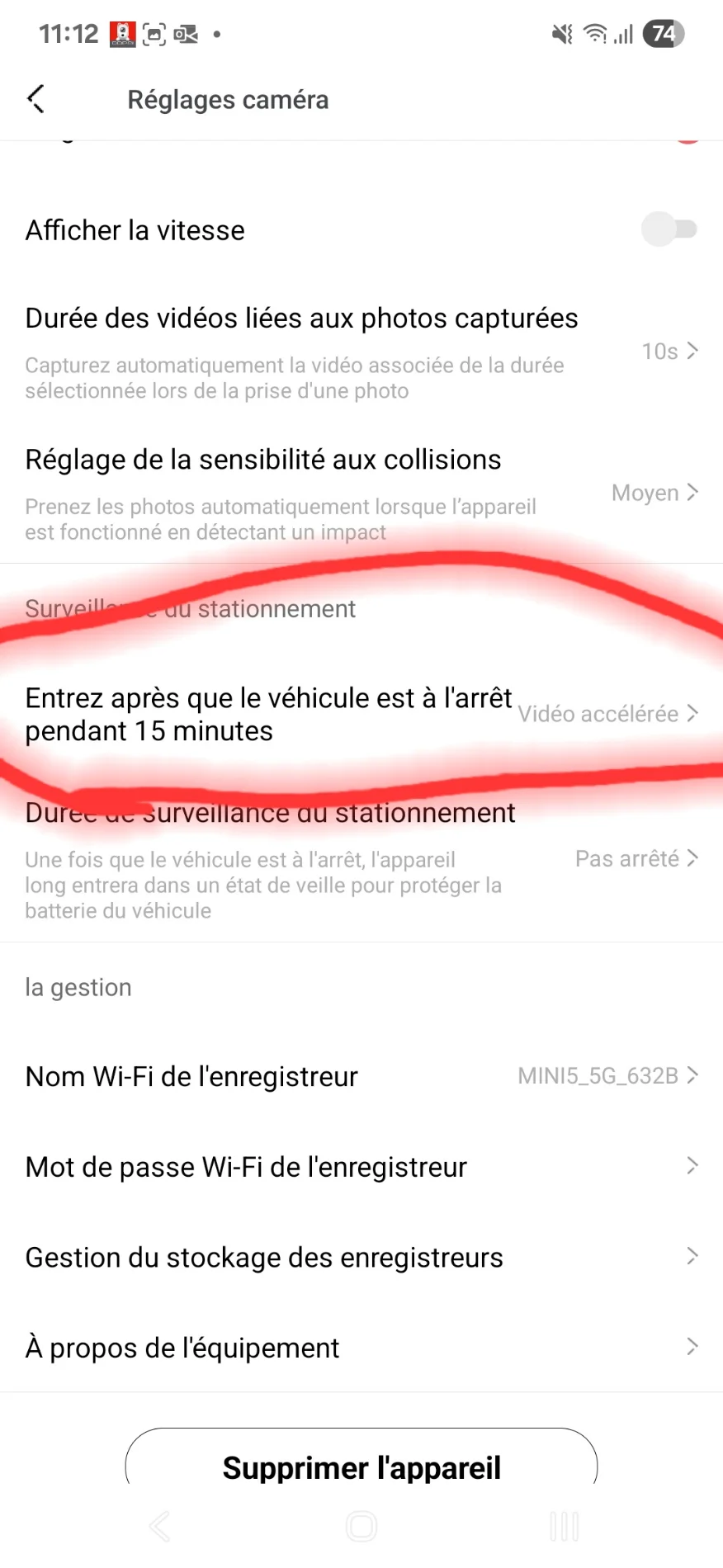

I found the option to activate the mose parking after 15 minutes of inactivity of the vehicle directly in the camera options 👌

I rejoiced too quickly 🥴 The z60 pro option allows you to turn off the camera after 15 minutes witouth hardwiring. But no time lapse like with my previous ddpai Mini5. So when I'm on my power bank it can't be put into time laps recording after 15 mins after of parking
