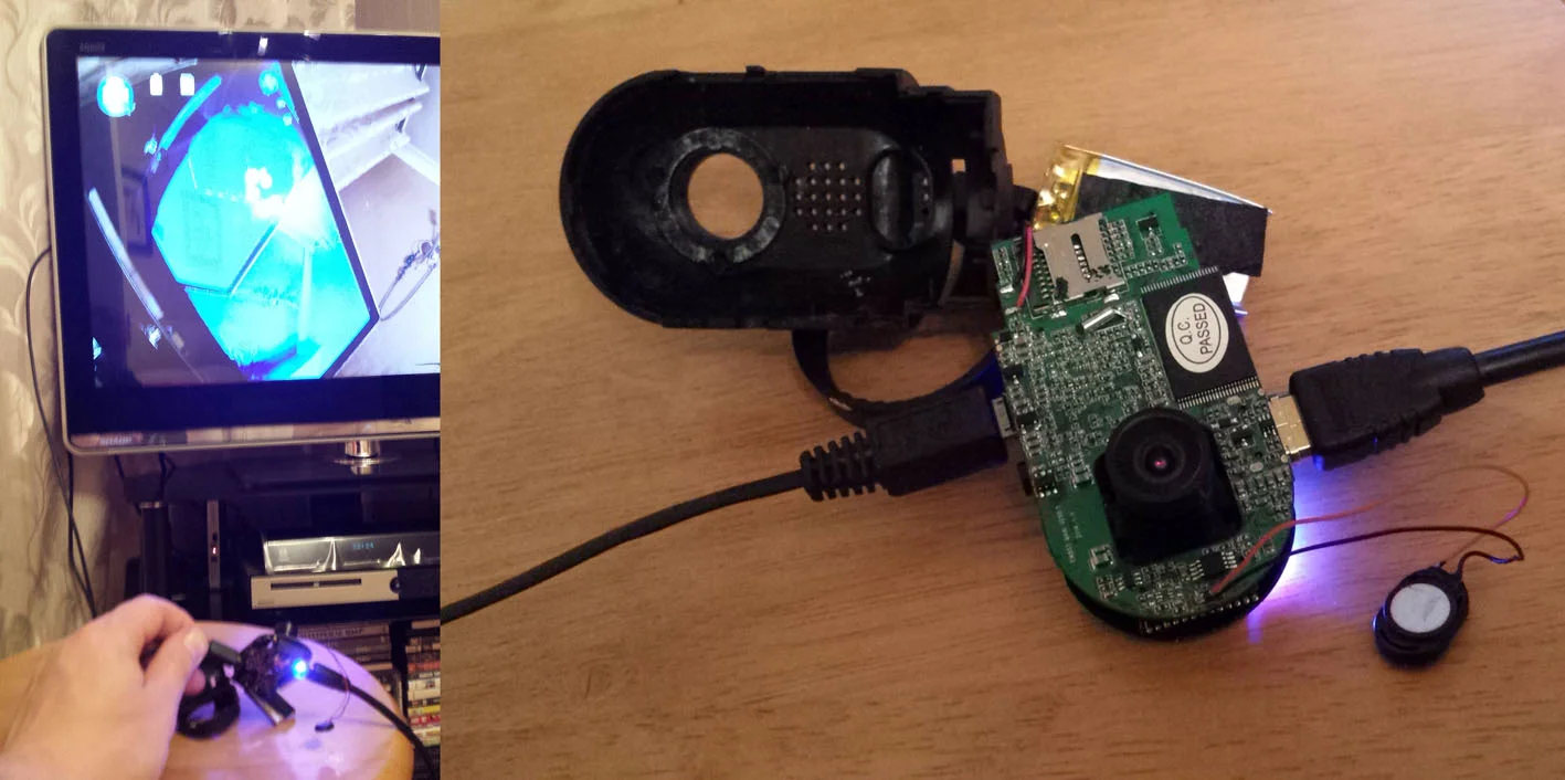

Step by step how to disassemble Mini 0803. Same applies to Mini 0801.

Thanks for the teardown. Future battery changes will be pretty simple or swapping one for a capacitor.
That space looks pretty tight for a capacitor. Anyone know of one that'll fit?
I'm sure I could find something that fits, provided it has just enough power to shut down cleanly and keep date/time.
Also a mod could be, remove the battery put a small hole and use some double core wire and use a capacitor external to the device and hidden in the vehicle.
Hope you bent the pins back on the board before assembly 🙂
Also impossible to put the CMOS on a longer cable like mobius as it's mounted directly on the pcb.
U have good eyes 😉
Yes, one pin I accidentally bent when opening, but for sure I bent it back before putting all together.
