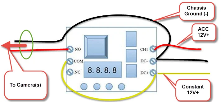

erkme73, your diagram looks a little different than your photo or did you just use different colors? I've righted your photo to make it easier to compare the two.
The colors don't match, but the wiring is the same. At the time of the install, I thought the coloring nomenclature was red = constant, and yellow = ACC. Obviously that's reversed. But, I'm not OCD enough to go back and rewire it. The schematic I modified is the correct color scheme.

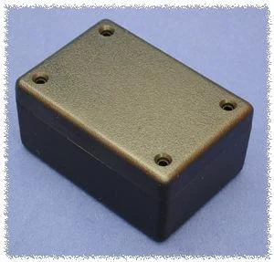

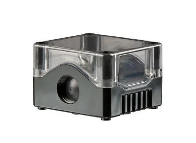

I found two cases that'll work with the timer. One is 3.2" x 2.2" x 1.1" and is a simple, no frills black case, but it will require me to trim the corners of the PCB slightly–probably with a Dremmel. The second is larger at 3.15" x 2.85" x 2", is thicker and better built, and has a clear cover (so you can see the timer innards without opening it), and it doesn't require any PCB modifications.
Plus, I may be able to drill (4) holes in the cover strategically positioned above the push buttons on the PCB so I can insert a paper clip to make timer adjustments without having to open the unit up. But at $17, it's over twice the price of the simple black case. And if I'm going to purchase the more expensive clear covered case, I need a good place to mount the box–which is still alluding me. Any ideas?
BTW, if I do go with the cheaper case are there any issue with using a Dremmel to remove a .25" quarter circle from each PCB corner? This is required to clear the case posts, which are bigger and closer to the case edge than erkeme73's Radio Shack case.
Here are the two boxes I found. Actually, both seem to be pretty good quality, but the clear cover case option (right) already has (2) 20mm knock out holes for the wiring, which is a nice time-saver.

I've just hardwired a pair of dashcams with a fuse tap on an ACC-on fuse, and a 12v to 5v step down with two usb outputs like this: https://www.amazon.co.uk/gp/B00GXXFBC0
However I'm quite tempted to wire up something like this so I can keep it on for a set period of time after taking the key out. I just haven't completely pictured the circuit in my head and am confused about one thing (or maybe more things I just don't know about!)
What I think I know:
The wire from the always-on fuse tap goes in to the DC+ input and then the COM in series
The wire from the ACC-on fuse tap goes in to CH1 input
The NO goes out to the step down converter (using the red wire as per the amazon picture)
The DC- goes out to the chassis
What I don't know:
Where does the ground (black wire) from the step down converter, that is currently wired to the chassis, go? Does it stay where it is or does it need to come back to the relay?
I'm sure this is obvious but my feeble mind can't quite imagine the circuit here
Much thanks
p.s. Also, which order do I have to cut the wires to defuse it before it explodes?
