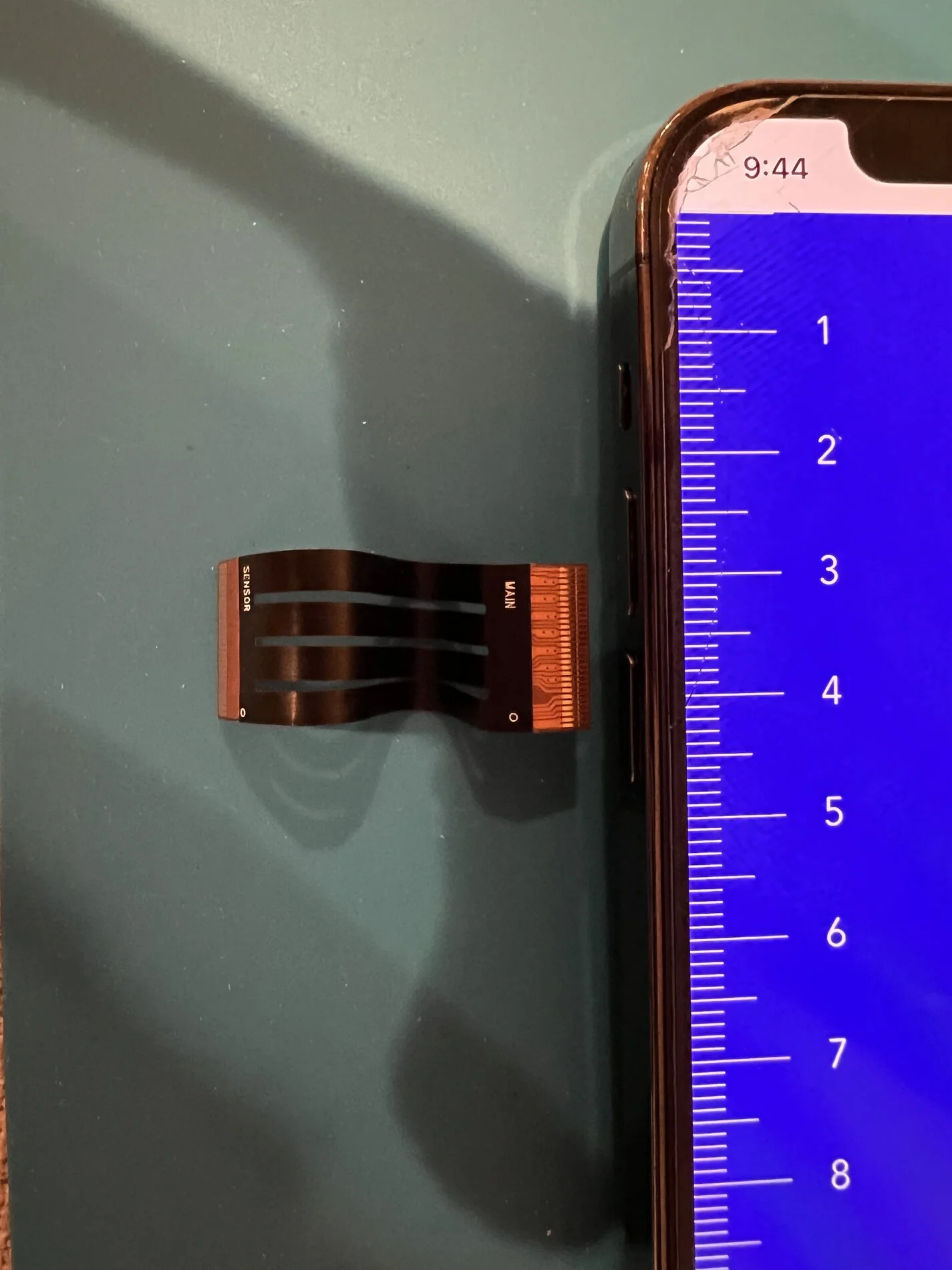

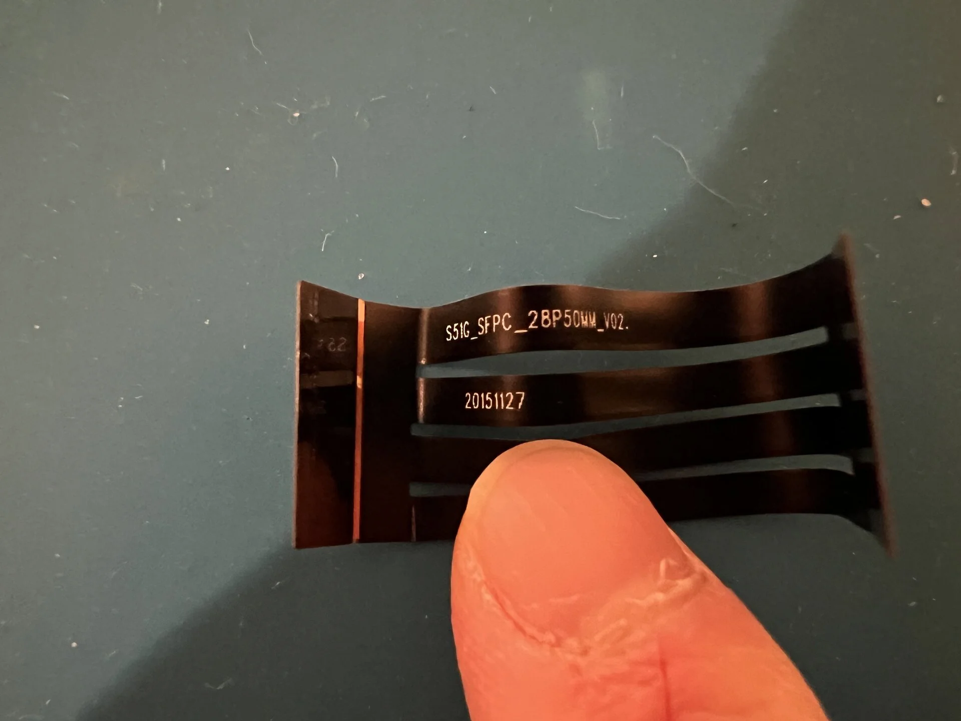

You can buy a cable from the camera to the main board on Aliexpress or another site.
If my memory serves me correctly, 28 pins 50 mm, check the markings on the cable during disassembly.
If you can’t find 28 pins, you can take more and cut off the extra tracks.
Tested, it works!
Example of a loop:
Tested, it works!
Example of a loop:
That is very helpful!
If I decide to buy a third party cable, following should be the spec:
28 pins, 0.5mm pitch, 50mm length, contact on the same side
Not sure about the thickness of the cable.
