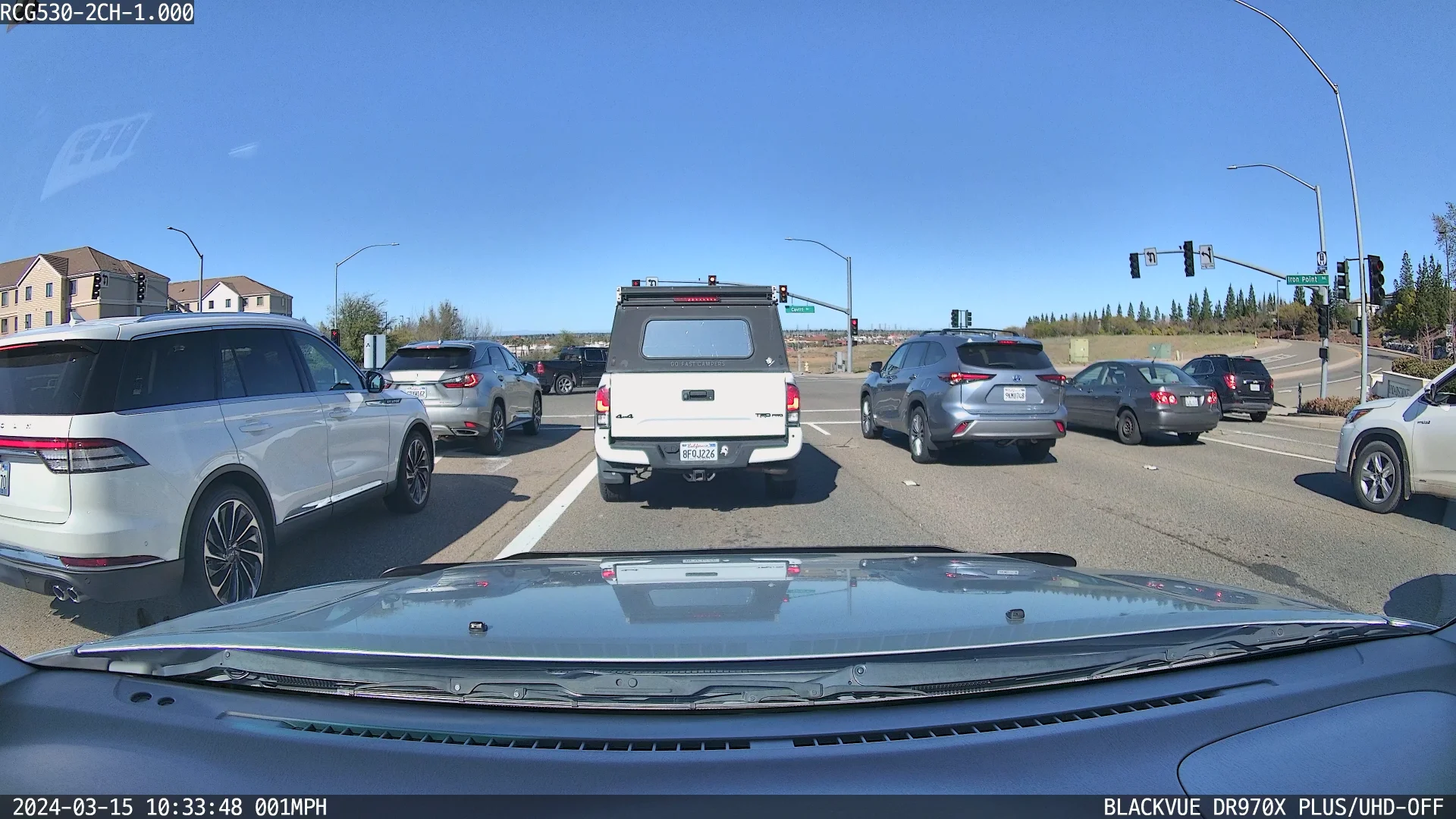

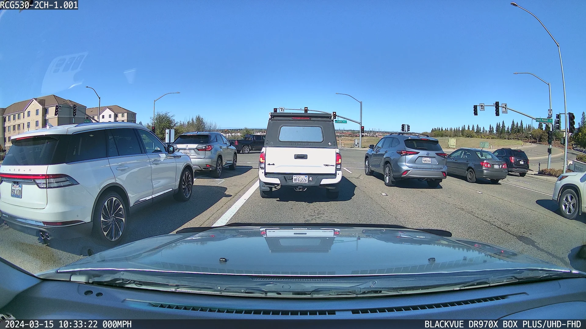

While my primary test vehicle is down for repairs, I have my backup test vehicle setup with three dash cameras. BlackVue DR970X BOX-2CH Plus, BlackVue DR970X Plus and a VIOFO A229 Plus. I didn't have my VIOFO A229 Pro front camera in this test vehicle, but the A229 Plus does a decent job as far a video quality and good focus quality.
I wanted to see how out of focus the third BlackVue DR970X Plus front camera is compared to the only DR970X Plus series front camera that I've received that has a good focus quality (DR970X BOX Plus front). I've uploaded the raw videos to my channel.
BlackVue DR970X BOX Plus UHD Front:
BlackVue DR970X Plus UHD Front:

Here's some frame grabs from when my primary test car with moderately out of focus DR970X Plus front camera (unit 3) in it comparing it to the other cameras. The Thinkware U3000 you see in the first frame grab was not powered due to a ongoing Thinkware iVolt Xtra BAB-95 battery pack failure investigation.
DR970X (non-plus) / DR970X LTE Plus (unit 2) / DR970X Plus (unit 3) / VIOFO A229 Pro - No CPL / 08-Mar-2024

I moved the DR970X Plus front camera (unit 2) to my second test car to compare it with the DR970X BOX Plus and a VIOFO A229 Plus front cameras on 15-Mar-2024.
DR970X BOX Plus / DR970X Plus (unit 3) / VIOFO A229 Plus - No CPL / 15-Mar-2024
