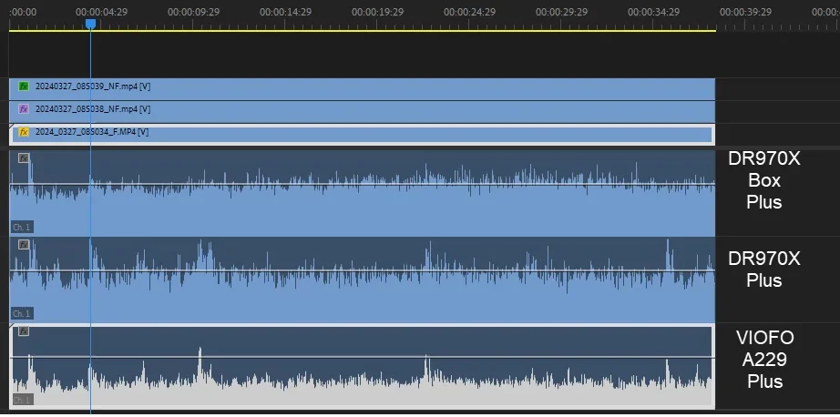

I reviewed my footage from my DR970X Box Plus dash camera with firmware v1.001 installed. I found the audio level of the record audio is outrageously high making the audio almost unusable. I have a video file that is from the 5-minute period between parking my vehicle and the dash camera entering parking mode. The microphone gain level seems to be set to an extremely high level. The “road noise” heard in the audio track makes it sound like I’m parked right next to the freeway, but the car is parked about ¼ mile from the freeway.

The audio recorded while driving is outrageously loud.

The DR970X Box Plus and the DR970X Plus both record audio level at a much louder level than the VIOFO A229 Plus (in this test). The Box Plus is the loudest and the Plus is the second loudest.
These are videos from a driving segment from this morning.
