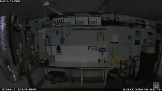

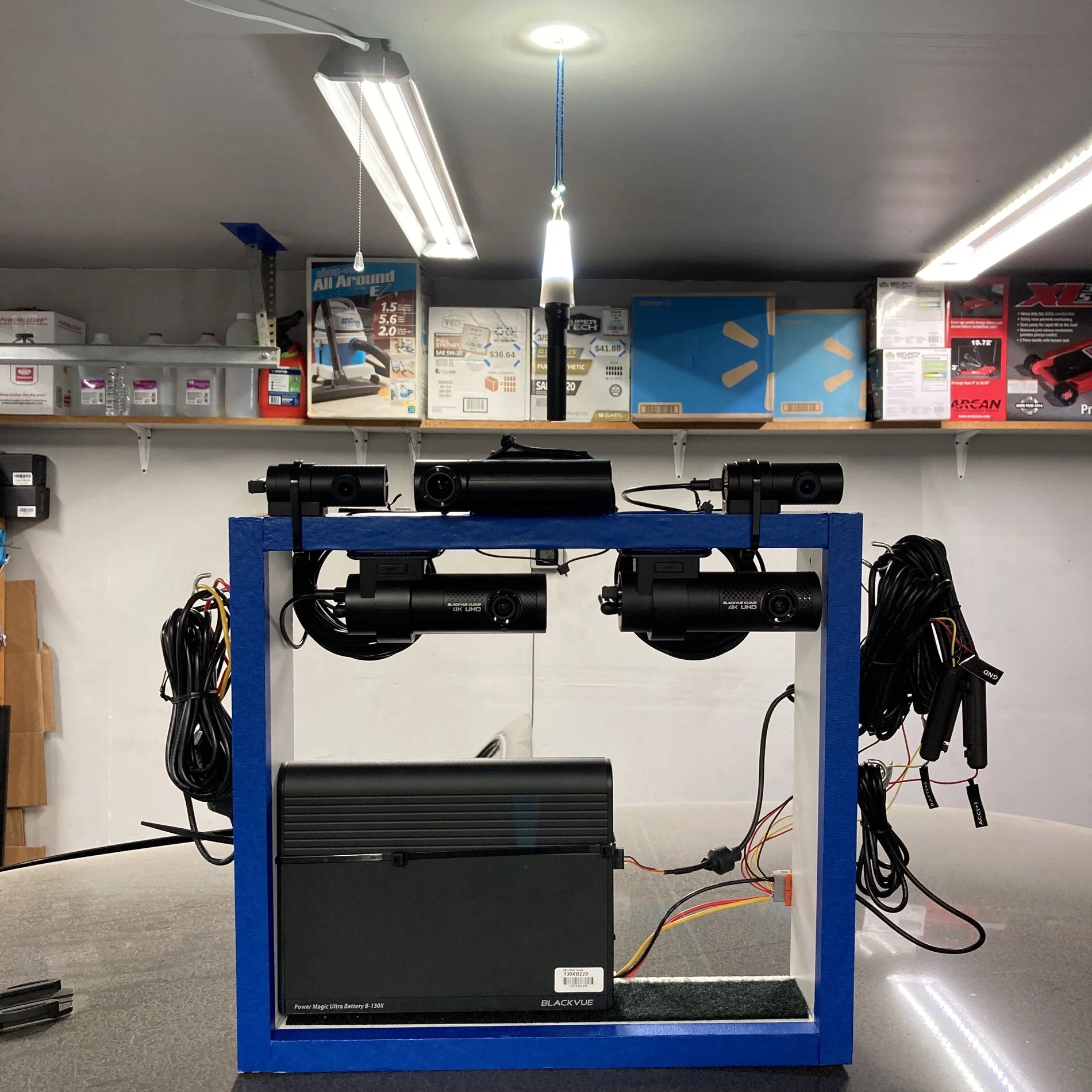

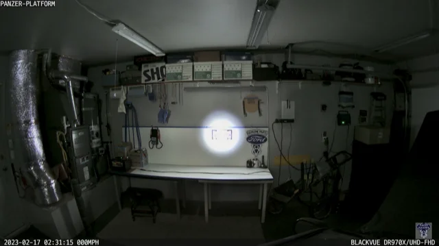

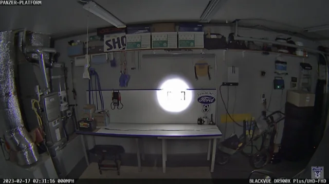

Welcome to my first in a series of posts comparing the image quality of the DR900X Plus-2CH vs. the DR970X-2CH, and the “wild card” A139 Pro (STARVIS 2 IMX678). I have all five camera mounted on a testing rig aimed forward as “equally” as possible. I placed the rig on the roof of my car in the center of my 20ft x 20ft garage. In this post I’ll be testing Low Light capabilities. I have four different brightness levels of light. The first light source is six 4ft LED shop lights mounted to the ceiling of my garage, they are cheap $20 Walmart (5000 Lumen & 5000K color temp). The second light source is an LED Flashlight with 3 brightness levels, (HIGH / MED / LOW) with a diffuser hanging from the ceiling just behind the rig in an attempt to evenly distribute light, (see attached photo). All five test videos were filmed simultaneously.
I start the test with the shop lights on, and the flashlight set to HIGH brightness.
Then I turn off the shop lights, leaving the flashlight illuminated on HIGH.
Then I switch the flashlight to MEDIUM.
Then I switch the flashlight to LOW.
Then I switch the flashlight OFF.
Then I turn the shop lights back on.
Of course this is not any kind of scientific experiment, and I don’t really know what this will accomplish, I’m just curious how the cameras will react, and what kind of low light “noise” I can produce to compare with. I’m more interested to get feedback from you guys, because after watching all these sample videos my eyes go full on Marty Feldman.
After reviewing all 5 videos with 4 different light levels there is one example that jumps out at me, and it’s the difference between the Rear Cameras of both BlackVue’s when the flashlight is on LOW setting. The 900X Plus appears to be much brighter, (see attached screenshots). The other, (and no surprise) is how much better the A139 Pro does than both BlackVue Front cameras.
In the next post I’m planning to perform an HDR License Plate Readability Test. That one should be neat.
-Chuck

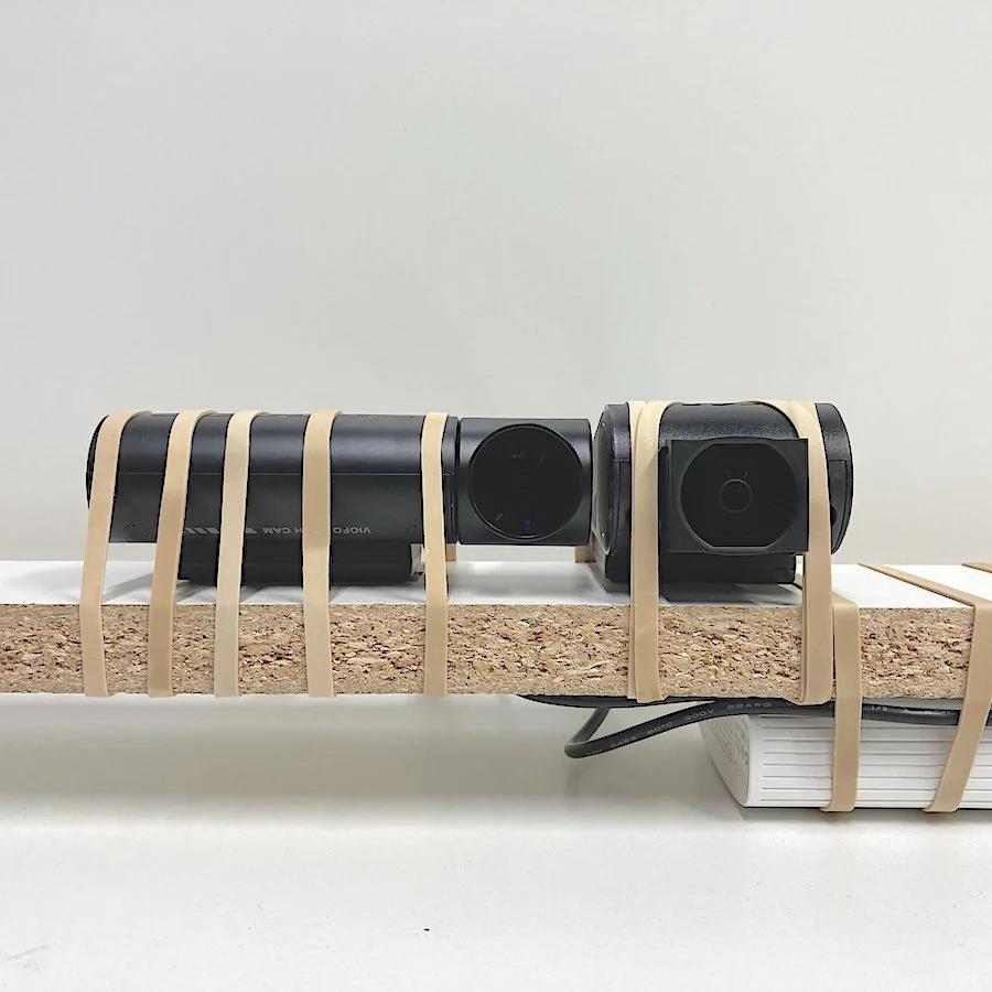

In this post I will attempt to compare the Dynamic Range of all 5 cameras trying to read a license plate. The primary light source is the same flashlight as before hanging from the ceiling on HIGH. The secondary light source is a Maglite ML300L flashlight on HIGH setting (approx. 600 Lumen). In order to get a tight beam pattern on the Maglite I made a “telescopic shroud” out of cardboard, (see attached photo).
I’m seeing an improvement of the new DR970X Front Cam over the DR900X Plus Front Cam. However the A139 Pro is better than the DR970X, (no surprise with the IMX678).
When it comes to both BlackVue Rear Cams I’m not seeing any difference when the flashlight illuminates the license plate. However the old DR900X Plus does a better job capturing everything else in the frame, (it looks much brighter). See attached screenshots.

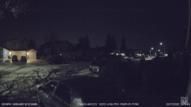

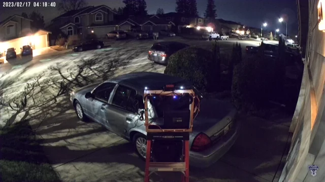

Here is another Low Light Test inspired by one of my home security camera POV’s, (I disabled the IR “night vison” and recoded a 1 minute clip for comparison).
The home security footage shows the test rig sitting on top of a 6ft ladder.
Under these lighting conditions both Front & Rear cams of the DR900X Plus look better than the DR970X.
Also the rear cam of the DR970X has strange artifacts around the illuminated porch lights, while the rear cam of the DR900X Plus looks almost as good as the A139 Pro.
However none of these dash cams look as good as the dedicated home security camera.

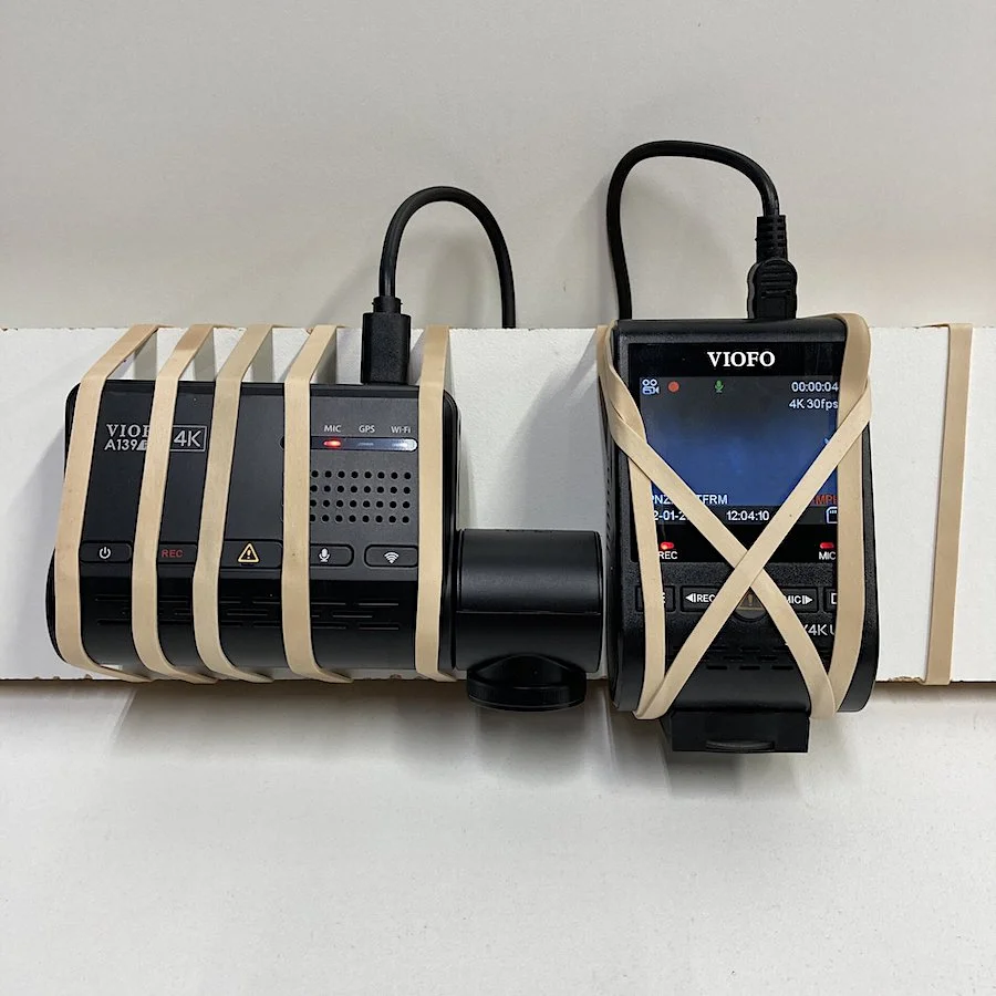

I hadn't seen this thread before but some guy is doing S&M Bondage photos of dash cams in a garage somewhere !! I've never seen anything like this before. Is this even legal? !!!:smuggrin:
I couldn't figure out how to mount the cameras without using the 3M adhesive, so I resorted to rubber play. lol

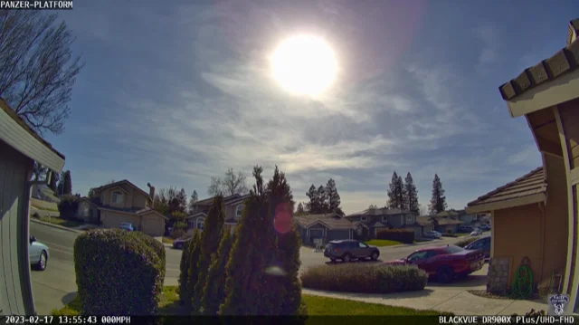

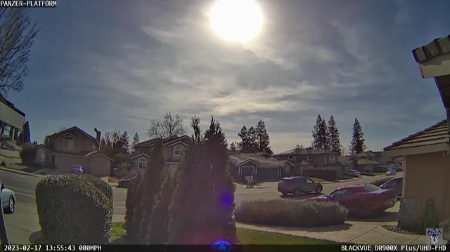

In this post I would like to simulate one of the worst lighting conditions I’ve experienced with a dash cam.
And that’s driving directly into the sun during sunrise, and sunset when the sun is at a “low angle”.
I tried to simulate this during the actual hours of sunrise & sunset but, weather conditions were not cooperating.
I was getting too much cloud cover during these times of the day, and it caused a diffused lighting situation, instead of the concentrated sunbeam I was after.
So I decided the next best thing was to film around 2PM, and tilt the testing rig to capture the sun in the high center portion of the image frame.
In an effort to keep testing conditions “baseline” no cameras have CPL Filters installed, (especially since BlackVue does not offer optional CPL’s for the rear cameras).
Also, I figured CPL Filters are for reducing “windshield glare” and since I have the testing rig out in the open not behind a windshield I would not use them for this test.
Another testing note worth mentioning is the first time I performed this test I had the A139 Pro HDR set to “On”.
I discovered setting HDR to “Off” provided the best image quality under these specific lighting conditions.
When comparing the Front BlackVue cameras the first thing I noticed was both lens flares appear to be in almost the same location in frame.
@Mtz should be proud of me for aligning both camera’s horizon line so evenly. Lol
The next thing I noticed is the DR970X Front is overall brighter and is providing more detail of the tree right in front of the camera, as well as the houses across the street.
The next thing I noticed is the DR970X Front is overexposing the sun & clouds.
Overall I think the DR970X looks better than the DR900X Plus.
Now let’s talk about the “What have you done for me lately A139 Pro?”.
It does a good job showing detail of the Sun, and clouds.
But everything else just looks terrible.
Believe me, I filmed a second & third video with HDR “On” and it looked worse.
Now let’s talk about the BlackVue Rear Cameras.
The DR900X Plus Rear looks OK, but it does look a little underexposed, (too dark).
I also do not see any fine detail of the tree right in front of the camera.
The houses across the street look OK, and I can make out the Ford Explorer driving by.
The DR970X Rear looks much brighter.
I’m seeing the fine detail in the tree right in front of the camera, the houses across the street look good, and the Ford Explorer driving by looks better.
However, the sun & clouds are completely overexposed, (way too bright).
Oh yeah the lens flare on both rear cameras are again almost in the same exact spot.
I would like to give myself another attaboy for getting the rear camera horizon line adjustment near identical to each other.
This is a joke, right?!
There is 80% sky for A139 Pro. One of the worst alignment i've ever seen on you.The comparasion is totally compromised.
