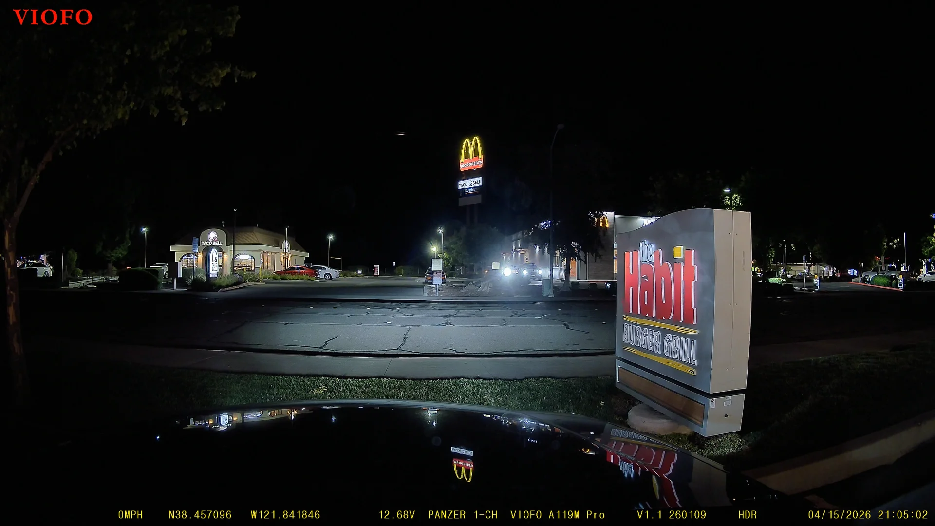

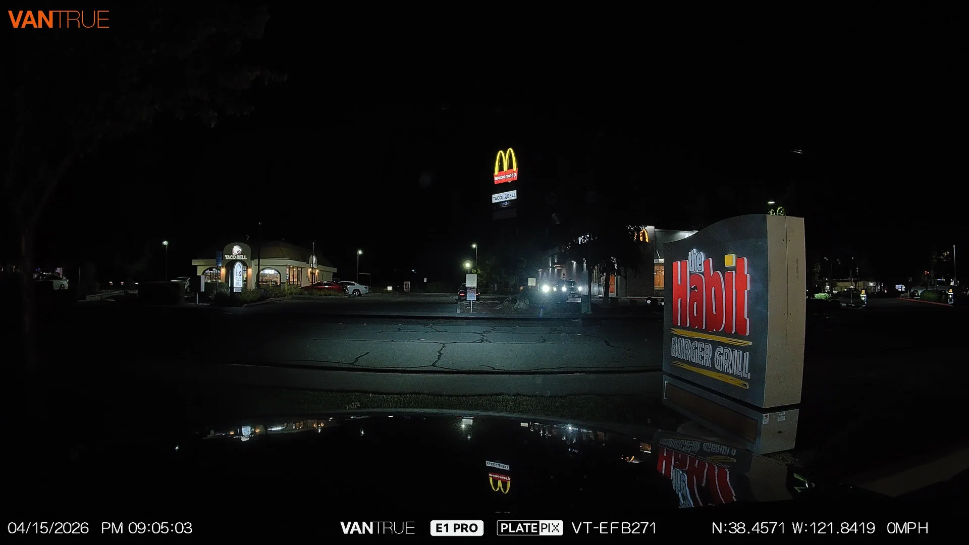

This is just plain nuts.
I can’t get over how dark E1 Pro is with PlatePix enabled.
What in the Wide World Of Sports is going on here?
It’s 2026, not 2016. lol
I don't think PlatePix was optimised for use with headlights turned off. I can't remember now whether PlatePix is automatically disabled in parking mode?

This was Driving / Normal recording mode, not parking mode.
Maybe we need yet another text stamp to identify which recording mode was used. lol
E1 Pro was released January 2025, (15 Months ago).
I was hoping we’d have fully finished "polished" firmware by now.
Oh, I knew that, but you didn't have your headlights on.
I was just thinking that 99% of night driving video would be with headlights on, and stationary night video without lights would normally be recorded in parking mode. Perhaps you could try the same location and turn off the ignition to see if low bitrate is any better than normal 4K at night?

We’re really sorry for the confusion here. PlatePix uses Vantrue’s in-house imaging algorithm to enhance license plate capture, especially for moving vehicles. To achieve this, the camera adjusts exposure settings, which can result in a darker overall image.
This feature is specifically optimized for capturing license plates in motion, so for static scenes, we recommend turning PlatePix off for better overall brightness.

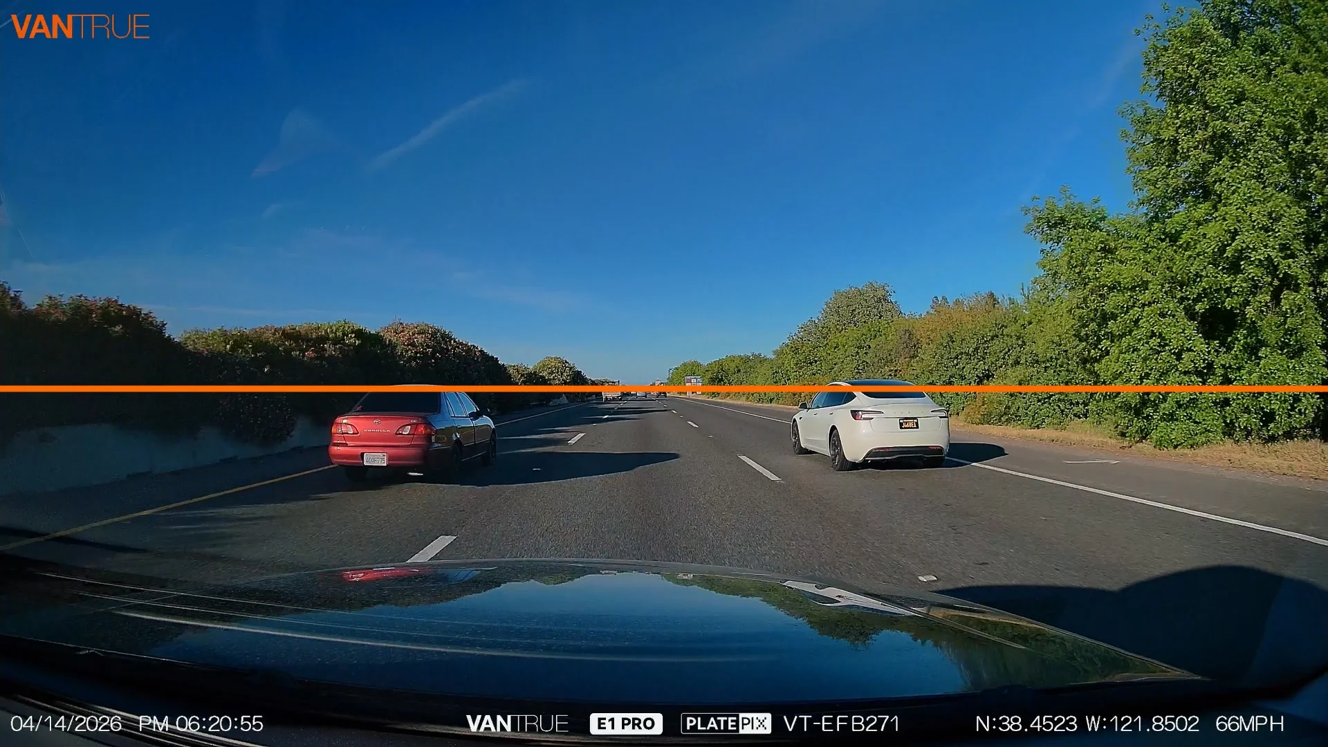

Well it looks like I screwed up again.
The Horizon Lines are not identical, and they’re around 51% Sky 49% Road.
Here’s the videos the screenshots were taken from.

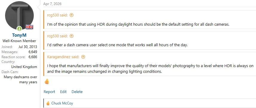

Personally, I don't agree that current dashcam hardware and firmware are suitable for HDR or IPC to be enabled all the time - there is too much daytime blur or ghosting for my liking. I still prefer to use an HDR timer on the A329S, S1-4K and similar models.
I do agree that most users are not interested in changing the settings throughout the year and it is desirable to find a 'set it and forget' setup that works all the time. The added complexity of separating HDR and PlatePix is confusing enough for seasoned testers, so I'm sure regular customers are confused too.

"Personally, I don't agree that current dashcam hardware and firmware are suitable for HDR or IPC to be enabled all the time - there is too much daytime blur or ghosting for my liking. I still prefer to use an HDR timer on the A329S, S1-4K and similar models."
Chuck said:
What?!? Why are you flip-flopping on me.
I only said that because you thumbed up Robert's post when he said it a few days ago. lol

I agreed with Robert's opinion that using HDR during daylight should be the default, and that we should be able to have one mode that works well at all times, but unfortunately I don't think we're there yet. I'm not willing to compromise performance for convenience, so I choose to use a timer and adjust the timer settings throughout the year. I was not intending to be contradictory - sorry it came across that way.
There was a time when HDR was optional on phone cameras, now it just seems to be always-on and the user doesn't have to think about it, or even get a choice.

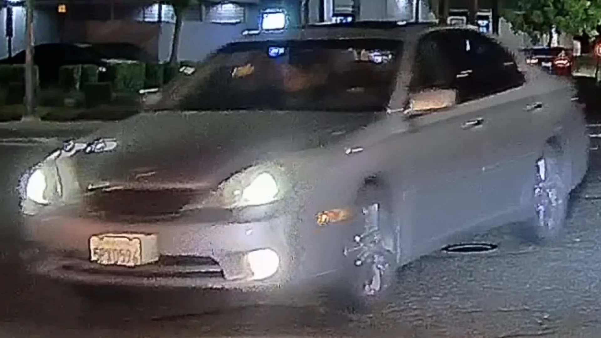

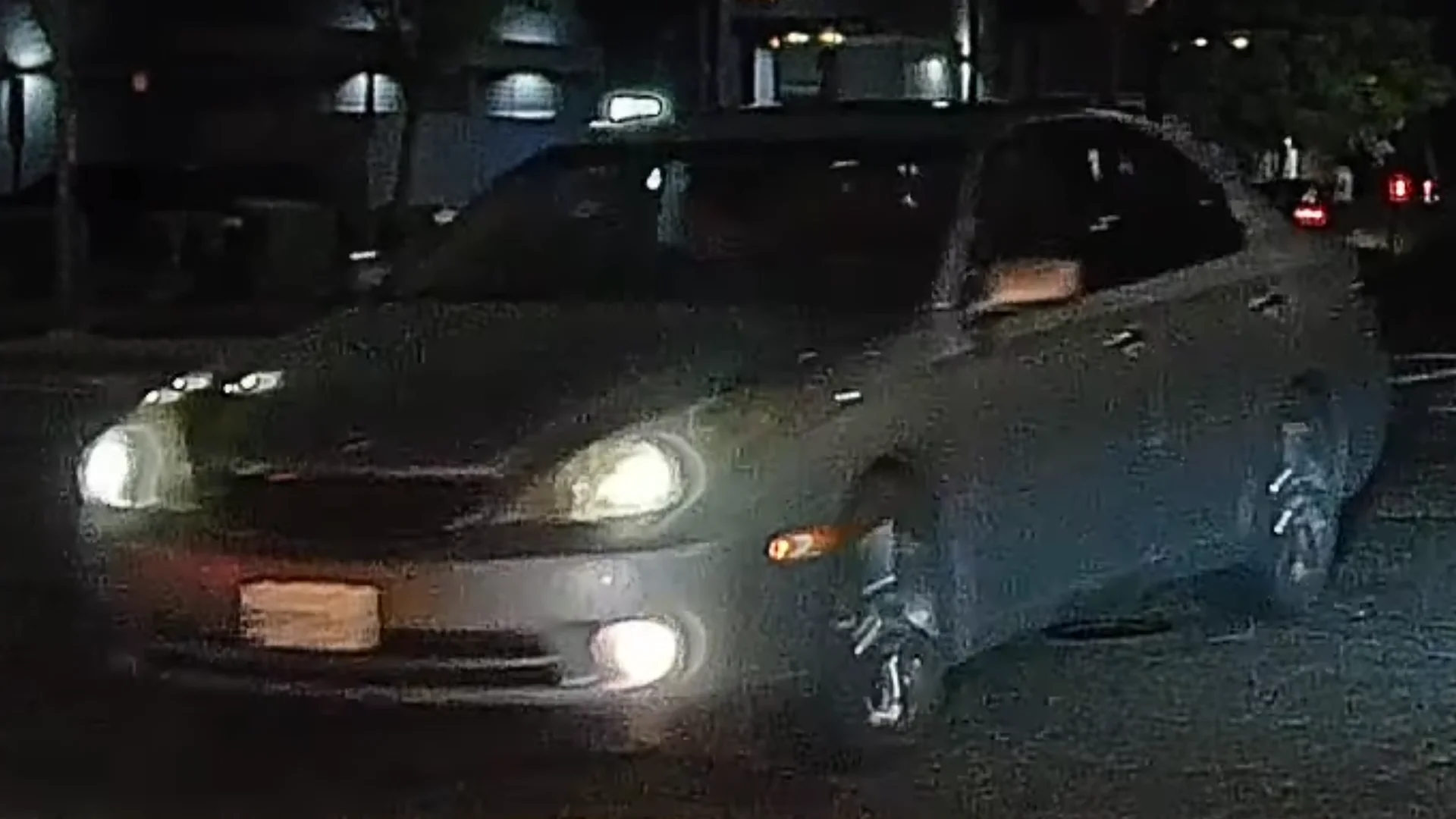

Round 1: FIGHT!
I was sure E1 Pro was going to win this round with PlatePix, but I may have found a limitation.
Not only does A119M Pro get the plate but, the entire frame of footage is much brighter.
California Plate# 5PXD596 2005 Lexus ES330
You can see the Lexus around 9:30:40PM in the videos.

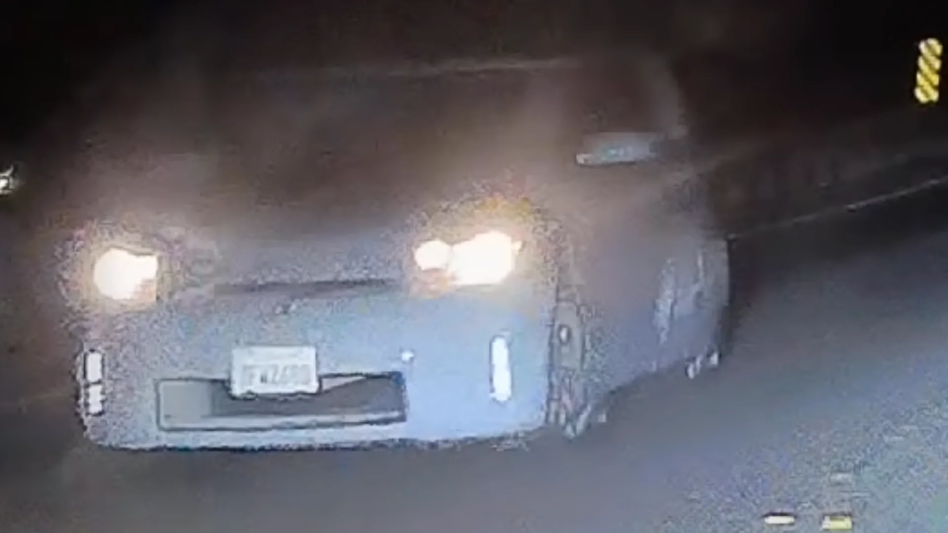

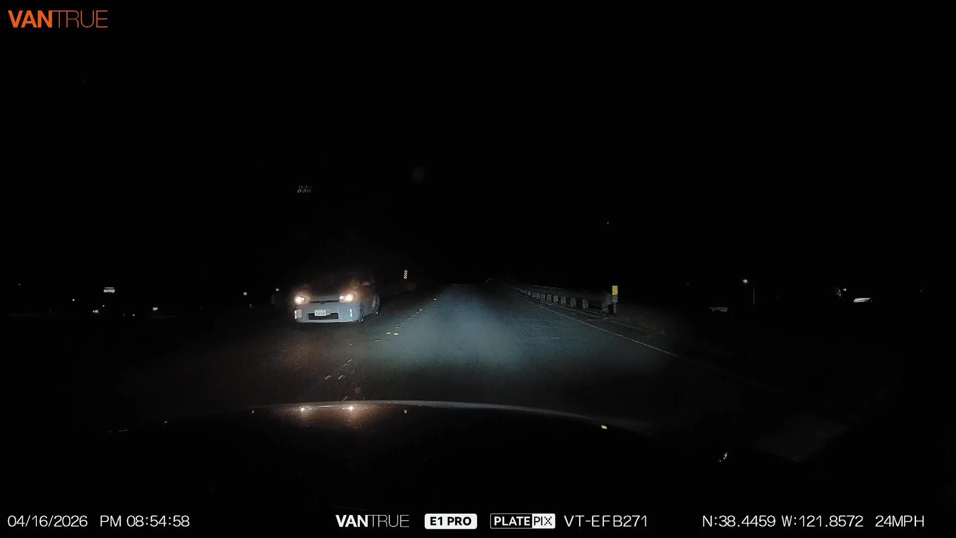

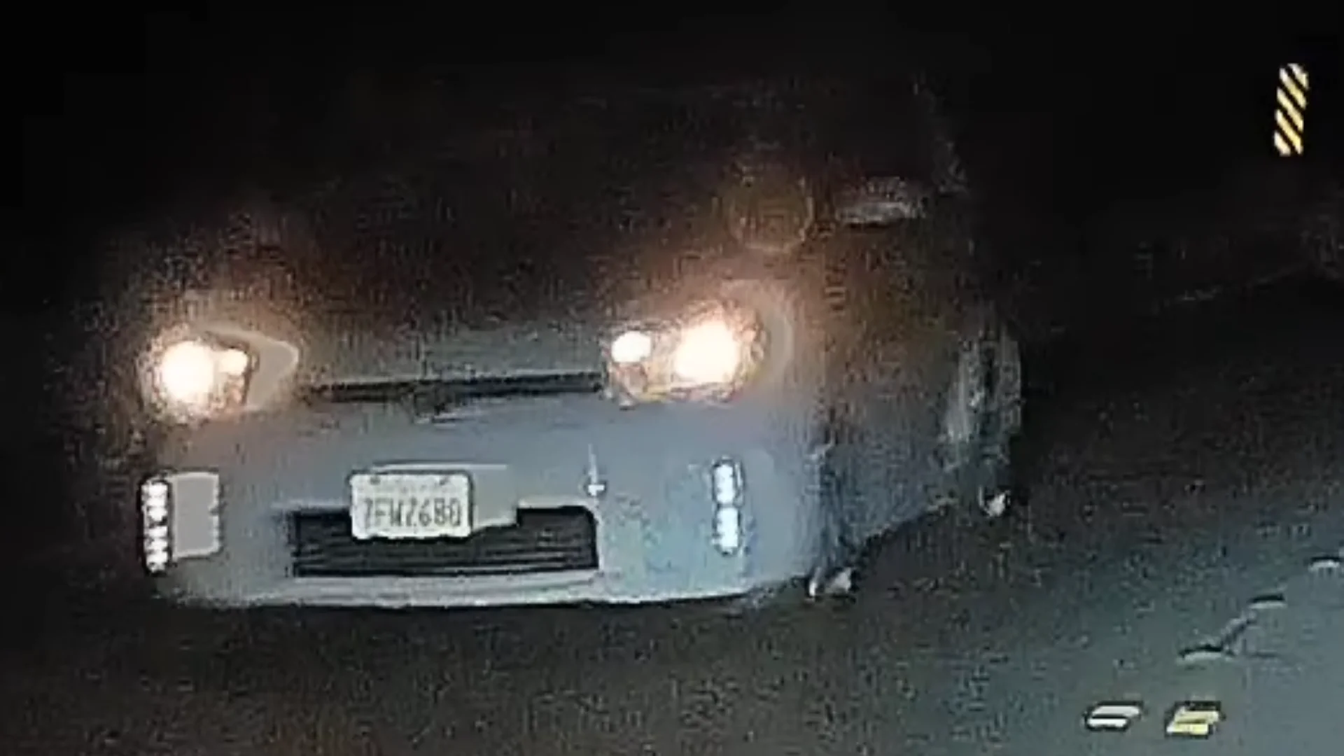

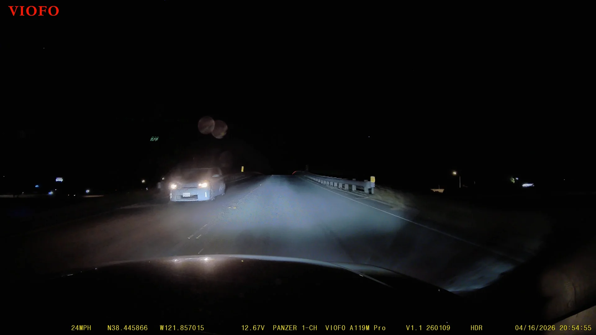

Round 2: FIGHT!
I finished looking through last nights test footage, and there was only one oncoming license plate capture opportunity.
All the rest I was following, so not very challenging.
I re-filmed new test footage tonight.
Nobody tell LateralNW I forgot to cover my radio, my digital clock appears as a reflection in the footage.
E1 Pro captures the plate.
A119M Pro does not.
California Plate# 7FWZ680 2014 Scion xB
Here’s the 1 Minute clips the screenshots were taken from.
