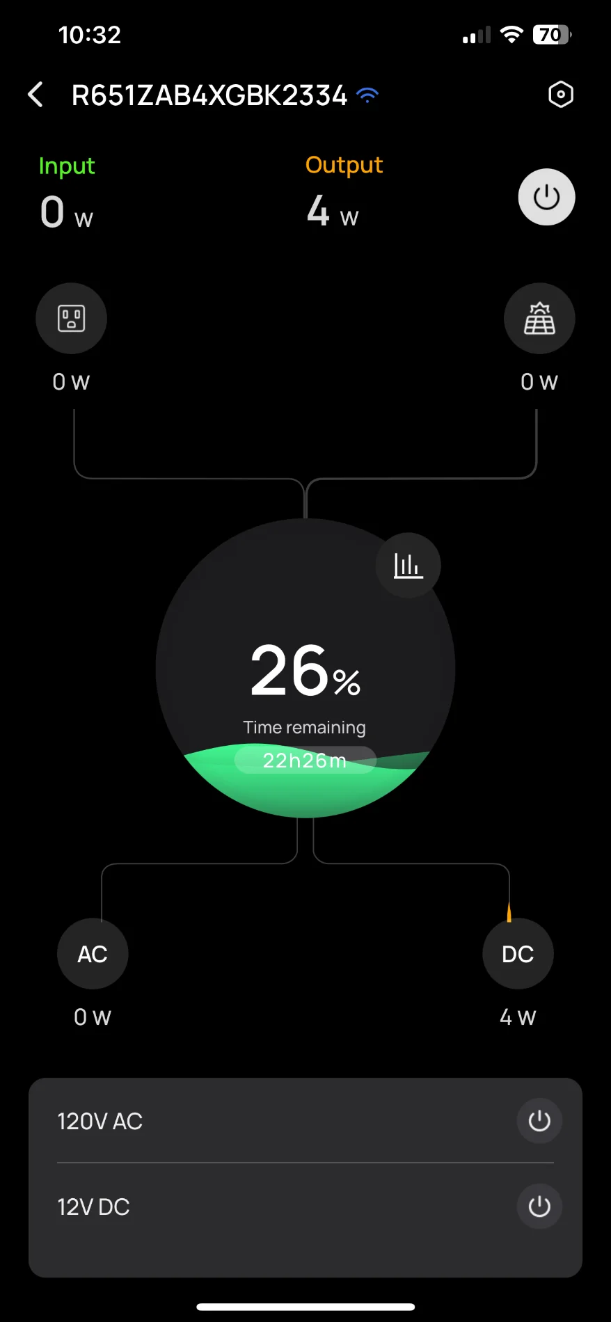

I actually decided to repeat my parking test to see what is going on.
My previous test with a USB-C to 12V cable lasted 46 hours, with the A229 Plus LBR draw averaging 3.85W (current measured with a clamp meter)
My River2 is now updated to a new firmware, and I'm using a USB-C to 15V cable (I can't find the old cable), everything else should be the same.
At the moment, my A229 Plus LBR draw is around 3.98W (0.265A current measured with the same clamp meter)
I don't think the A329, 2ch can be that much more efficient in LBR parking power draw compare to A229 Plus 2ch

I arrived at a average usable capacity of about 190 Wh based on:
- LBR parking time of about 46 h, depends on dashcam(s), wiring, settings, etc
- LBR parking power consumption of about 4.1 W on average, depends on dashcam(s), settings, etc
So 46 x 4.1 = 189 Wh
The rest of the 256 Wh capacity is eaten up by River2 self-discharge, 256 - 189 = 67Wh
The self discharge rate per hour would be then 67 / 46 = 1.46 W
These numbers are average, the real numbers depend on specific setup, settings, many parameters, some of which flactuate,
Will see what we get for my specific test setap at the end.

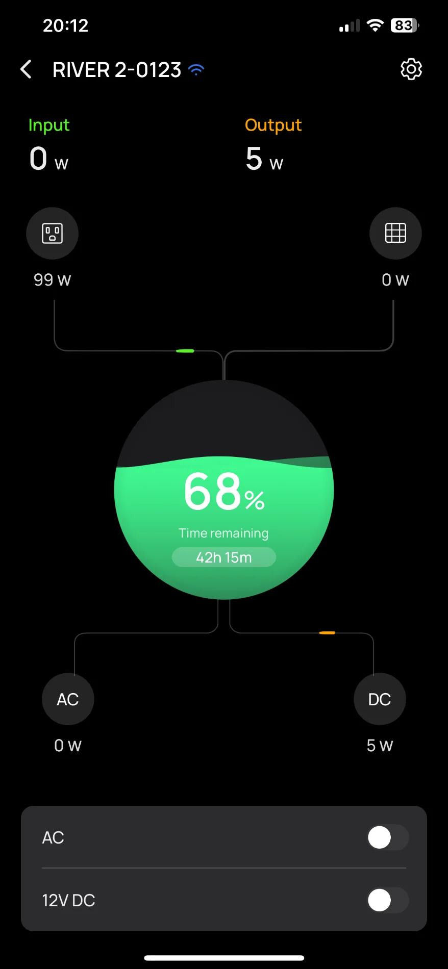

Here is a screenshot after exactly 24 hours of dash cam in LBT parking. (time is on upper left corner of the screenshot)
As you can see, there is 68% of capacity left, which is more than I expected!
The test is ongoing, I'll take the next screenshot when the time reaches 36 hours, and thanks to WiFi (love it), I can monitor and do it from work.

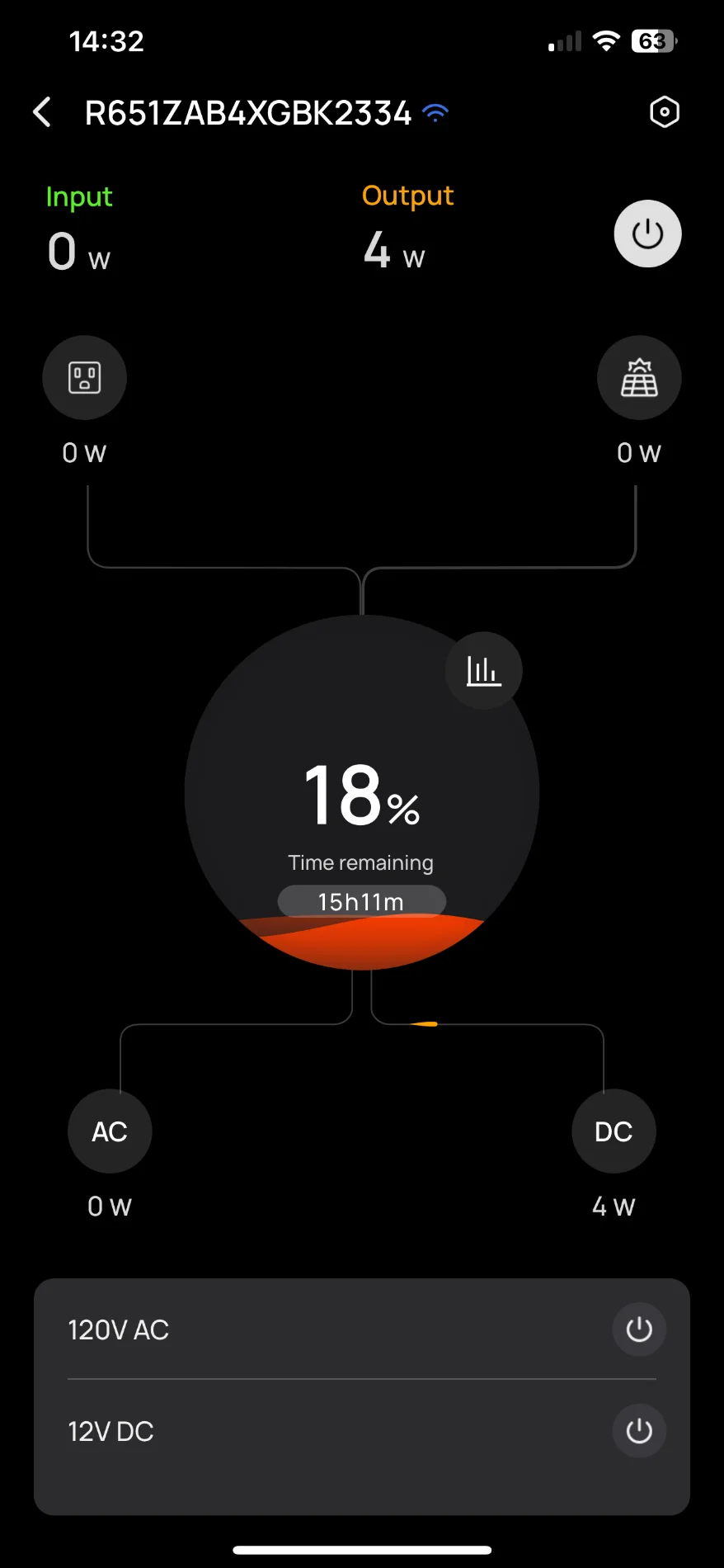

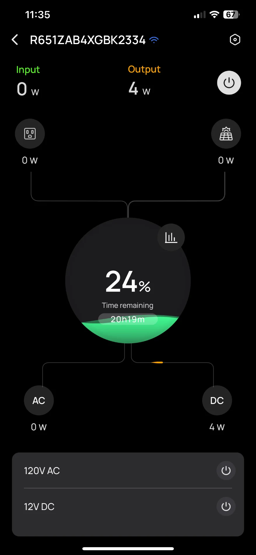

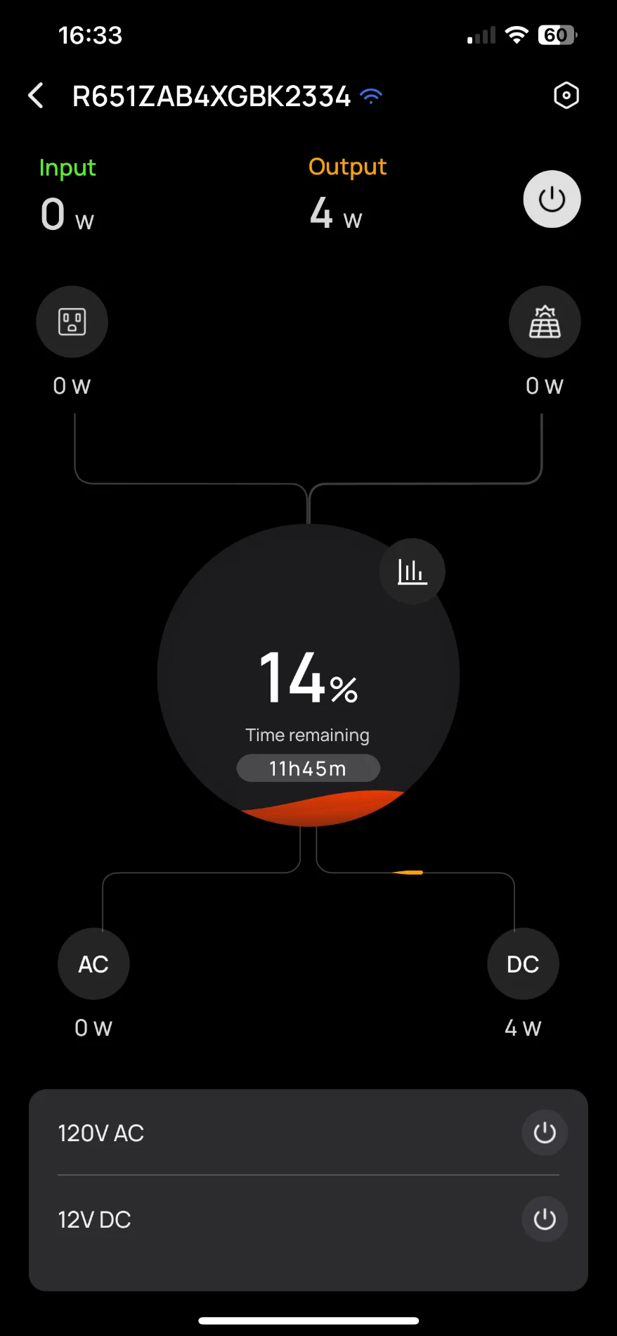

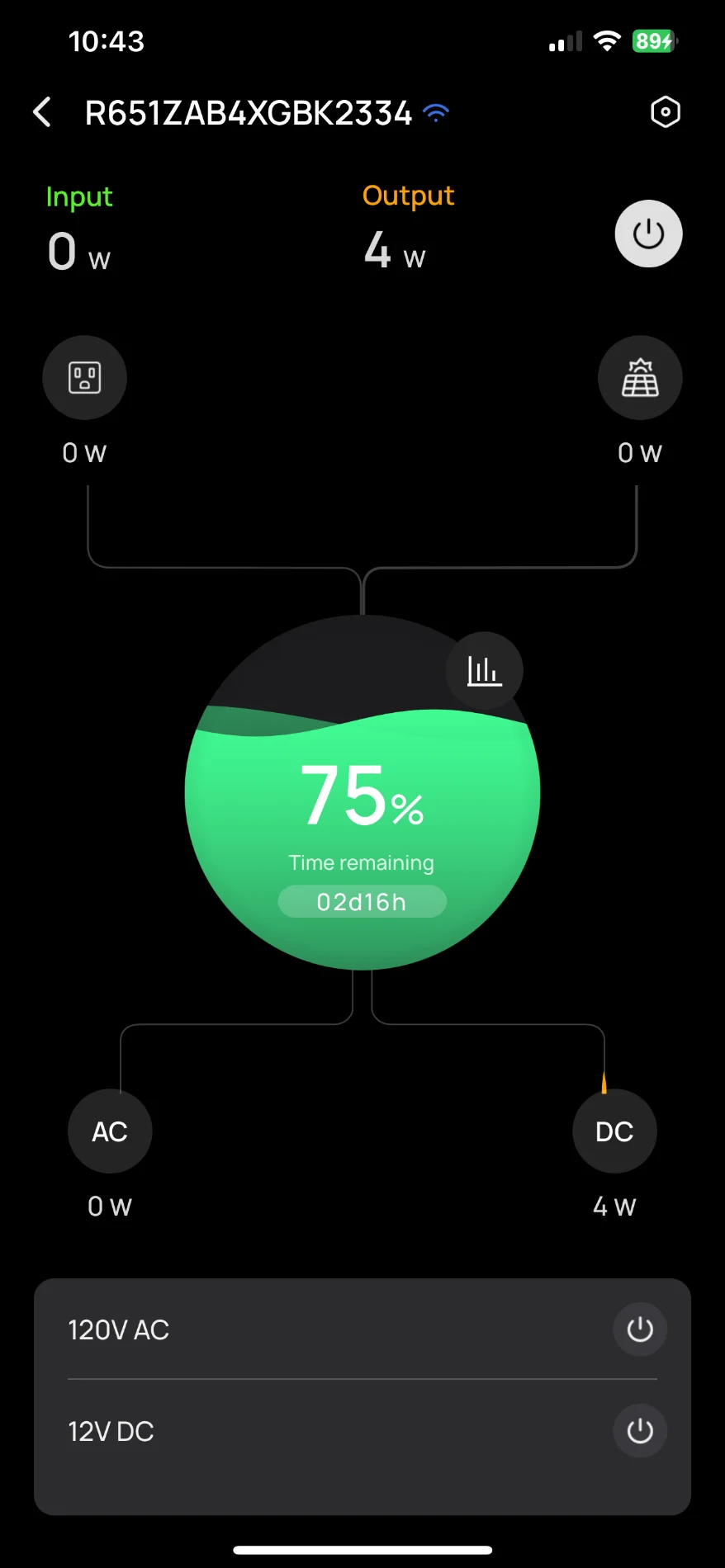

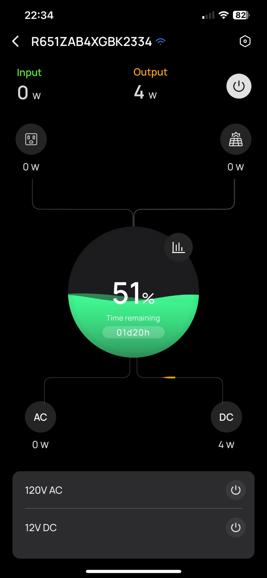

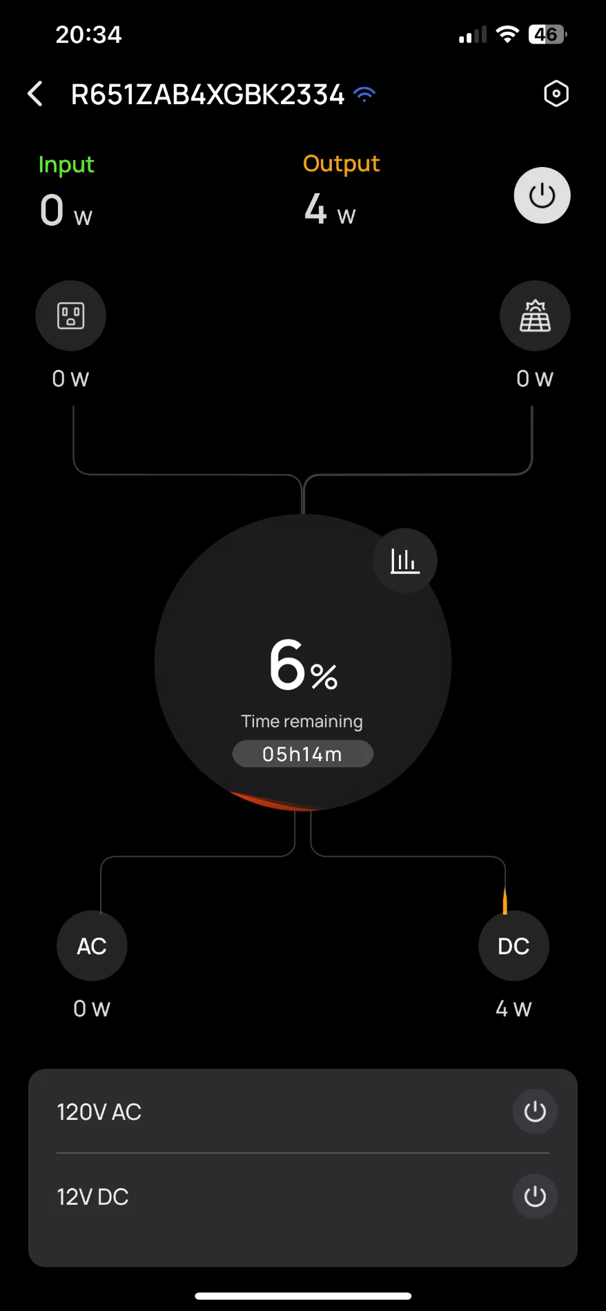

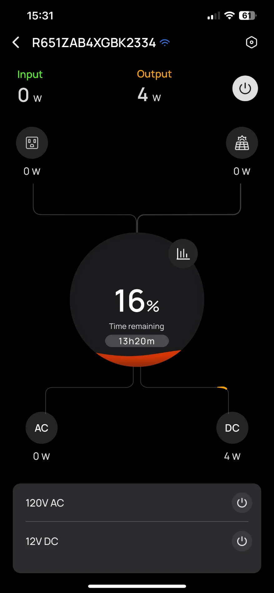

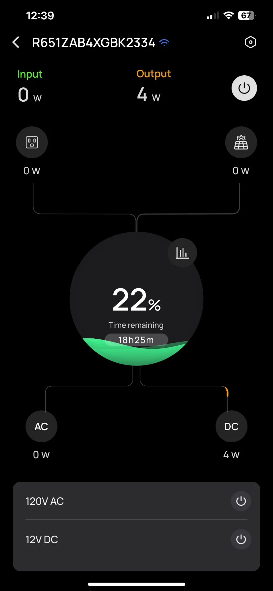

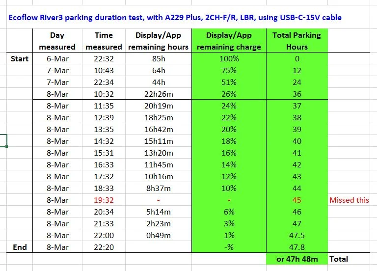

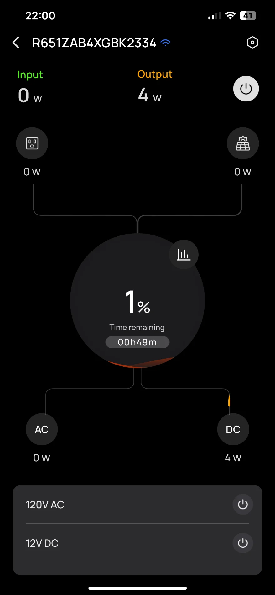

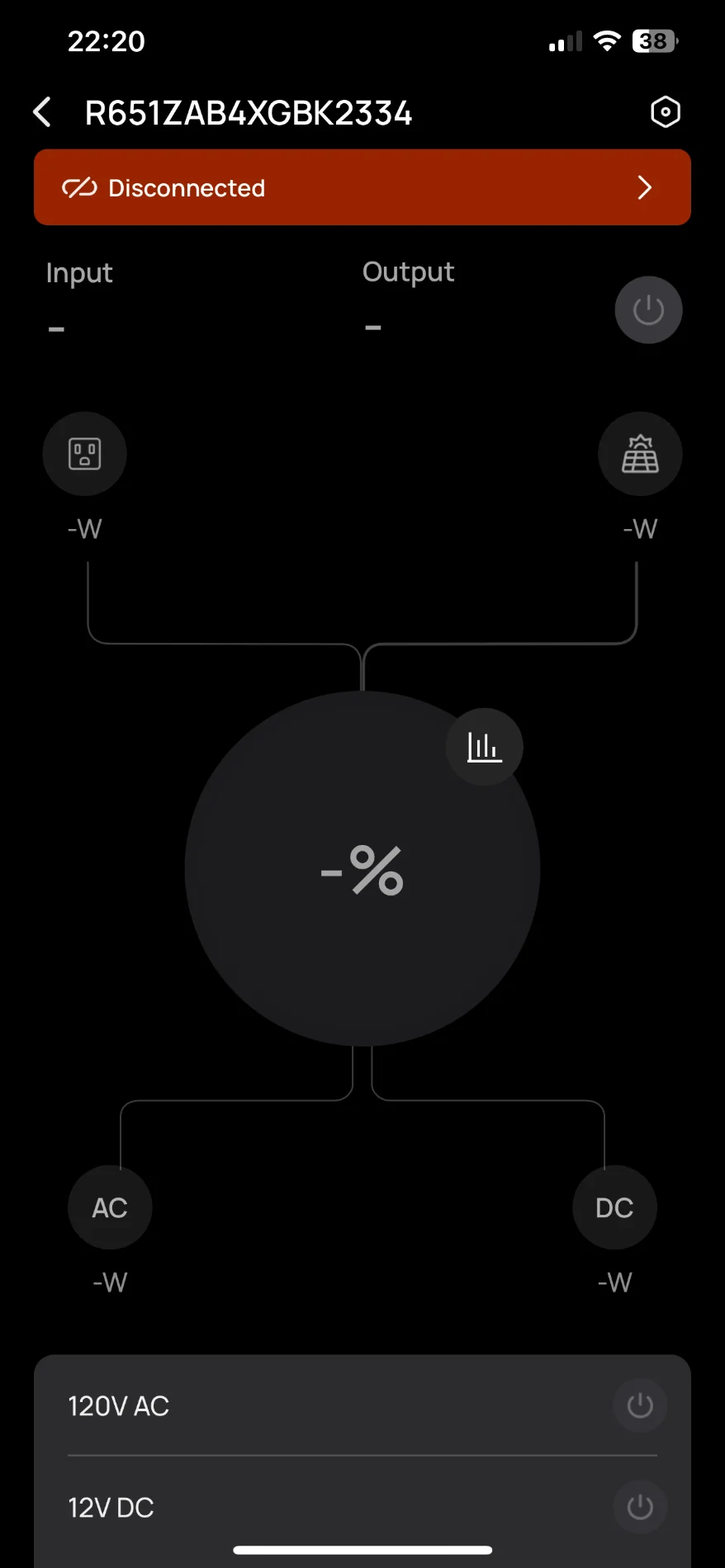

Completed the River3 parking duration test under exactly the same conditions as for the River2.
The Dashcam is A229 Plus (2ch, F/R), LBR parking mode, GPS is set to off for parking, a standard HK4 hardwire kit is used with a cut-off at 11.8V, powered via a USB-C-15V cable. (note that the HK4's 11.8V cutoff is irrelevant for this test, as the USB-C to 15V cable supplies around 15V at all times)
The average measured power consumption for the Dashcam + HK4 was about 3.9-4.0W without the USB-C-15V cable, with the USB-C-15V cable it is estimated to be 4.1-4.2W. (Assuming a 95% voltage conversion efficiency of the cable)
For this test I got the exact shutdown time of the River3 at 47.8 hour mark (47h and 48m).
This result is almost 2 hours better than 45.9h for the River2 !!
And this is despite the River3 being rated at 245Wh compared to 256Wh for the River2, meaning the River3 is more efficient !!
The average usable capacity is about 4.1W x 47.8h = 196Wh, or about 80% of the rated 245Wh.
The remaining 49Wh capacity is eaten up by River3 self-consumption or self-discharge.
The self-discharge rate per hour would be then 49Wh / 47.8h = 1.03W (compare to 1.46W for the R2)
The best part is that the App/displayed remaining charge percentage is pretty accurate !! (the remaining time isn't, but I don't use it anyway)
Also, once I started charging a completely dead River3, it took around 1.5 minute to start supplying power to the dash cam. (previous test was around 2 min)
Here is recorded data and screenshots: (as attachments are limited to 10 images - see next post for the rest of the images).

The rest of the images from the previous post are here:
The measurement time is indicated in the upper left corner of the image:
Note that the 45 hour mark is missing because I got distracted and missed it, I think it would have been 8%.
