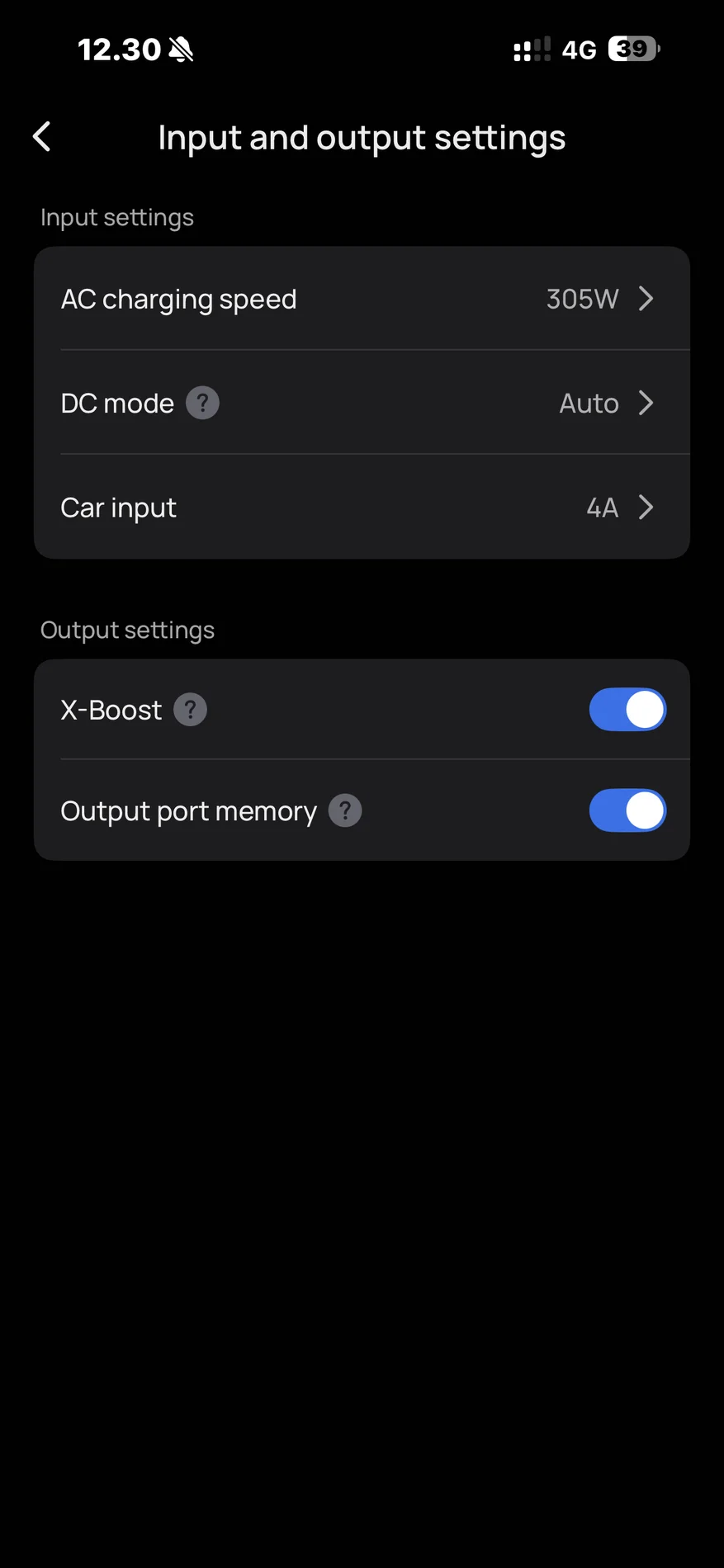

Sysio2000
Your setup and connections are as good as it gets!
All your settings are good, except:
- Disable the “Output Port memory”, it is not needed for the USB-C port and the USB-C to 15V cable, which activates automatically regardless of the “Port memory”.
The “Port memory” is only needed for 12V DC out if you want it to automatically activate.
This 12V DC out port is regulated and consumes noticeable power when turned ON.
I am not sure if the following will noticeably help with self-consumption, and I think most of these are disabled by default:
-Disable “Auto join” for WiFi
-Disable “Power outage reminder”
-Disable “Low battery reminder”
-Minimize “LCD screen timeout”
-Unbind WiFi in app, by “Change WiFi”

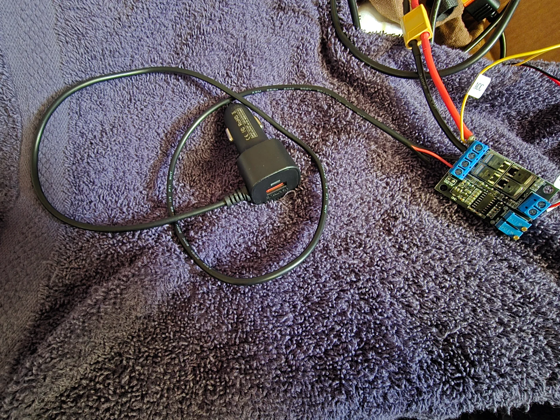

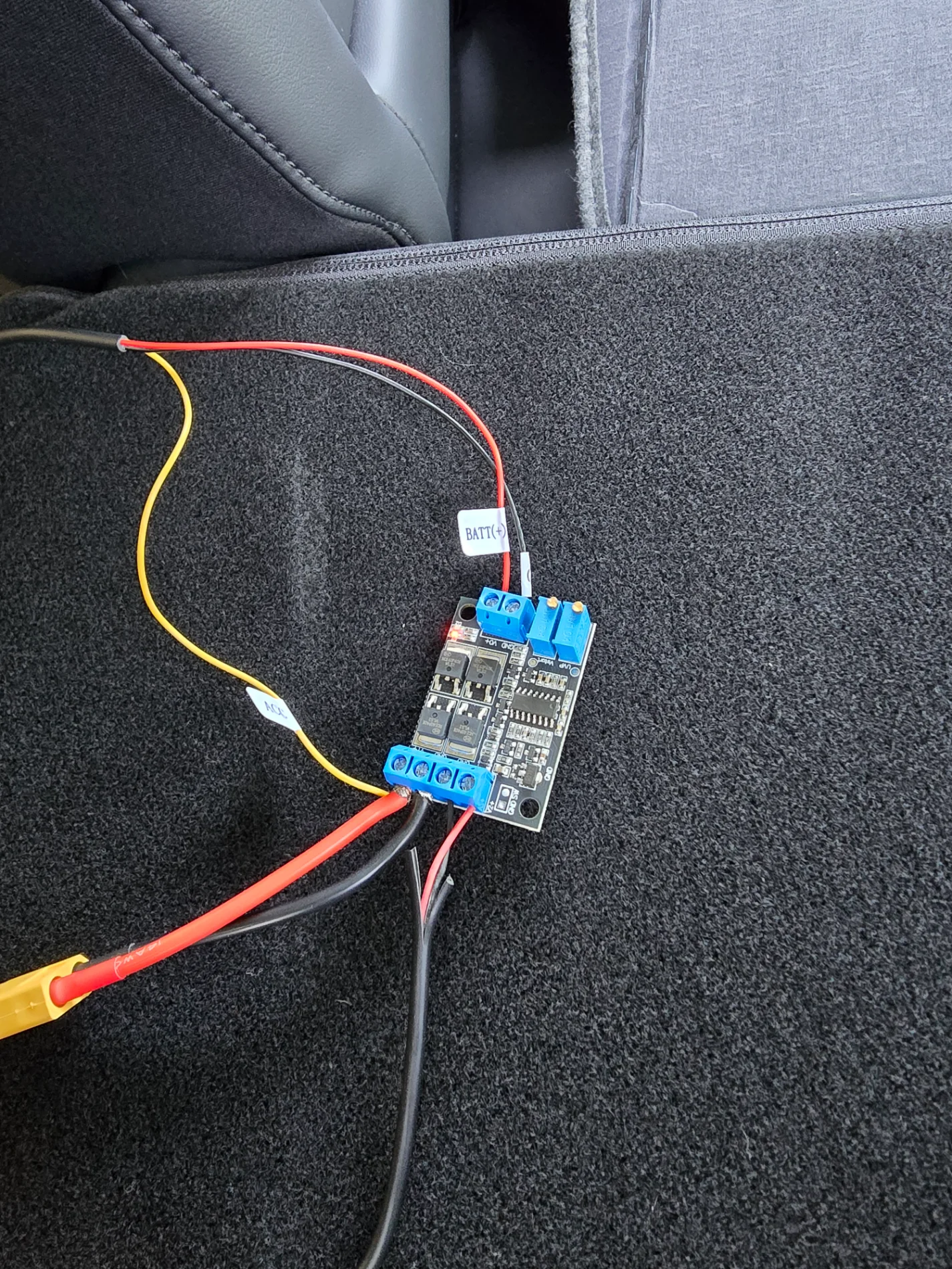

I'm having an issue with my setup. When power to the battery and ACC is cut (car is turned off), the dashcam loses all power. The light on the UPS switches from red to green but the battery fails to power the dashcam. I've tried with both the 12v car charger and USB C cable but neither works. I've even verified that all the ports have power. I think there may be an issue with my UPS wiring but I am not sure.

From what I see, your UPS wiring looks good to me.
- Does your Vantrue (which model?) work with River 3 Plus, switching between normal and parking modes (without using the UPS)?
I have already asked this question previously, but there was no answer - please let us know so we can properly troubleshoot.
In addition:
- Which USB-C cable are you using - the 12V or the 15V version?
- Could you please measure the actual input voltage from the USB-C cable, as well as the output voltage at the UPS terminals (with the ignition switched off and the green light on the UPS illuminated and the Venture connected)?
- What is your low-voltage protection cutoff value on the Vantrue hardwire kit?

Vantrue N4 Pro S
I used the time-out activation feature for the parking mode previously and that worked. It's a few minutes of no movement before it activates.
I am using the 12v car charging cable that came with the camera, which I was using previously to power it. The USB C end was damaged so I cut it out and am using the rest of the wire.
I don't have a multimeter right now but I'll be able to borrow one later on tomorrow.
The cutoff is set to 12/24v
Edit: Could it be that I need the 15v cable?

The timeout parking activation is completely different method of entering parking mode.
As you mentioned it is based on no-movement, for certain period of time to activate, it is simple, but considers to be not very reliable.
For this method you do not need ACC signal for parking
And we can integrate the UPS as well if you wish.
However, here we are discussing the most reliable method for activating parking mode, based on the ACC signal.

I am using the USB C to 12v car charger that came with the dashcam. The USB C end was damage so I thought I could try repurposing the wire. I cut off the USB C end and am using the car charging end wired into the UPS.
-12v end in the river 3+ DC port/ wires from that into the UPS
I will try the other 15v cable and hopefully that will solve my issues.

- Check the EDIT in my previous post.
- Measure the actual Voltage of that "car charger" - I suspect it is around 5V - If so it will not work
- Make sure the "Port Memory" is ON - in the River 3 Plus settings
(Only if "car charger" output is 12V. If output is indeed 5V - it is not needed, turn it Off, and use USB-C to 15V cable instead)

Port memory is on but that doesn't really matter since the output is 5V as you suspected. I won't be able to tinker with it over the weekend but I will order the new 15v wire and try again on Monday. When using the 15v wire, should I leave the cutoff at 12v or lower it to 11.6v?
Turn the "Port memory" Off - to minimize self-consumption.
The cutoff voltage is irrelevant here, as all settings will be below the 15V supplied via the USB-C cable.
Let's hope that the Vantrue N4 Pro S is able to switch between normal and parking modes without the use of a relay.

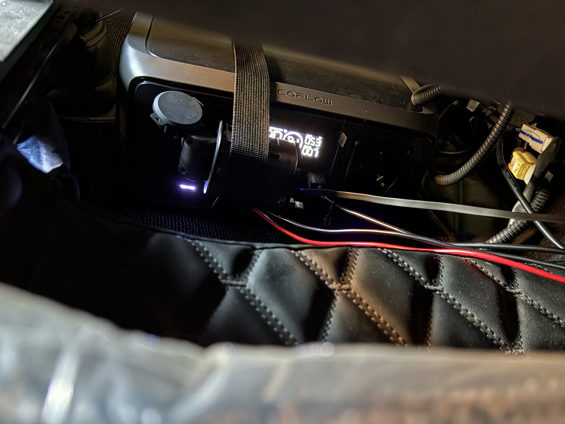

Hi All! I installed a 2-channel Viofo A229 Plus in our '23 RAV4 Hybrid XSE using the HK4 kit and Ecoflow River 3 Plus via Vortex Radar's video as a guide.
I purchased the 15V USB-C cable linked in his video and cut off the barrel end to connect to the HK4 kit. The yellow ACC wire I connected it to the positive wire of the cigarette plug end of the Ecoflow XT60 to cigarette plug charging cable. I set the voltage cutoff to 11.8V on the HK4.
The camera powers on normally when the car turns on and works perfect with the Ecoflow charging. However, when I power off the car, the camera turns to parking mode then shuts off after a minute or so. I'm not sure where to look at to resolve this as I was hoping to utilize parking mode with the Ecoflow. Any suggestions on how I should tackle this?
Thanks in advance!

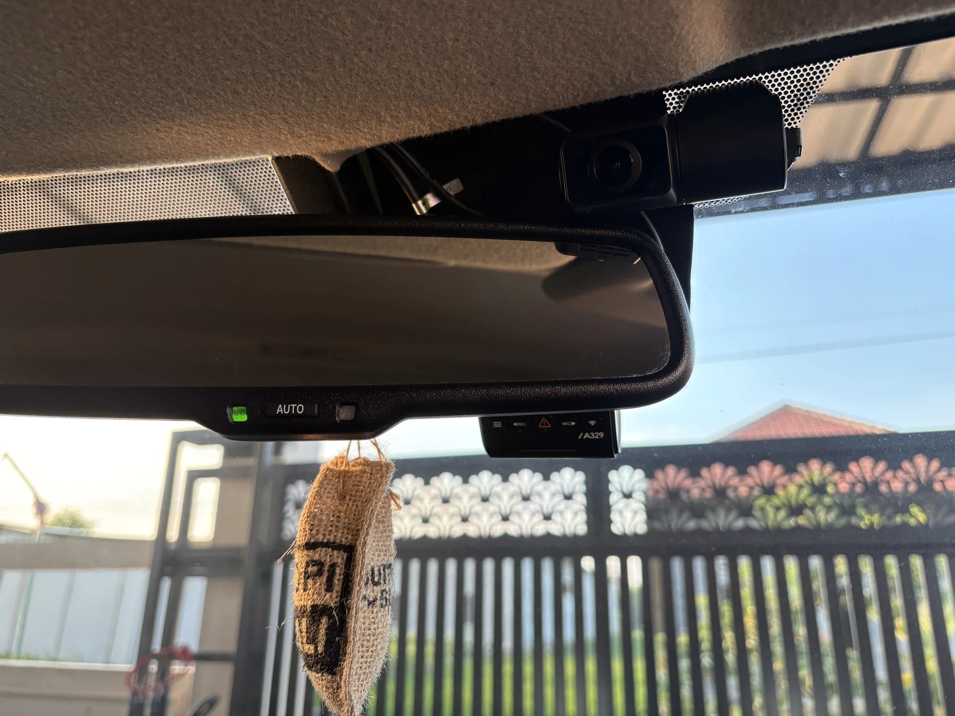

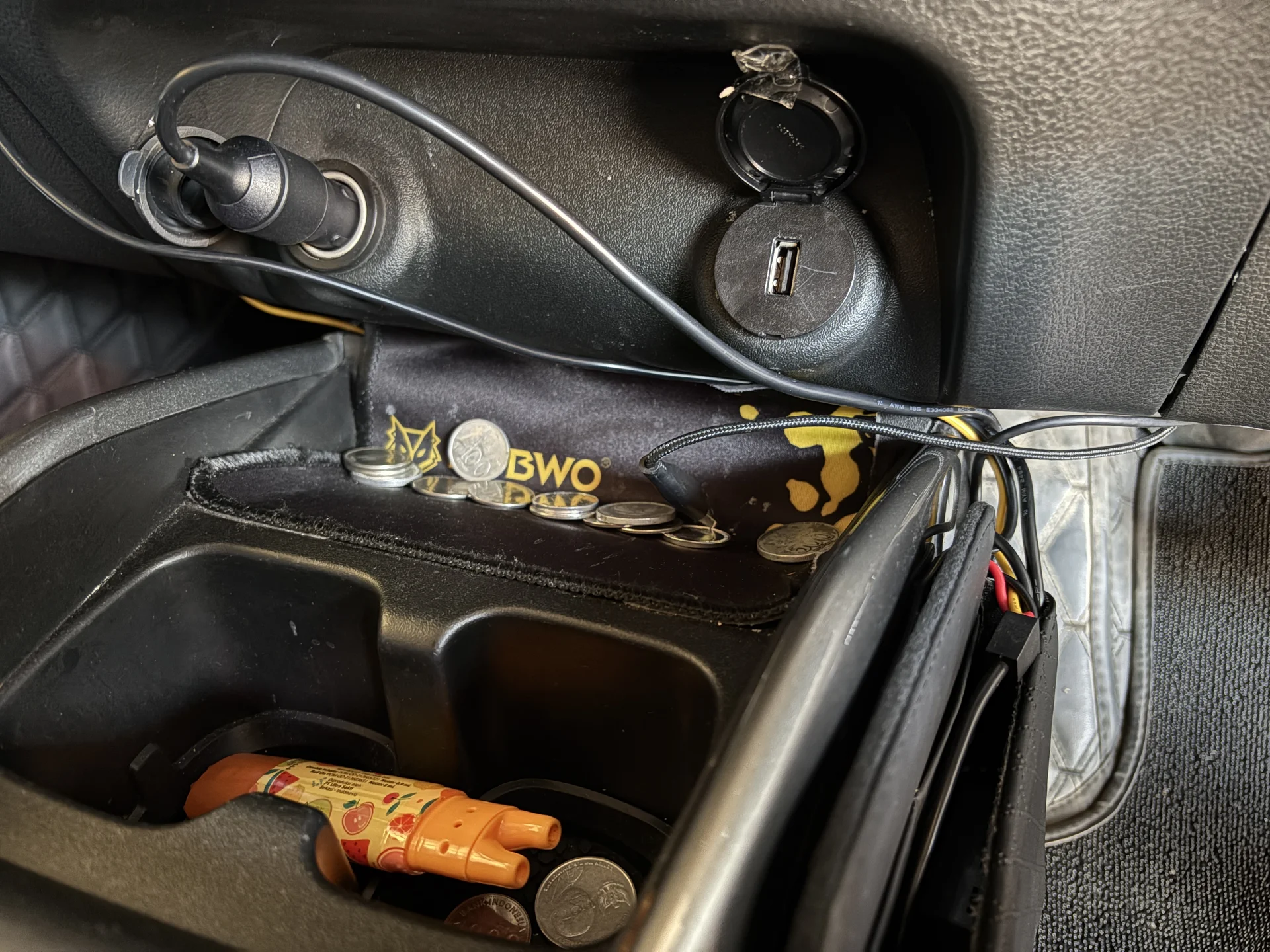

Thank you, thanks to this forum and the Vortex Radar video, I was able to use the River 3 as the power source for my car's dashcam and use it smoothly in parking mode.
- My first setup followed the Vortex Radar video, using a modified Type-C cable with the red and black HK4 cables and connecting the yellow cable to the car's ac fuse. Here, the dashcam turned on normally when the car was turned on, but the dashcam failed to enter parking mode when the car was turned off. It only turned on for a few seconds when entering parking mode and then turned off. After trying various other cable types, it still didn't work. It turned out the problem was with the River 3's power source.
- Finally, I tried the second method, which was to power the dashcam through the River 3's cigarette lighter port. I have a cigarette lighter at home, so I modified it by connecting the red and black cables to the cigarette lighter and then to the River 3's cigarette lighter connector, leaving the yellow cable on the car's ac fuse.
After trying it, it worked. The dashcam entered parking mode smoothly. The River 3's charger is powered through the car's cigarette lighter socket. What needs to be changed here is that the River 3 charger source is taken directly from the car's cigarette lighter socket. Coincidentally, when my car is in AC mode, the River 3 charges directly, so prolonged use in AC mode can cause the battery to drain. What needs to be adjusted is the input and output settings menu. Change the car input to 4A to keep the car battery safe.
