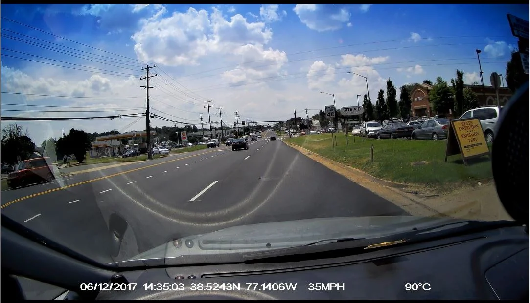

Today's heat test at 35C in shade and 65C on the sunny asphalt.
Car was of course parked in sun with the windshield facing direction of the sun so it could be extra warm.
Dashboard measured to 95C and and the body temperature of the 906 was 65C, before it was turned on.
Screen saver was set 15 second and full power on ac to keep myself cool (most important).
I was driving 15 minuted in the direction of the sun, so the cam could get most heat. After that opposite direction for 45 minute, but no shut down. Everything worked perfect.
Max internal temperature 90C.🙂

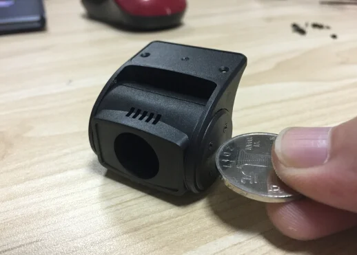

Hi guys, a small request, may I know the dimension of the most used coin there? diameter and thickness.
we may need to add a small slot on the rear cam then the users can easier adjust the facing direction with a coin cliping in.
like this:
in China it is D25*H1.9mm for 1yuan
like this:
The coin I normally use is D25 * H2.0 (2p), but I suggest D25 * H2.1, then other coins will also work OK.
Don't use a lot of coins any more though!
US quarter size is 24.26mm X 1.75mm.
Don't user them anymore. we got electronic meter now.
Thanks guys,
then it will be like this
The 2 screw holes in the picture above arnt they counter sunk in the wrong side ? i mean i think that surface pointing up are where the camera will contact what ever you install it on.
I think that grey thing in the cad drawing are there to illustrate the wire connection point
