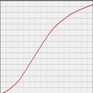

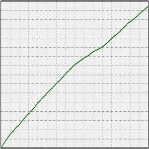

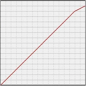

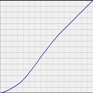

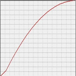

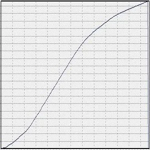

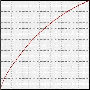

how much does your gamma curve setting differ from the default settings?
Also, some other parameters that work together with the curves are corrected...
About the number of experiments I will keep silent...)
And this is not all the curves...

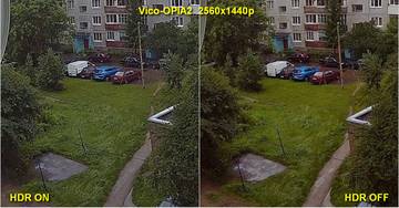

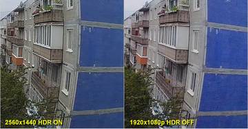

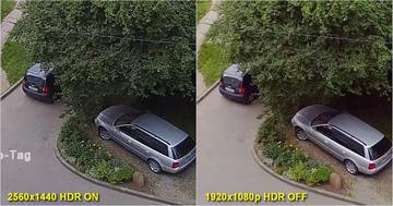

Comparison 2560x1440р HDR ON and 1920x1080p HDR OFF
A frame from 1080p is scaled to 1440p...
