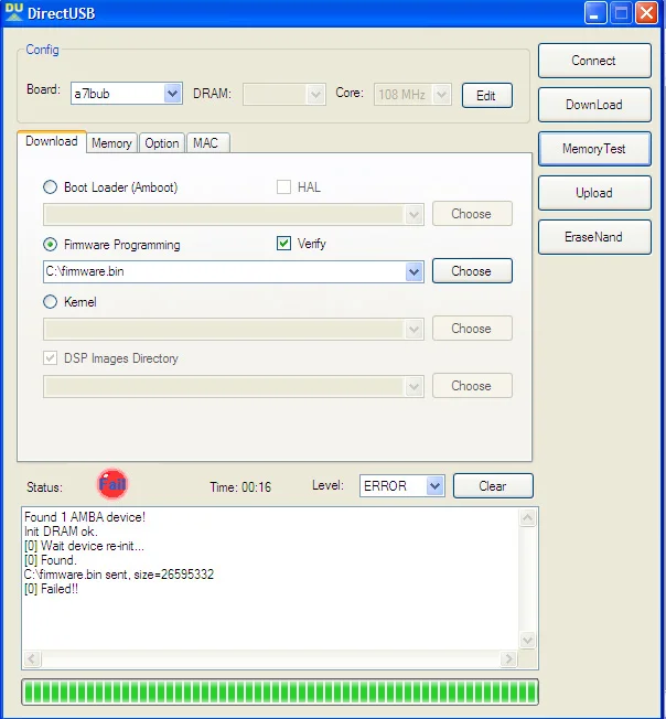

So. Now I tried all versions of boards in the DirectUSB, program version 2.2.19. Program does not find any AMBA devices. Any ideas?
Have you installed the ambarella evaluation board driver?
In general, at the moment I stuck at this:
The same result for all types a7l boardsπŸ™
That's the wrong file - you need the ELF file to use with DirectUSB which is somewhere in this thread, I'll try and dig it out.
But basically once it's connected you'd do Erase NAND to wipe it and then click Download which sends the ELF recovery file to the camera.
Is it definitely an A7LA30 G90?

One other discovery with these - ensure the camera is powered off, hold down the right button and plug in the USB cable to get the camera into DirectUSB / Ambarella dev board mode.
Maybe You know how to exit the dev mode, too? πŸ˜€ I now get black screen everytime I plug the camera in USB. Without attached USB cable it doesn't react to power button or others. Please Help.
if it has a reset button press that
Thanks. Didn't know the existence of such button. I think it's a compliment for such device. πŸ™‚
