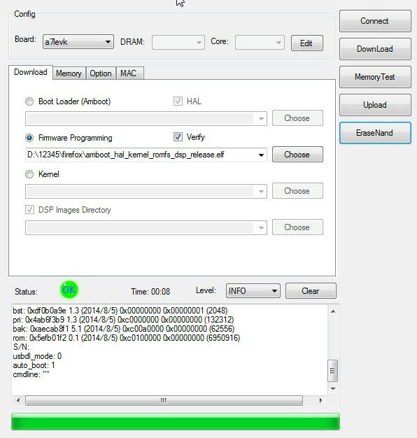

Unfortunatelly, does not work yet, the flashing success, but the parameter is missing too!
Do I have to erase the nand before upload?
There are some instructions here:
https://dashcamtalk.com/gs1000/#Firmware_Update_via_USB
They were for an older camera but the same principles and that does say to erase.
I did get the bit about upload wrong - it should be download like you were doing already - I'll edit the previous post.
Thinking about it redownload that .elf file just in case it's been overwritten and try that.
YESSSSSSS!
IT IS WORKING NOW!!!!!!!!!!!!!!!!!!!!!!!!!!!!!!!!!!!!!!!!!!!!!!!!
I thank you very very much reverend and jokiin the elf file and the great help instructions, from now you are my friend!!! ;-)))
Just for the future: G90 can go in USB BOOT mode by pressing LEFT and RIGHT arrow button simultaneously and connect to the PC USB.
The DirectUSB log:
Found 0 busses, 0 devices changed
bus=0, port=0
Dev#1: 0x4255 (AMBA) : 0x0001 (Ambarella USB generic class) : 123456789ABC has 1 configs
State is LOAD
Found 1 AMBA device!
AMBA_USB_EraseFlash: Enter[0].Wait...
AMBA_USB_EraseFlash Done[0]!!
bus=0, port=0
State is LOAD
D:\12345\firefox\amboot_hal_kernel_romfs_dsp_release.e2b sent, size=26102996
Wait firmware programming...
[0] Done!!
[0] Wait device re-init...
bus=0, port=0
State is LOAD
State is LOAD
[0] Found.
BST: success (2304)
BLD: success (132568)
HAL: success (62812)
PRI: success (6951172)
ROM: success (14668032)
DSP: success (4182272)
Error=0, data=0x0, str_len=0, str_addr=0x0
Firmware Programming Success!
@jokiin helped too mate with good advice - I'm just happy it's working as was feeling bad this might have bricked someone's camera!!
Great news though - now you can upgrade the camera to the latest versions with no worries about bricking your device - I've updated the notes on the first page to say absolutely make sure power is connected 😀
Mine goes into USB boot with just the right button held down mate, maybe it's just slight differences between versions but all good info thank-you 🙂
