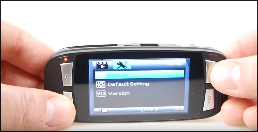

Getting some trouble out of my g1w's and Im hoping a firmware update will help
How do I determine which firmware I have? I assume it's in the menu?
I want to upgrade but just not going to hapen right now.
thanks
Select "Version" from the menu and press the "Rec" button.
