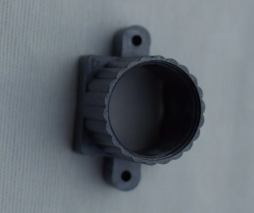

We are testing on some Sample, currently not all devices are worked with the New lens base.
If you want one sample, I can offer one to you.
If you could please @Fandy that would be fantastic - I'll drop you a PM.
I ordered a new metal M12 20mm base but it didn't fit as the G90 I have is an 18mm I think?
Today we receive it from our lens supplier, and we will do test by ourselves.
If you like, you can also help test and check.
Yes please Fandy, I've sent you a message to your inbox πŸ™‚
If you are looking for testers, I'll volunteer to try it on my g1w-c and my i1000. Shoot me a pm if you want me to give it a go.
πŸ™‚
Just realized I never put an update in this thread - the weather has cooled off here now but even after long journeys the focus doesn't shift with the new lens holder!

Is your new holder plastic or metal?
I'm considering trying a metal one.
I have noticed "focus shift" on my f70/i1000 and it was inexpensive enough that I don't mind hacking it up a bit as an experiment.
πŸ™‚
You'd need to check the pitch of the screws at the bottom as there are various sizes. The G90 is 18ish mm but the more common size is 20mm so you'd need to check which size you need first

The still image property for my G90 is showing a focal length of 5.0mm (not 2.8mm).
That's exactly how my G90 was in heat too.
The replacement with the fixed lens holder didn't last more than a week before dying which seeing as I paid for it I wasn't too happy about.
