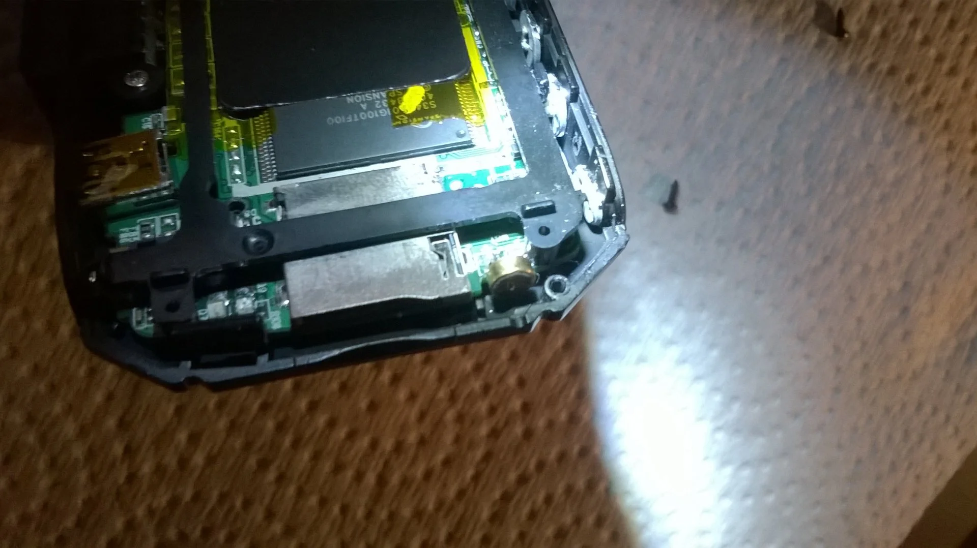

From http://blueskysea.en.alibaba.com/pr...Car_Dash_Camera_DVR_170_2_7_G_sensor_G90.html ...
My ( note the USB/HDMI ports and of course, the microphone ) ...
The felts on the frame are mine.
