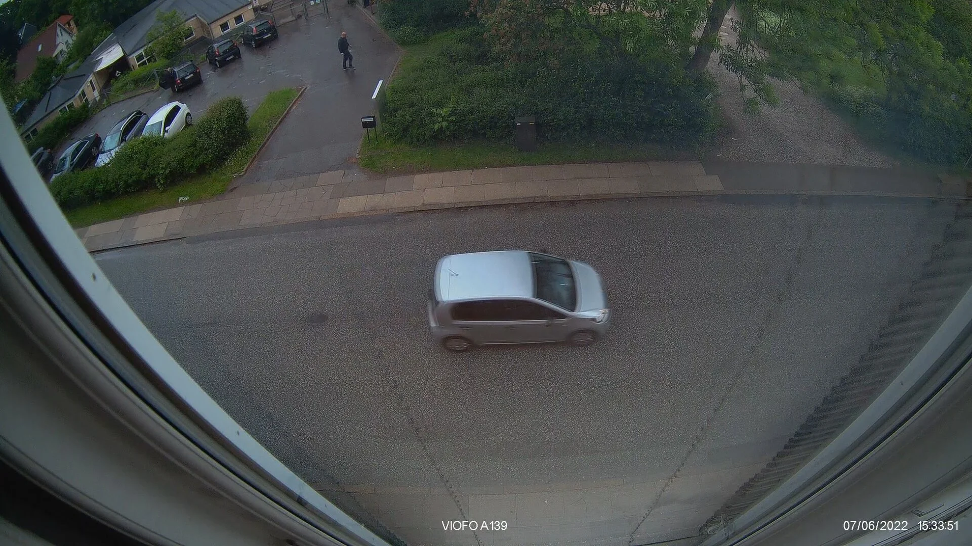

Okay i have just remembered i had a camera going
In the very first video i have this little grey car passing by down below, note the dual antenna on the roof, the car like most only have 1 antenna.

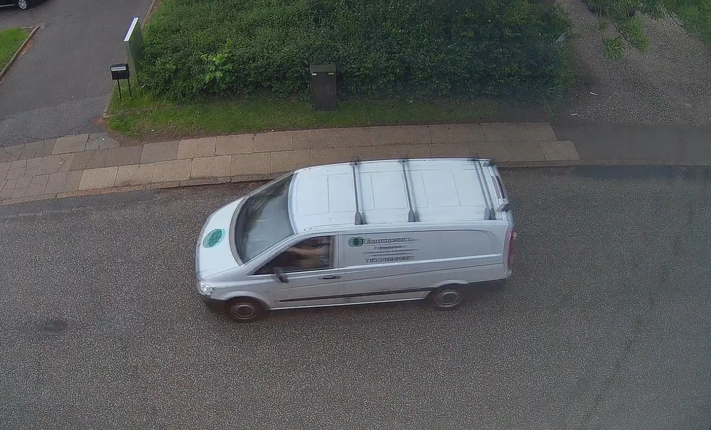

A white van a little later.
HDR mainly helps to avoid car number over exposed for the night, but the ghost image in the daytime is a common issue.

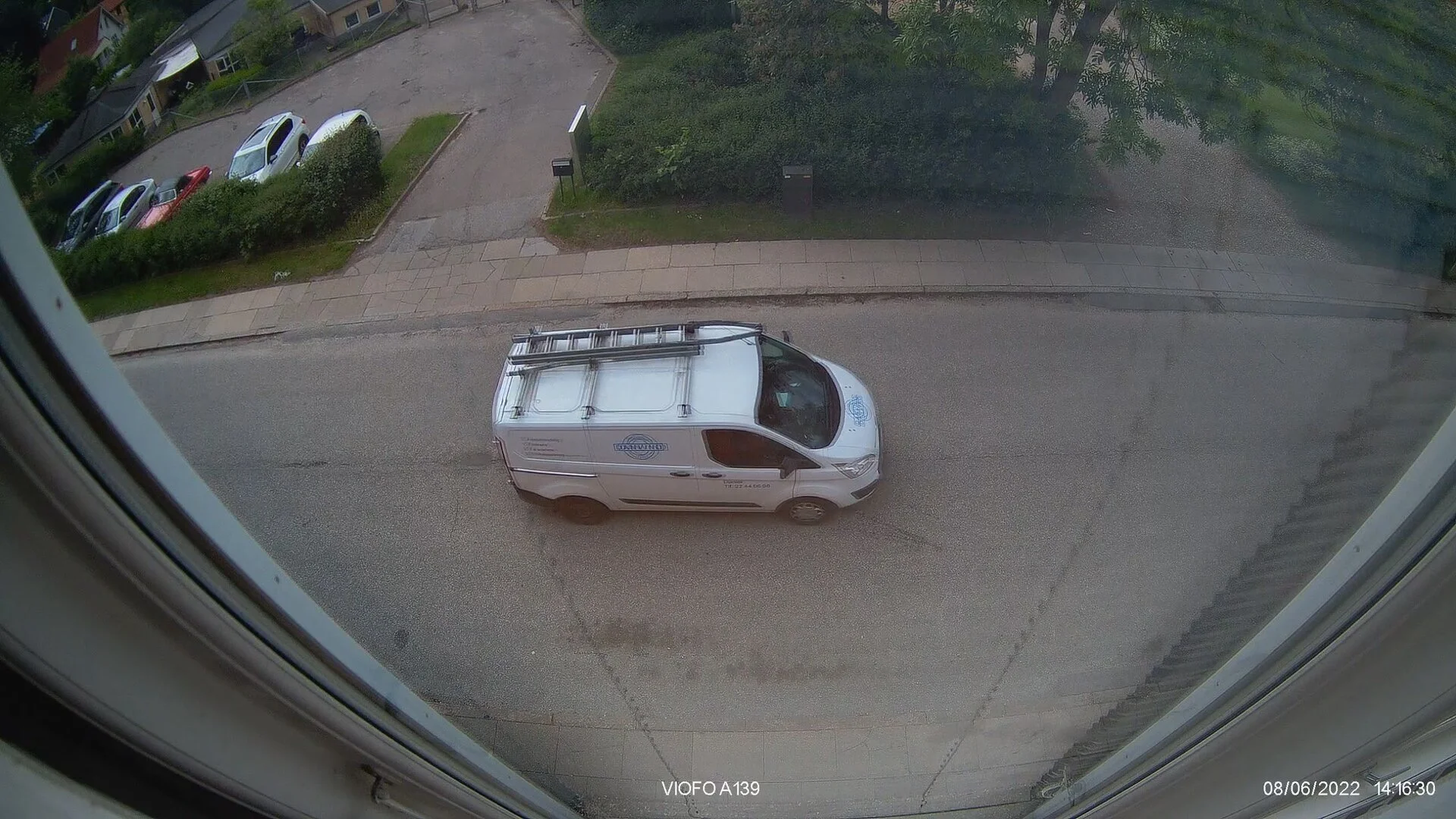

In your images, and ipollen's images, there are clearly two exposures for each frame, and they are both short exposures. HDR On should have 1 short exposure and 1 long exposure, so something is not working sensibly!
