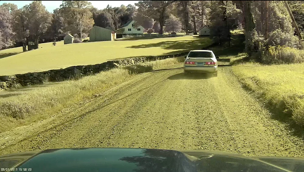

That lens should provide you with similar results to the 2.8-12mm ƒ 1.4 zoom lens I've been experimenting with. In this example it was set to the max 12mm zoom. The longer lens has proved excellent at capturing plate numbers and other details of oncoming vehicles and this effect is sometimes enhanced by the IR effect as it tends to bring out contrasts and details depending on the colors the camera is seeing, especially on the plates.
This example is interesting as the recently graded gravel/dirt road is causing a lot of vibrations in my vehicle yet the longer lens is maintaining sharpness.
