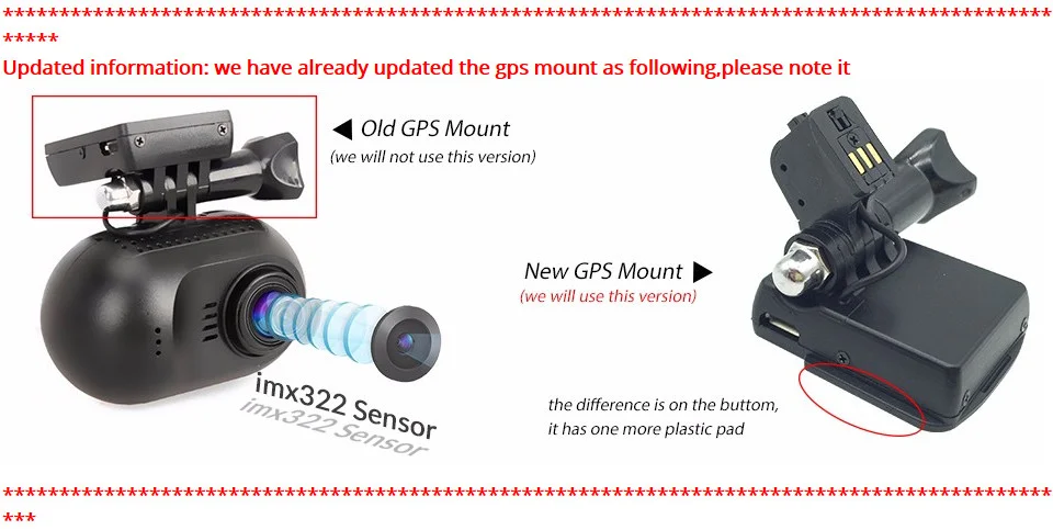

did anybody try a new GPS mount? Is there any difference to lock GPS?
I just checked the full story but not sure what is the reason of your problem. Is it possible to replace a new camera for you?
