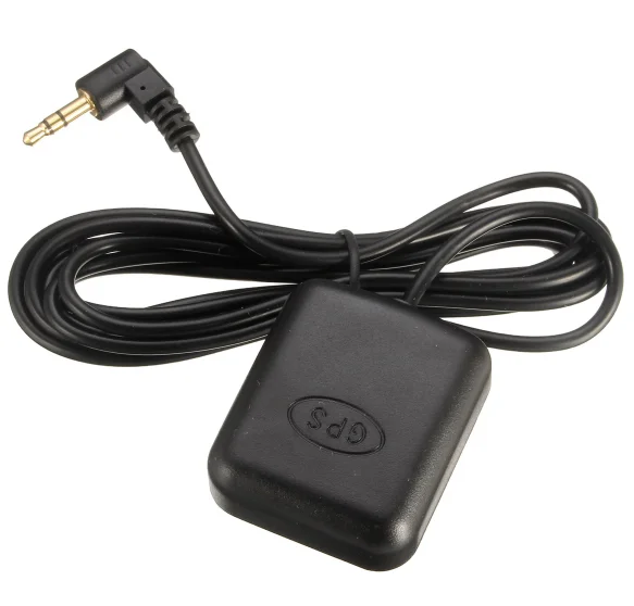

and another question: will operate this GPS module is soldered together his contacts built-in module?

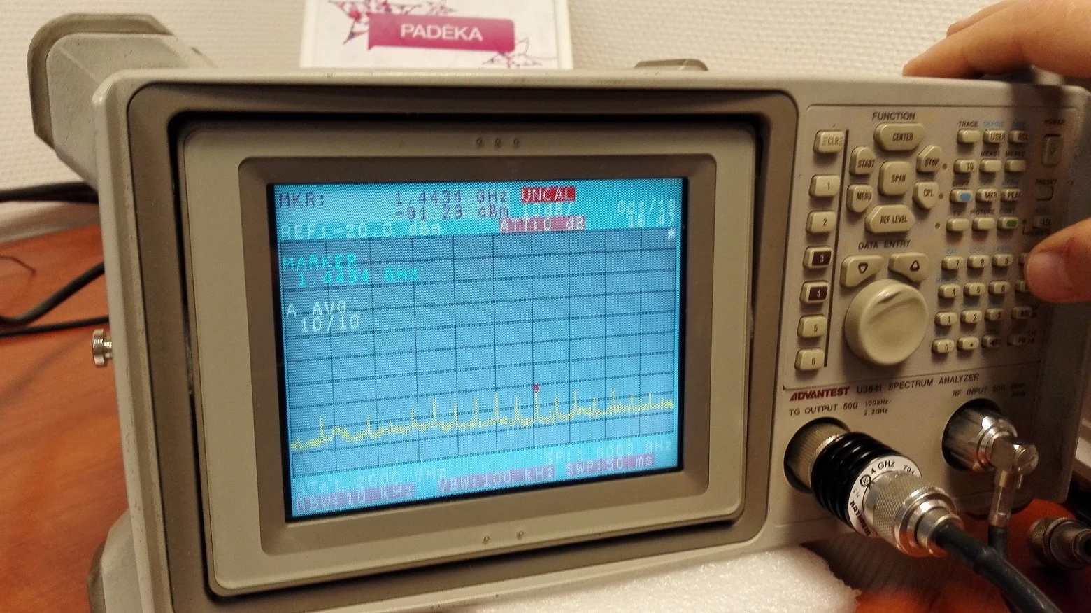

Hi,
today me and my colleague tested mini0903 with spectrum analyzer... Results not cheerful ๐Ÿ™
The peaks starting from: ...1294, 1316, 1337, 1358, 1379, 1401, 1422 Max (-95 dBm), 1430, 1444, 1465, 1486, 1507, 1529, 1550...
Sorry, but he named mini0903 as... bugs generator ๐Ÿ™‚
It's mini0903 v.04 (copper spray) with all known hardware updates & software version 2o17o425.
