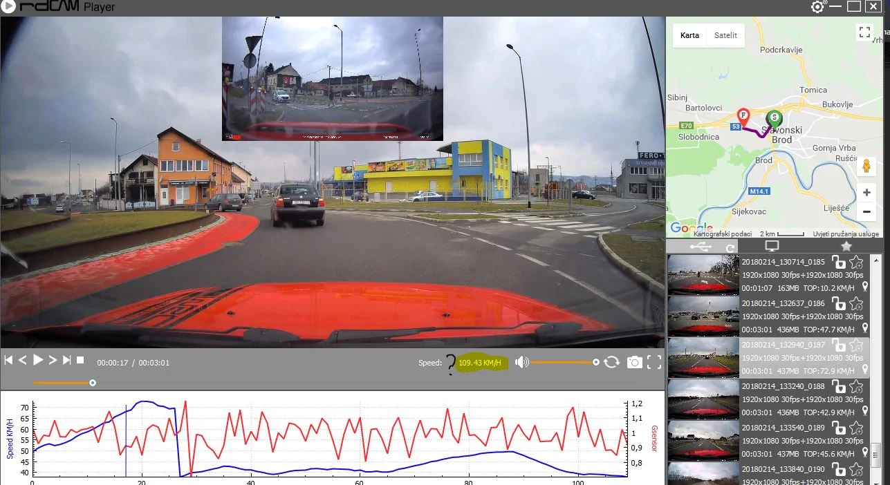

GPS worked for 2 months, then began to lose satellites and incorrectly indicate the speed.
I already wrote that I was shown a speed of 109 km / h at a roundabout.
I could not go from the parking in the city at a speed of about 109 km / h!

from your image I believe you are using an old version rdCAM. the displayied speed does not match the graphic, that is a program bug
please download the latest from www.rdcam.com
Well, here's that video file on Youtube, see what speed is recorded on the video
wow, it is unglaublich!

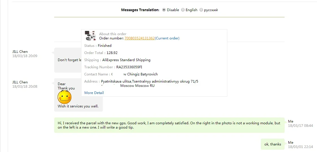

Hi, everybody. My problem with GPS is ongoing. As I wrote earlier, the seller faithfully sent me a new module. I got it connected and it worked successfully for 2 days and after the next run got the same result as the last module - there is no GPS icon, does not include GPS test mode. Rayman in what can be problem - in GPS from a bad batch or a problem with my Registrar?
What am I supposed to do now in this situation ? To the seller, I can not apply because the term of protection of the order ended, and he fulfilled his obligations in good faith

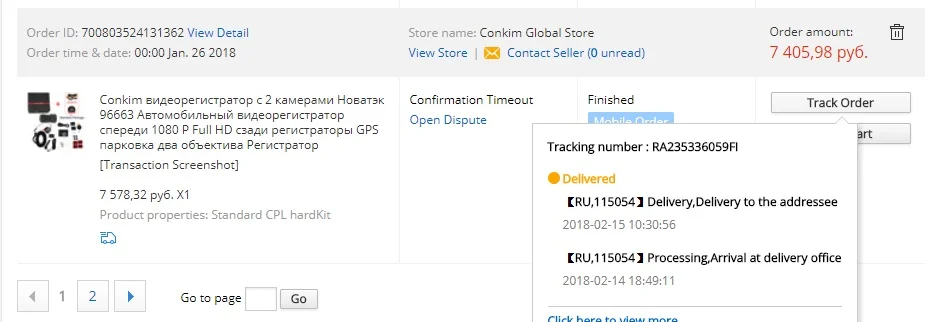

what is the purchasing date and shipping date?
it is quite strange why the replacement stop working.
My mini0906 was order Jan. 26 2018 , received by me Feb. 15 2018
Feb. 16 2018 I informed the seller about the first problems with the bad GPS signal
Feb. 18 2018 GPS stopped working
Feb. 27 2018 the seller sent me a new module
Mar. 17 2018 received by me

View attachment 37232View attachment 37233

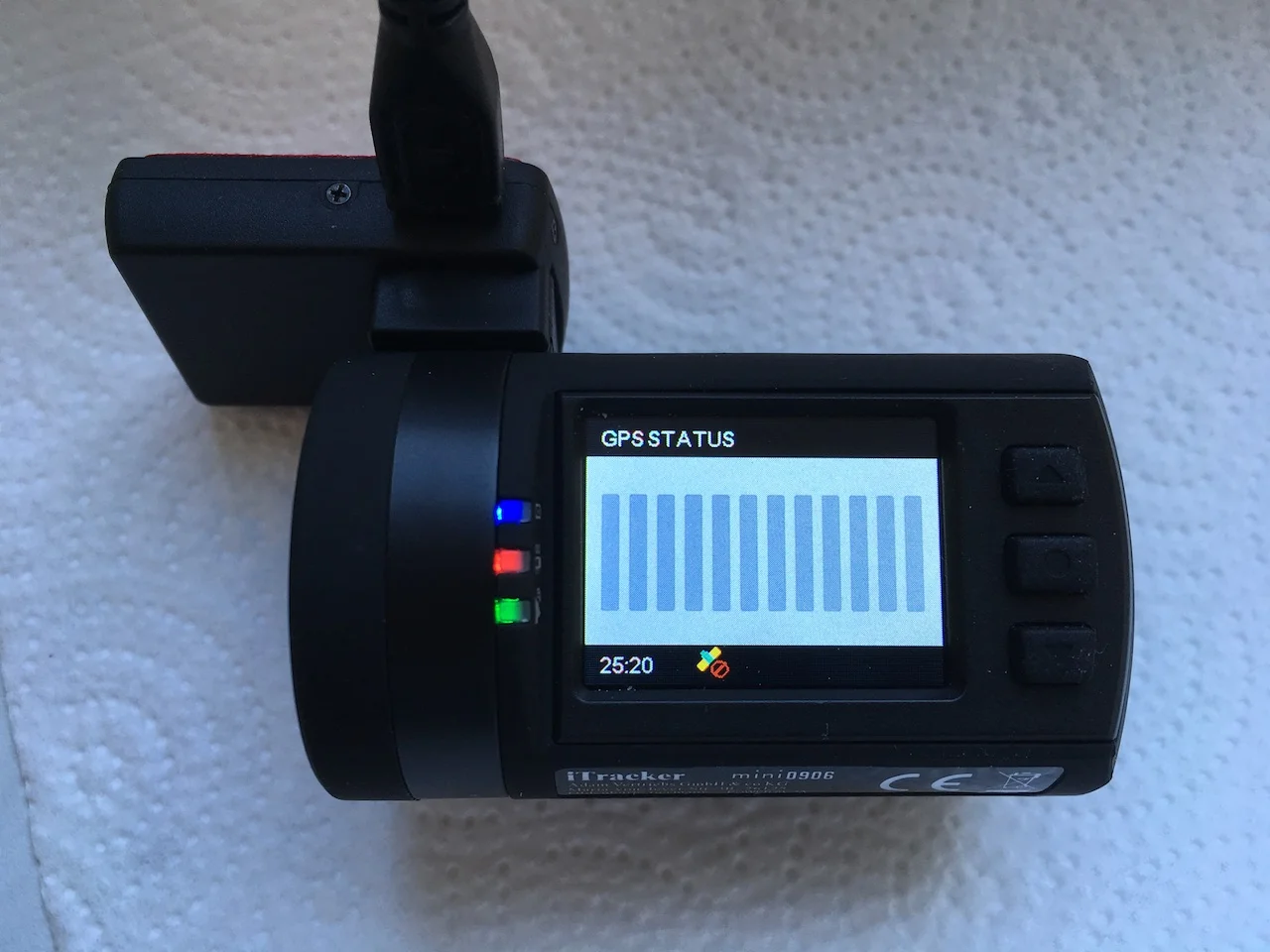

My 0906 cams just became a victim of this problem.
Three days after installing there is no more GPS signal even after 50 minutes parking outside with power on. Green LED blinks forever. GPS test mode shows no satellites and no bars.
Before at least I got 3 - 4 satellites with red or yellow bar.

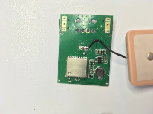

Well I found the problem. It's not a cold solder joint like MEG TECH tells you.
The GPS antenna was soldered to ground, but not to the GPS chip.
It's a real miracle that it worked at all before.
Of course to find this out one has to desolder the PCB from the pins, which is nearly impossible without nearly breaking it.
Resoldering the PCB to the pins after repair is then completely impossible unless you have professional desoldering equipment to clean the pins (vacuum pump etc.).

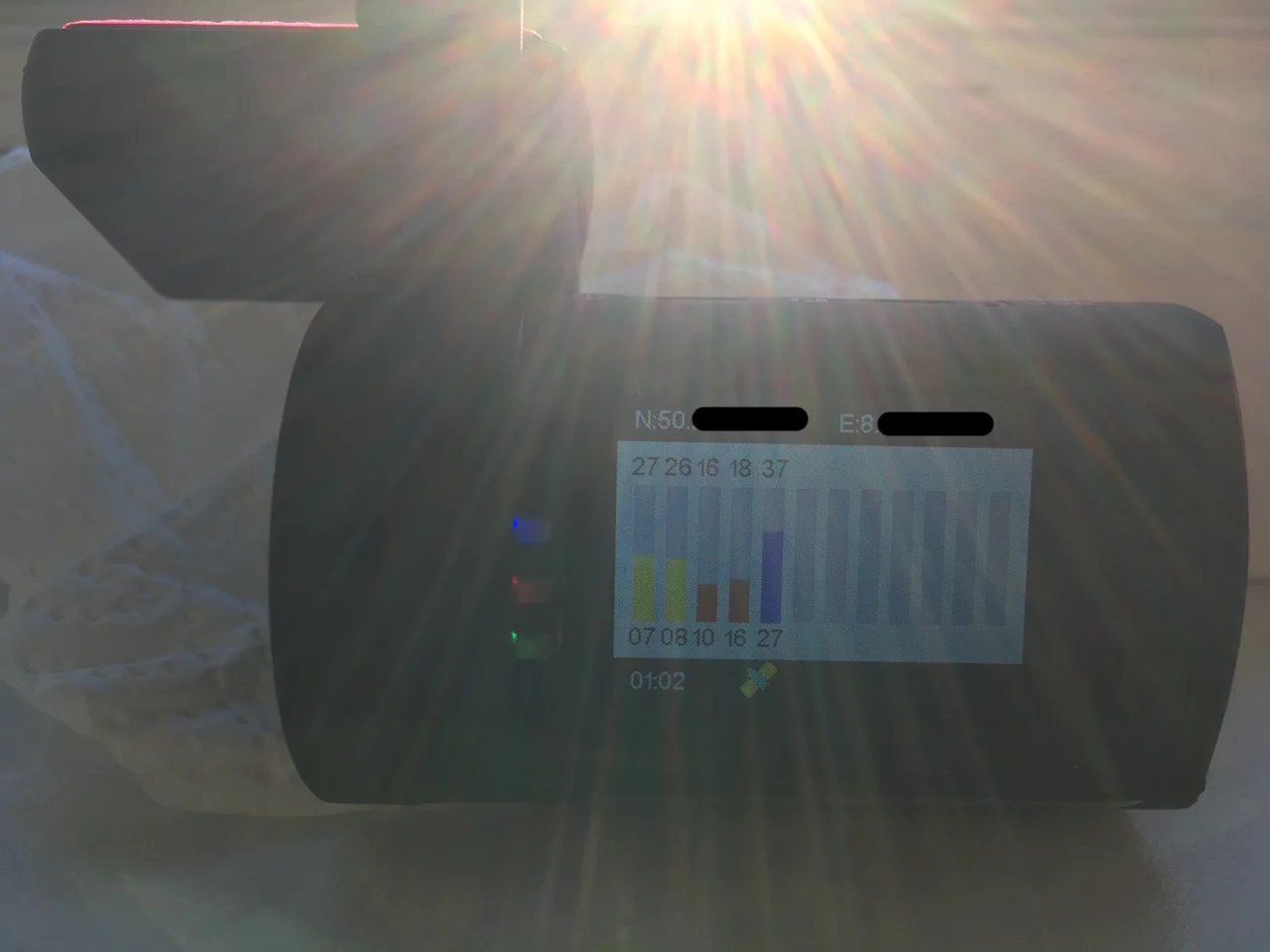

Two iTracker replacement GPS arrived. Here's the results. They are identical for both GPS, so I just post for one of them.
First power-up in front of open window with by bench power supply at 13V with USB adapter and no rear-cam:
Yeah... :rolleyes:
So power off and back on the bench power supply:
Hey look, a blue bar and so fast!
First time was a display bug?
