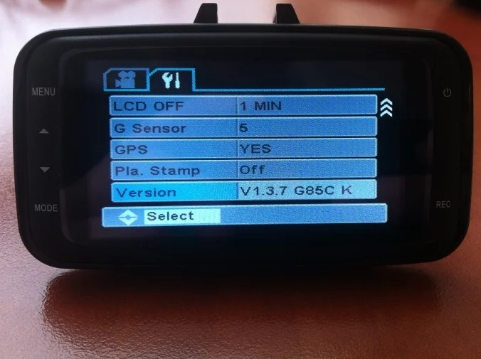

Hello,
I bought DVR GS8000 from ebay (sold over 85pcs), price 90$ (some %sale)..

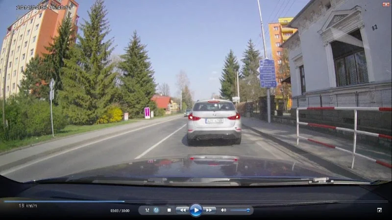

Everything is OK, it works fom christmas every day in my car, but I think that the video could be in better quality 🙂 I try 1920x1080 30p - sharpeness - high/standart, 1280 30/60p, but the video isn't great.
Look:

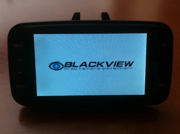

The screen after Camera ON (some Blackview camera - what is this?) Model M900??
Menu with firmware version:
Can I update firmware to original GS8000 firmware like V 1.0.8. G82AK or V 1.0.9. G82AK??
And video screen:

Can I update firmware to original GS8000 firmware like V 1.0.8. G82AK or V 1.0.9. G82AK??:
Judging by the time stamp and menus that looks like the same GS8000 screen as mine witch I think is on V 1.0.8. G82AK. (It's been forever since i used it after it destroyed a Micro card) However I would do as jokiin suggests.
