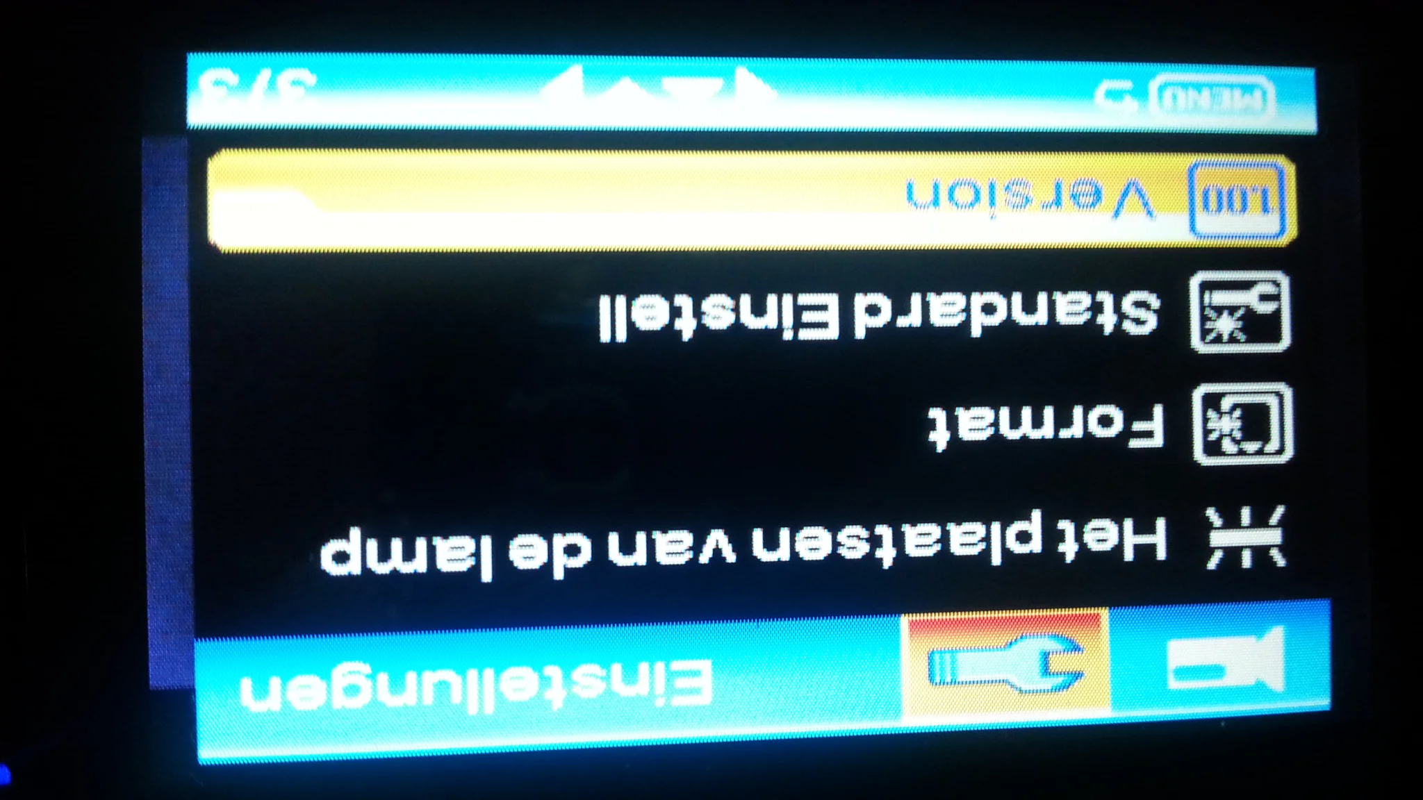

I applied a picture of my menu. I want to set the cam to the power net of my car, so that the cam automatically start to record and save all without start, stop and save it every time.1384294752356.jpg
that's the cheap Novatek version unfortunately, GS8000L, someone that has one will need to advise about the menu options, it should record automatically though, are you using the supplied USB cigarette power adapter?

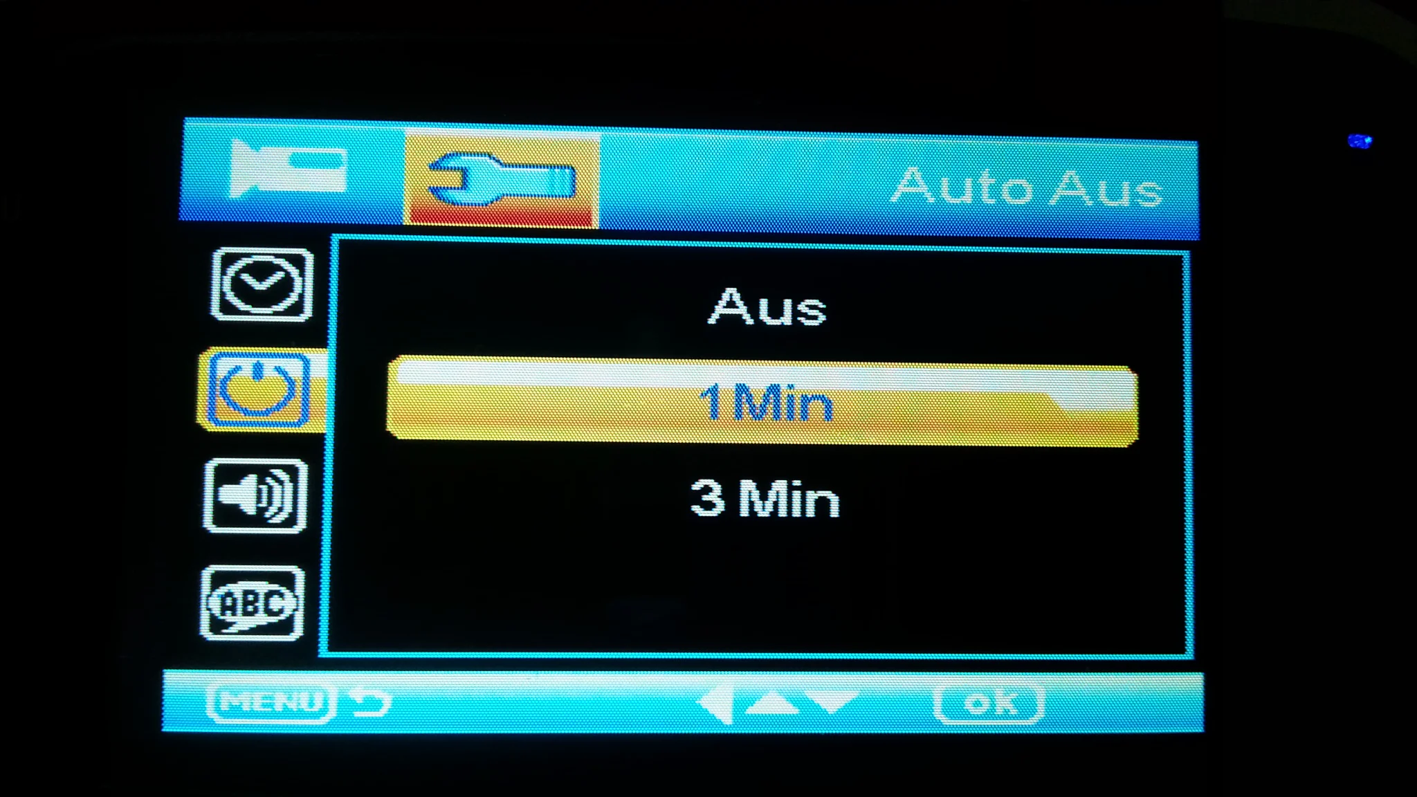

look for a Screen Saver or LCD Off seting in the menu to turn the screen off after a few minutes
I set it on 1 Minute but its allways on when recording....
Also i thought that it would record automatically if the g sensor get some input1384359779525.jpg
