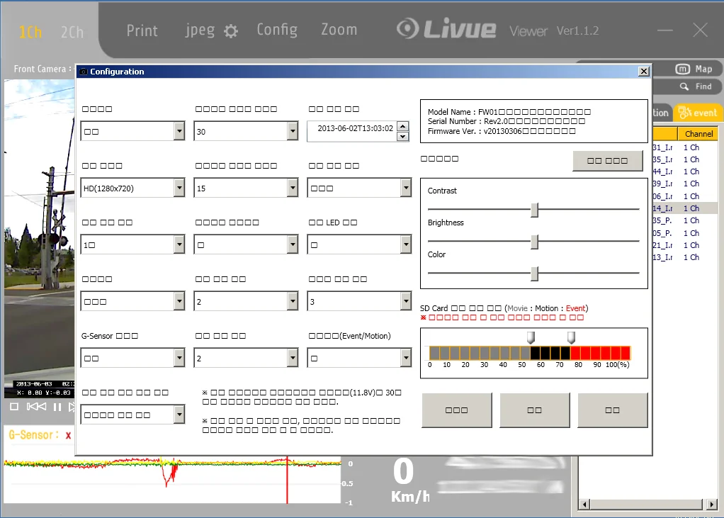

Btw this is what I see on the livue viewer settings page. This was installed off the sd card.
All those little squares means that the OS can't display the Korean language.
I'm sure there's a link somewhere in this thread for the English language software.
This is what I see when I use the winy viewer and these are the settings that I am trying to get to stick in the config file. When I press OK and close the viewer and then reopen the viewer they are still there. Looking on the computer, the date on the config file is consistent with the time the OK button was pressed. But if I put the SD card in the camera and later come back to the computer the settings are back to the defaults.

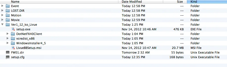

Bigsplash said:
Dnorth13 can you post a screenshot of your micro card file content?
Here you go. Hopefully it will help you shed some light on my issue.
As you can see the date on the FW01.dir is tomorrow and the setup.cfg is today (I just attempted another change to the settings and making the setup.cfg read only, but have not yet placed it in the camera).
BTW, this was a screen shot from a mac computer, in case you are wondering why it has a different look than you might have expected.
Thanks for any help you can provide.
