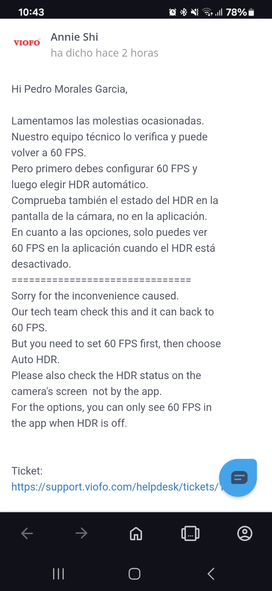

I meant that Viofo is only providing beta firmware to test users, not to customers who paid for the camera.
In the forum this is what I'm seeing, only the testers who received the camera before its official release or for free have the beta version.
This is the answer they gave me in the ticket I sent to Viofo.
I explained perfectly the problem and the existence of the test firmware.
They have basically ignored my request.

I have opened a ticket to viofo and they have ignored my request, claiming that I configured HDR again as if I were to blame for a bad configuration.
