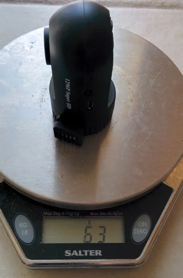

Did we get an "official" weight for what a heat-sink equipped 803 should be? Mine, which was shipped from Foxoffer on 08-19-2014, weighs in at 63 grams.
Edit1: Foxoffer claims to have sent me the latest version with heat-sink (despite sending me the old style GPS bracket). Apparently there is enough variation in scales to not be able to effectively determine the added weight of the heat-sync.
Edit2: The two most recent 0803 cameras I bought from Black Boxed weigh in at 62 grams. These are also supposed to have an internal heat-sink. Oddly, they came in a different style box compared to my original 0803 Foxoffer camera.
