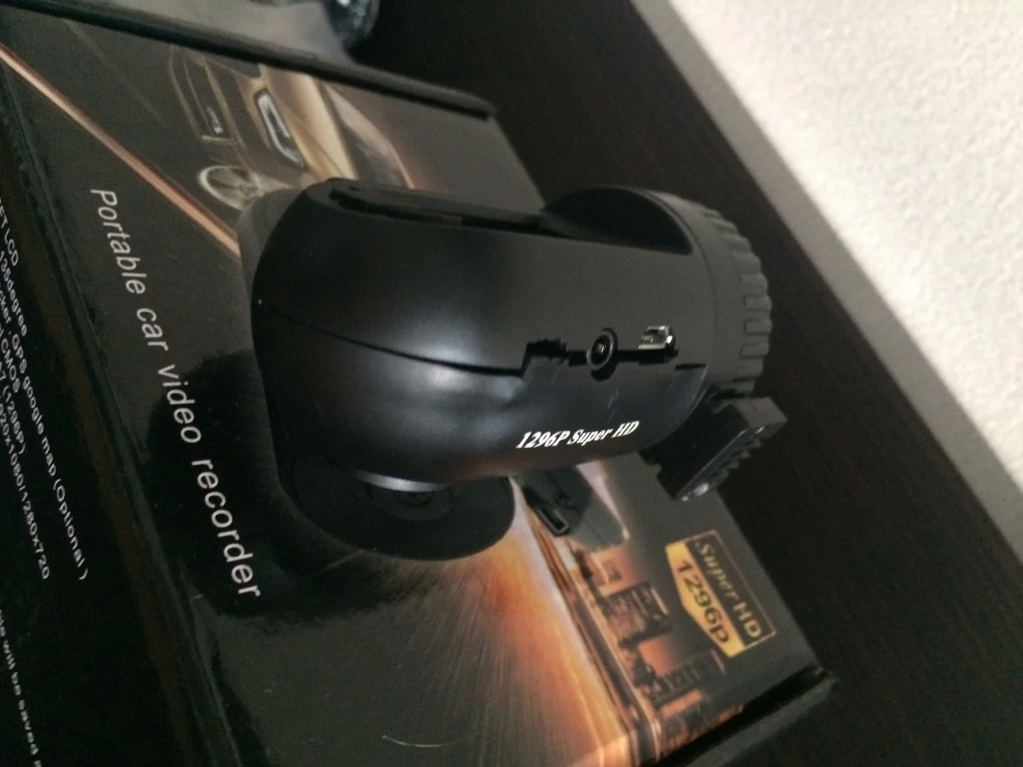

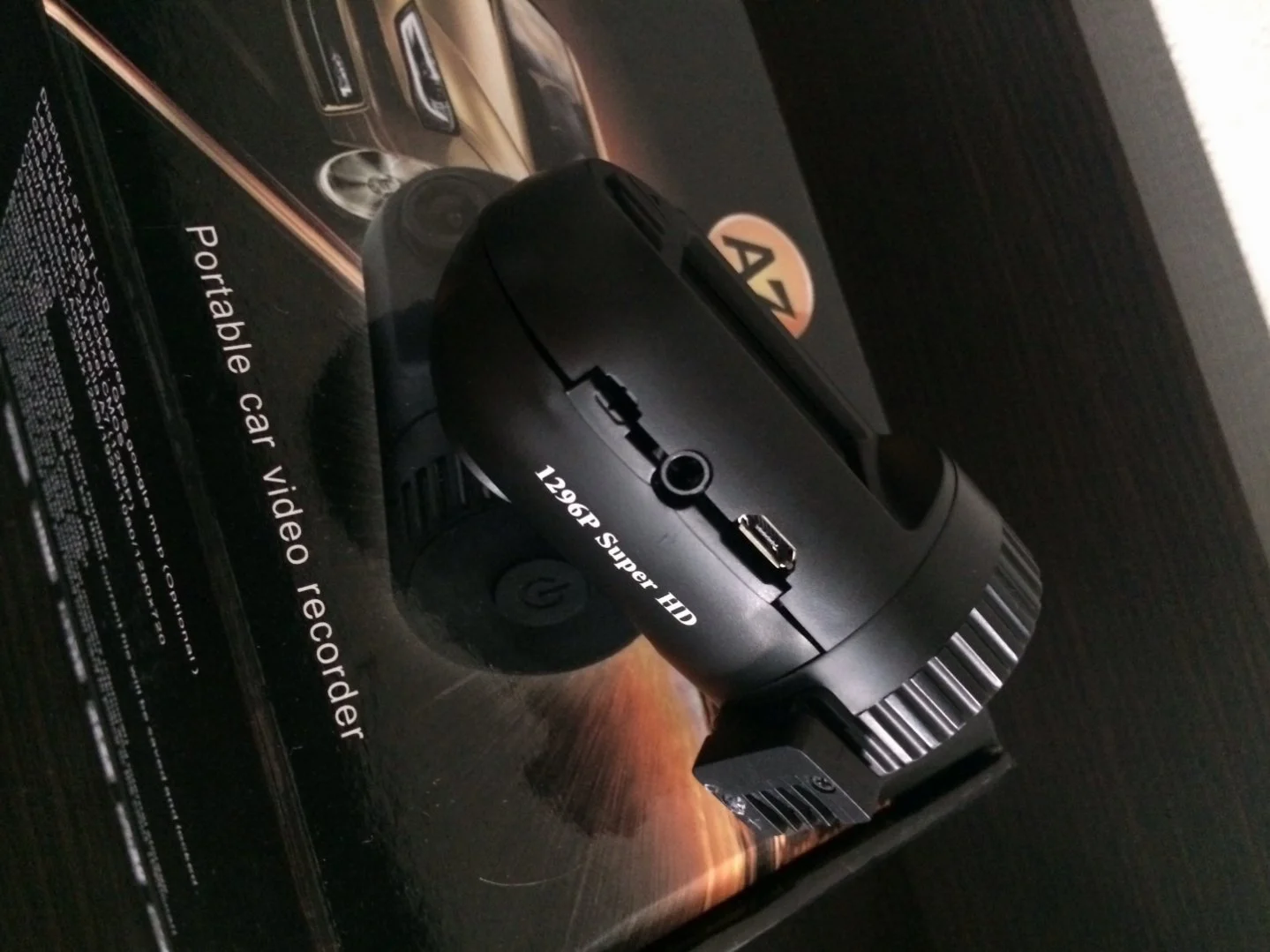

Hello,
my 0803 blow from inside after 2 hours run, any iddea why? could be the battery?
Thank you, do you know what couse this and if this internal battery can be removed without affecting the operation of the camera as it is connected to the power source of the car? anyway this battery gives away a minute after disconnecting, is pointless and as you can see makes big damage...
Usually it's either heat or overcharging that causes most swelling. You can VERY CAREFULLY try to replace it. Unfortunately there is no super capacitors as of yet so you need the battery to run the cam. There isn't enough room for capacitors in the 0803.
As GJHS points out, various things such as excessive heat or overcharging or just a defective cell can make the battery fail. If the camera was not damaged by the swelled up battery it would be relatively easy to install a replacement. You would need to disconnect the battery from the power source before soldering in a new one.
Edit: From the looks of your photo the camera should just snap back together after replacement of a new battery.
and I suspect the heat not overcharging becouse I use original charger, maybe a cell fail too, where I find parts for this cam? battery and housing, thank you
greatly appreciate some advice where I can find to buy a cover for 0803 and battery, thank you
Contact the seller that you bought it from. If it's still somewhat new they should send you a new battery for free.
