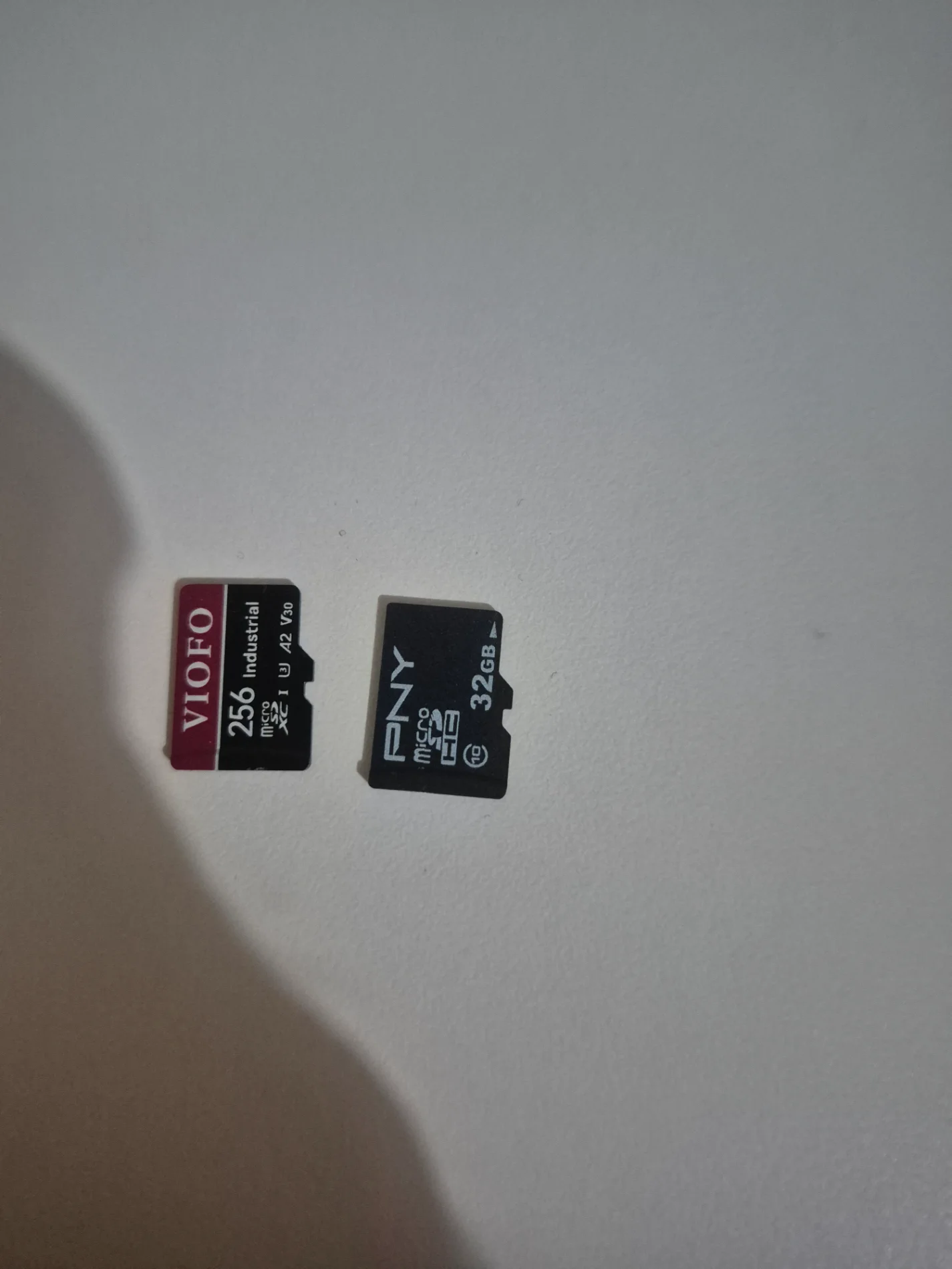

Thank you for the photo.Here is both.
It worked fine earlier for the other update the one with the ww on it.
Do you have another computer?
Better yet, do you have a Chromebook?
OK.This is the only computer I have 🙁
Yes but that one file is zipped? What do I do.?Thank you for the photo.
Can you try again with the VIOFO SD Card?
What file?Yes but that one file is zipped? What do I do.?

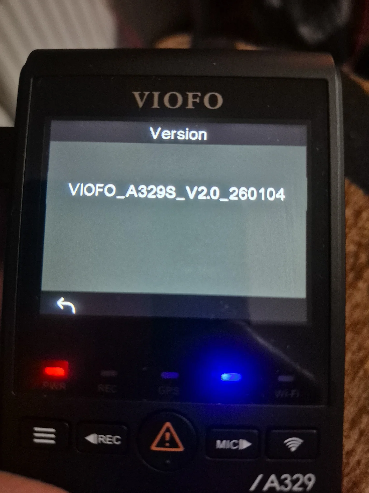

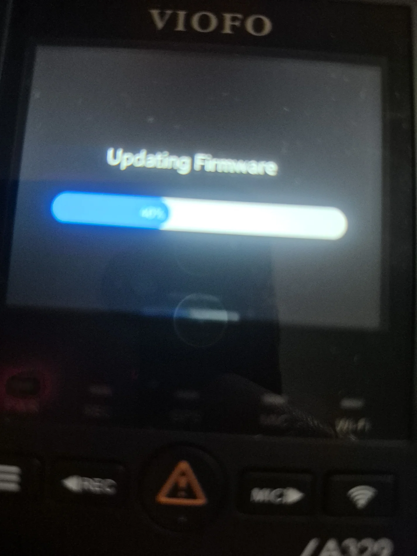

Do we finally have success?
Time for celebration?
We know it worked because the A329S firmware updated.What about the LD98530A? How do I know that updated?
There is no rear firmware.What about the rear?
What if he decides to buy the Telephoto camera, and needs to install the A329T firmware 🤣SUCCESS!

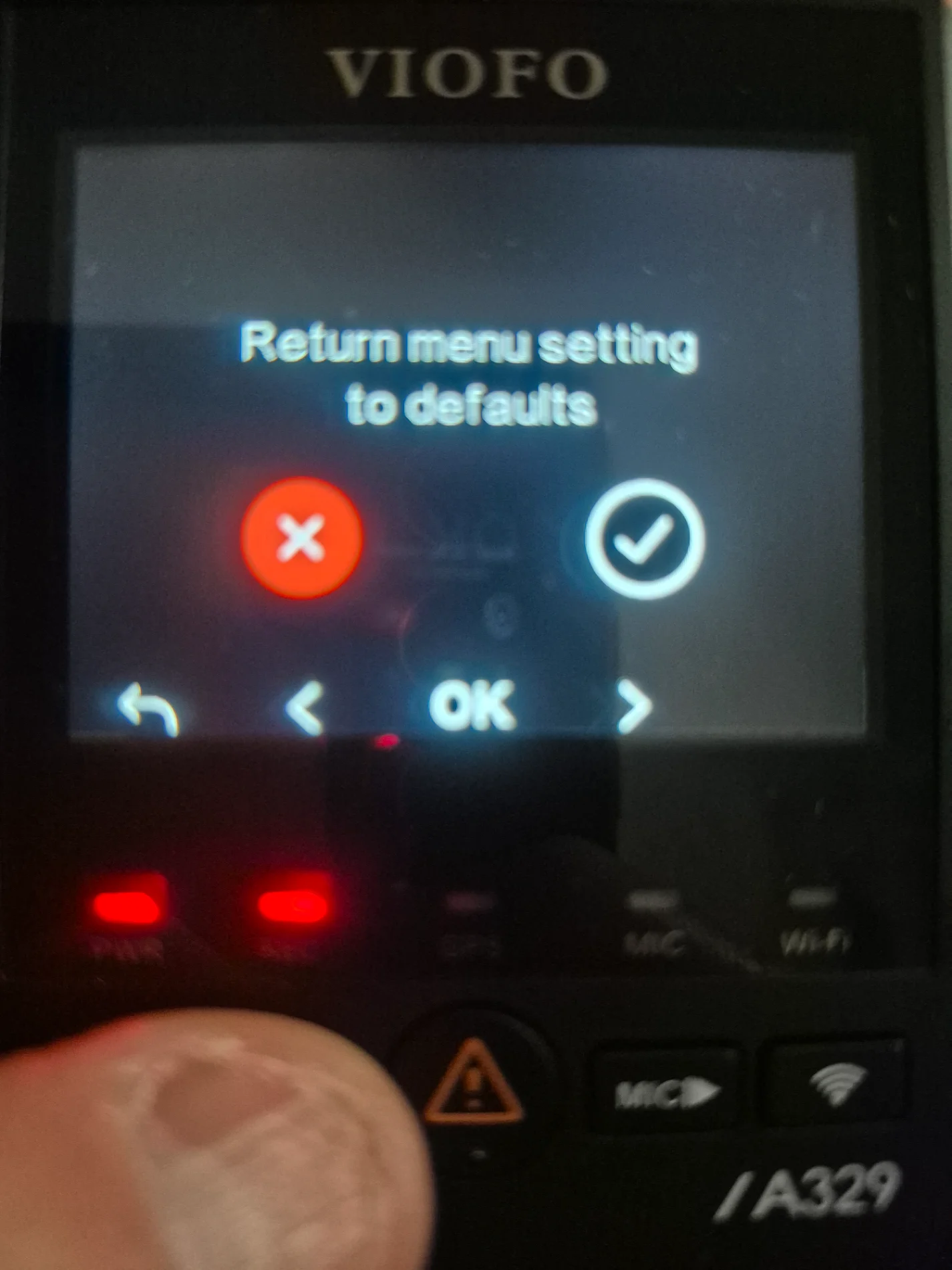

ALWAYS perform factory reset / default setting after firmware update.When it did the updates all my settings had gone. So maybe it already did a factory reset?
Ok doing tbis now. And then will go straight in car to test.ALWAYS perform factory reset / default setting after firmware update.
yesThis?
