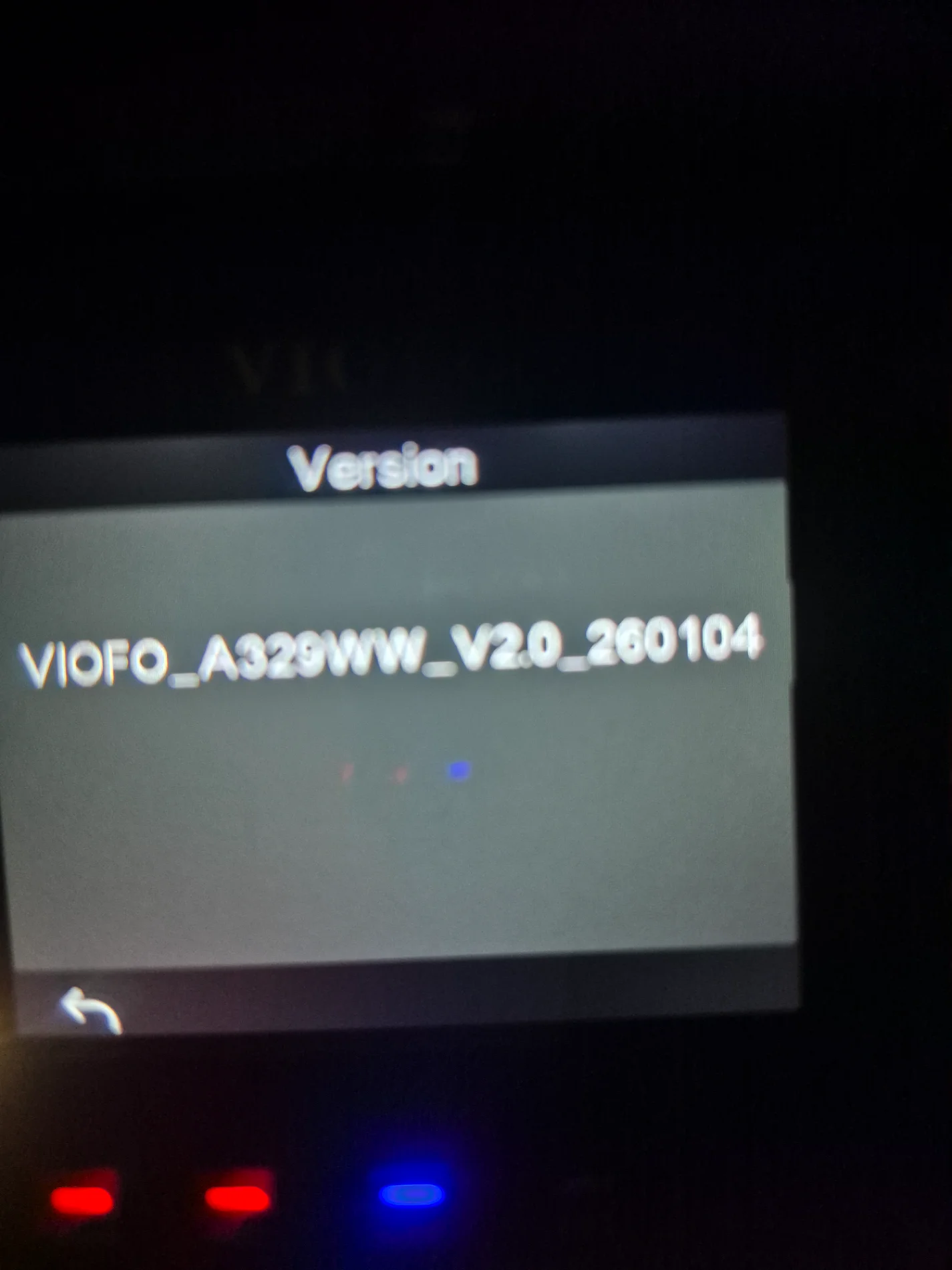

It's still showing this firmweear on it

OK, now what firmware is showing on the cam?

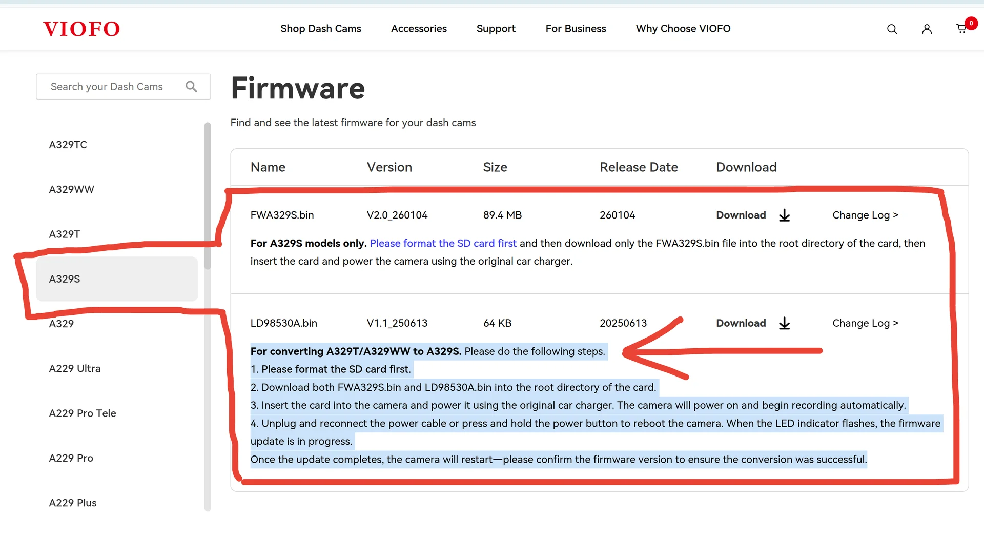

Ive reformatted the sd card and cleared the previous 2 downloads from my PC and making a fresh down load of tbe 2 files.
Maybe try that?. Or just try one file?
OK, install both files on SD card, and then read Post #96 by @rcg530 for instructions.
So follow this
The first power on for the dash camera will load the LD98530A.bin file. It will appear as if "nothing" happened, but it actually loaded the LD98530A.bin file. You'll need to power down and then power on the dash camera again to get it to install the FWA329S.bin firmware file.
