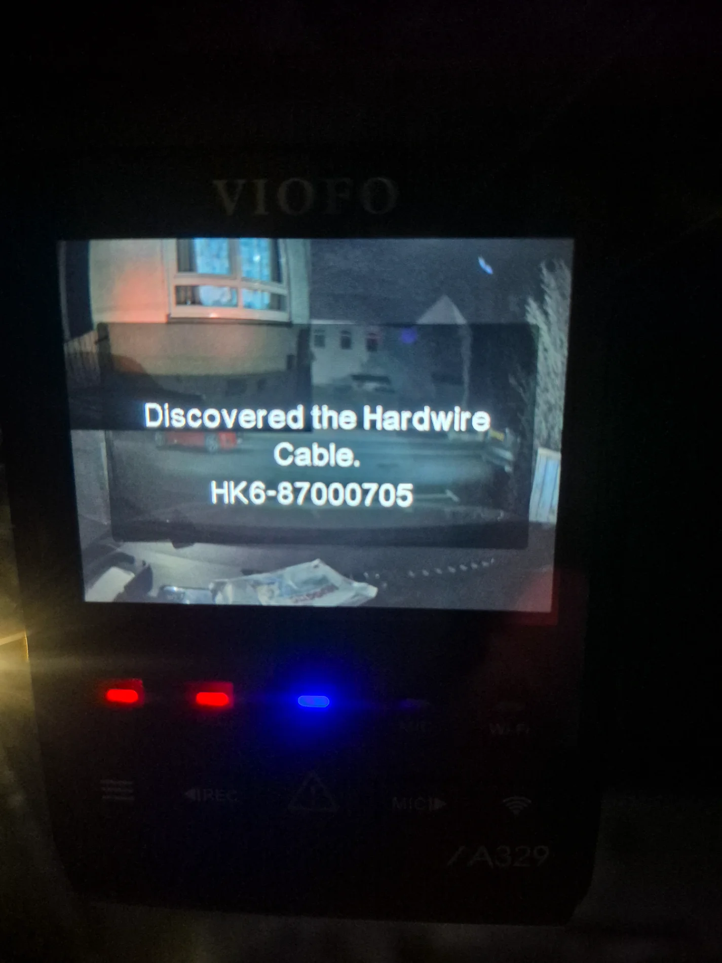

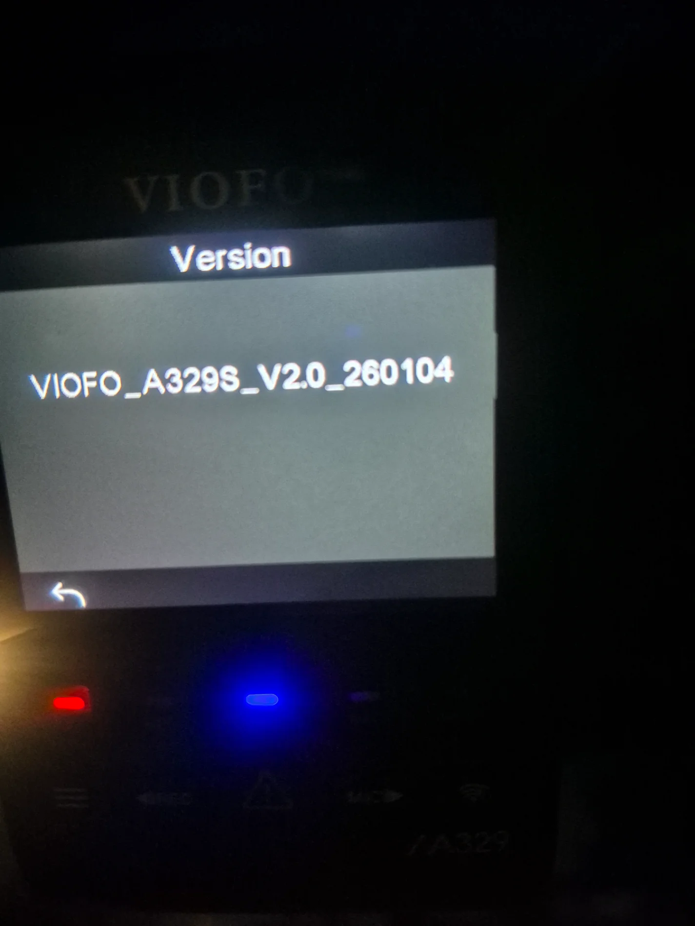

Thank you all so very much. Couldn't have done it without all your help. Really appreciated.
Parking mode all working fine. Just tested it in car.

It was exhausting. I presumed that the dash cam installers store would have set everything up working for me. They did none of that. They did a very basic installation without following any of the instructions and didn't even do that correctly and didn't ensure it was working properly which it wasn't.
They said we don't do any of that!
Fair enough they didn't check firmwear was updated but atleasr ensure its working and installed correctly

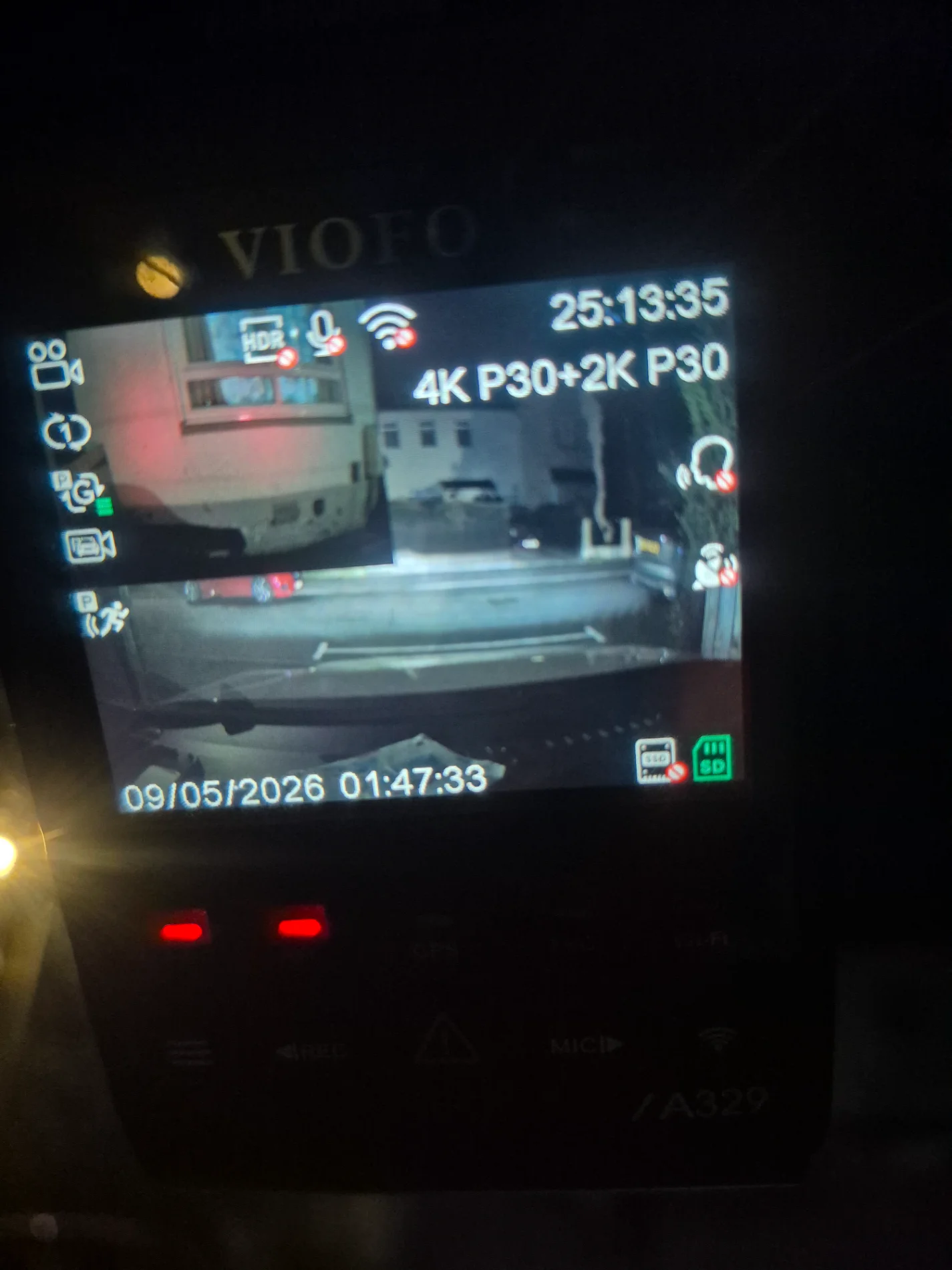

I hope now its just a few smaller things to figure out like for instance.

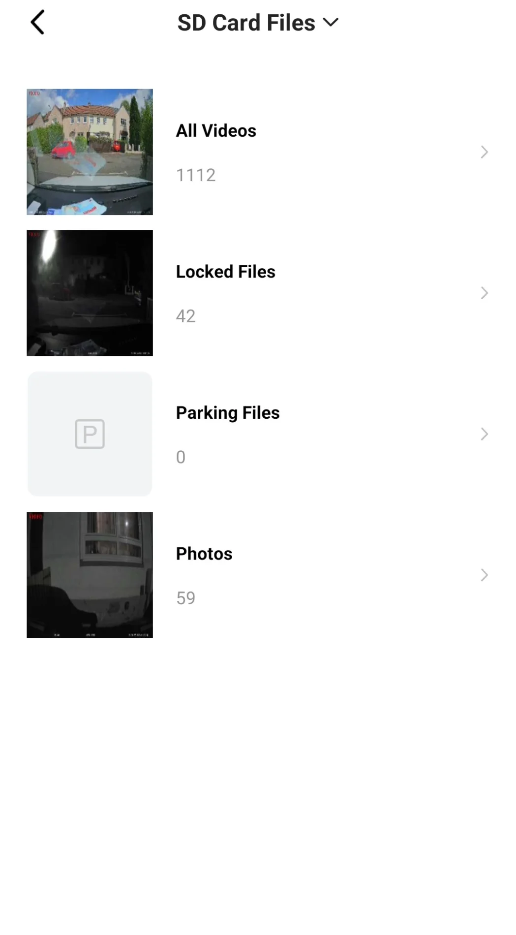

1) When left iver night in parking mode (it said parking mode started) I noticed that in my parking mode video section in the app there were zero parking mode videos? Why is that and how do I fix that? Please see attached
(Before we changed the firmwear there were parking mode videos)
2) I also noticed it has recorded continously since last night. Whereas before we changed the firmwear there were only a few clips over night of movement.

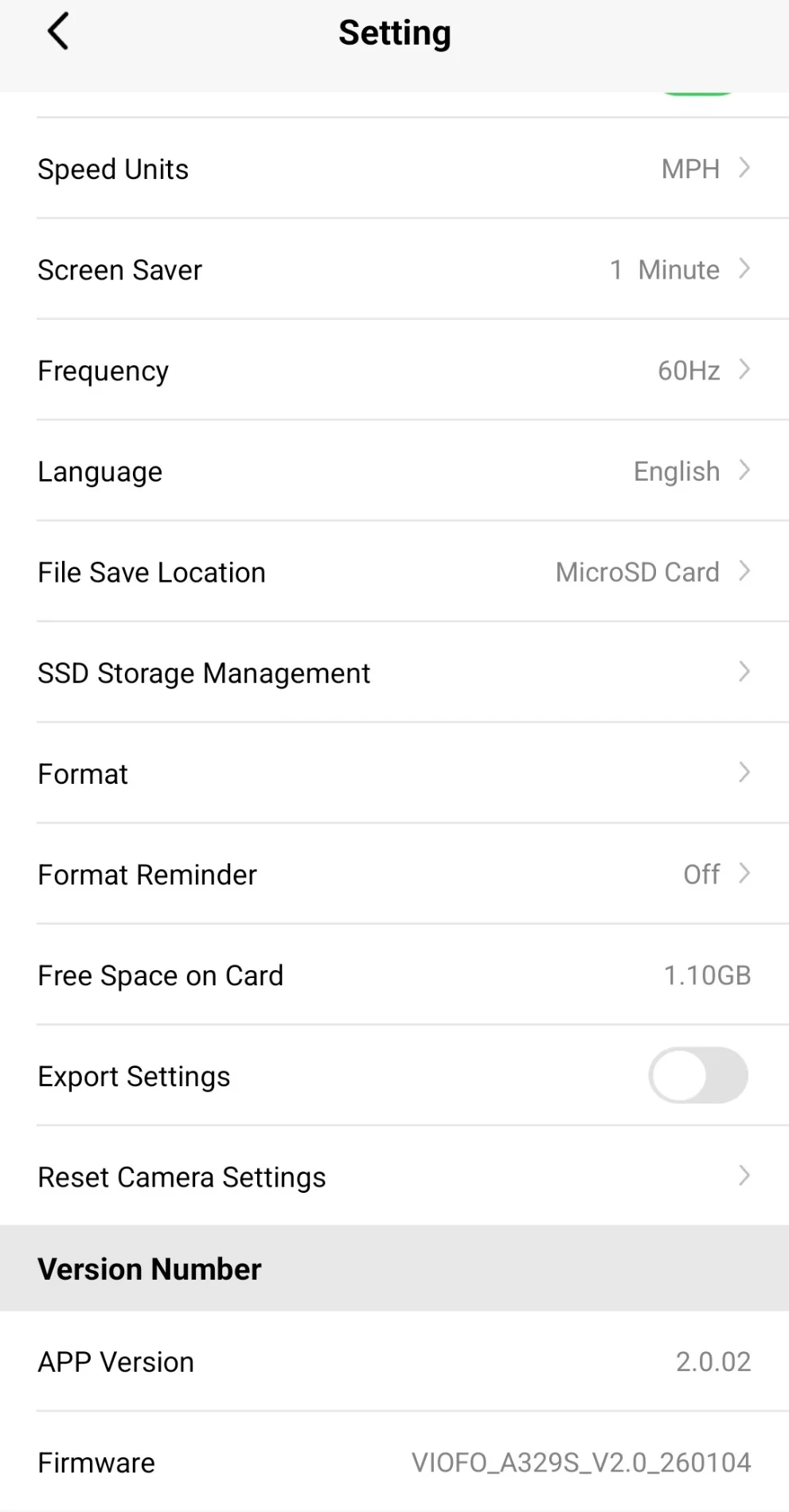

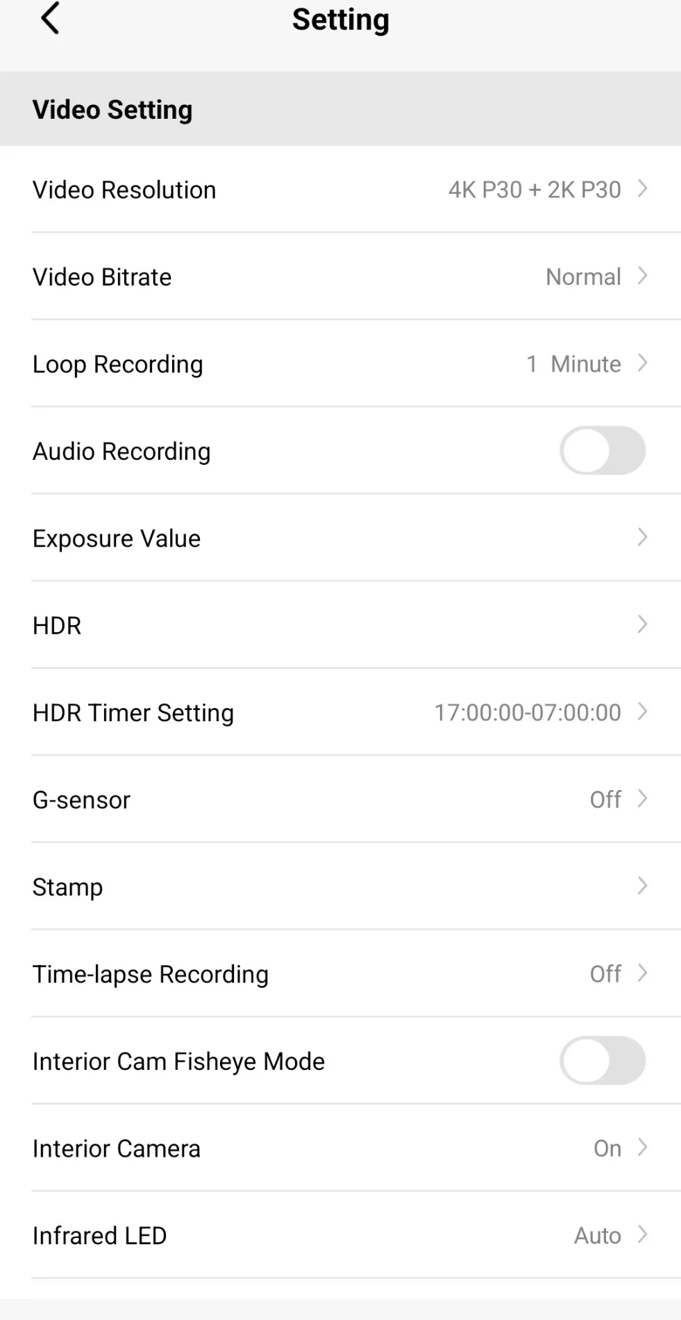

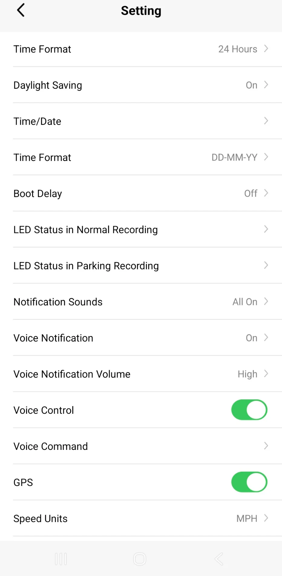

Ive attached all settings if anyone can help me figure out how to resolve this.

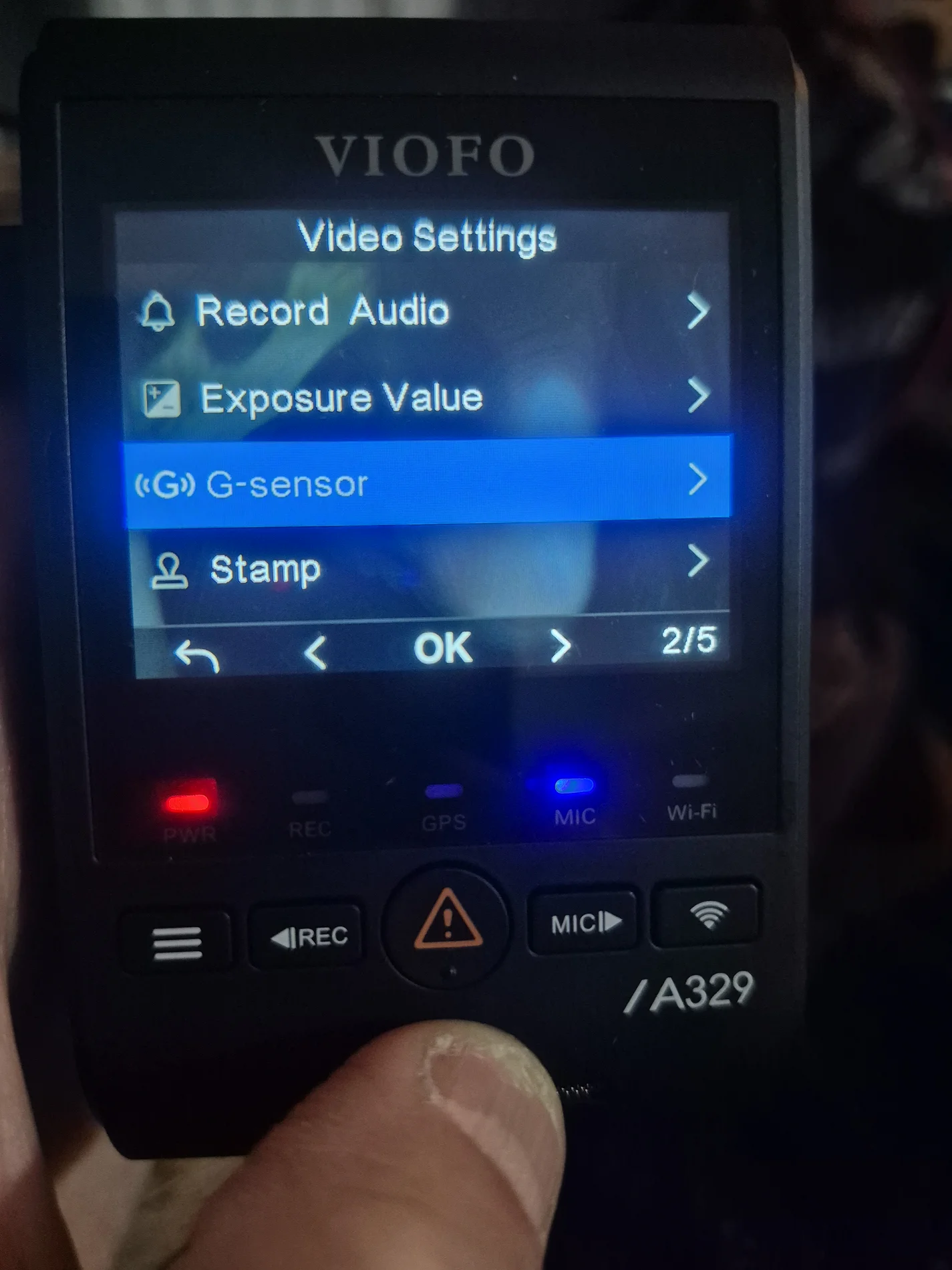

3) Ps whenever theres an impact ie a closed door in parking mode it makes a camera click noise like its taken a photo.? Why is that?
@cartyre you are now heading into the parking mode rabbit hole. You'll now have to decide what parking mode works for your driving and parking situation.
To answer you questions, you are currently using "Auto Event Detection" as your parking mode. In this mode the dash cam is simply waiting and watching for any motion and impacts to happen. If any is detected, it will save the previous 15 seconds before the motion or impact and the next 45 seconds to further capture what is happening.
This makes it seem like the dash cam is always recording when in fact it is simply waiting. This is why there are no videos but when you close the door which is an impact, the dash cam started recording and part of that process is also taking a photo. You will notice this taking a photo thing when a video gets locked/protected.

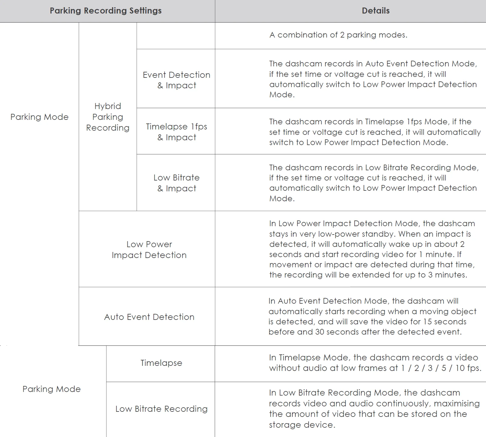

This chart from the A329S user manual is a bit outdated since there are now several additional time-lapse options within the Hybrid parking mode list of available parking mode choices.

Going back to a screenshot you included in post 166, it looks like you only have front and rear camera video files. The A329S can support up to 3-channels. Each camera is a channel. Since you don't have the optional interior camera, the setting I mentioned won't help your situation.
If you want buffered recordings whenever a motion or impact event takes place, you'll have to use the "Normal Parking Mode" options. The low power impact detection [LPID] parking mode only creates unbuffered recordings when it responds to an impact event when the A329S is fully in low power mode.

"Normal Parking Mode" is a group of older/traditional parking modes available in a VIOFO dash camera. This term was used by VIOFO when discussing the "Cut-off Timer" and "Cut-off Voltage" settings in the user manual that I showed in a previous post.
A "Normal Parking Mode" is any one of the following parking modes: Auto Event Detection, Time-Lapse, or Low Bitrate.
The "Low Power Impact Detection" [LPID] parking mode is a recent addition to the VIOFO line up [in this dash camera series].
The hybrid parking mode feature is a method of combining one of the "normal parking modes" with LPID. The dash camera will operate in the selected "normal parking mode" until either the "Cut-off Timer" or the "Cut-off Voltage" have been triggered and that's when the dash camera will switch to LPID parking mode. The dash camera operates in LPID parking mode until the HK4 or HK6 hardwire kit's low voltage cut-off feature turns off power to the dash camera or you restart your vehicle.
