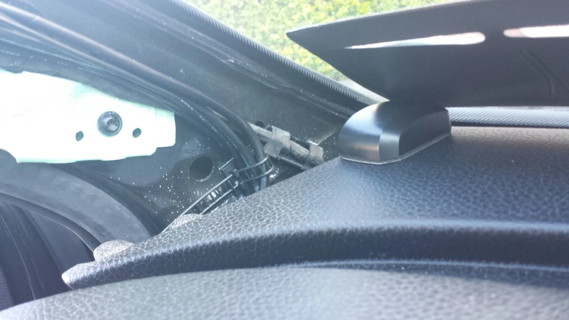

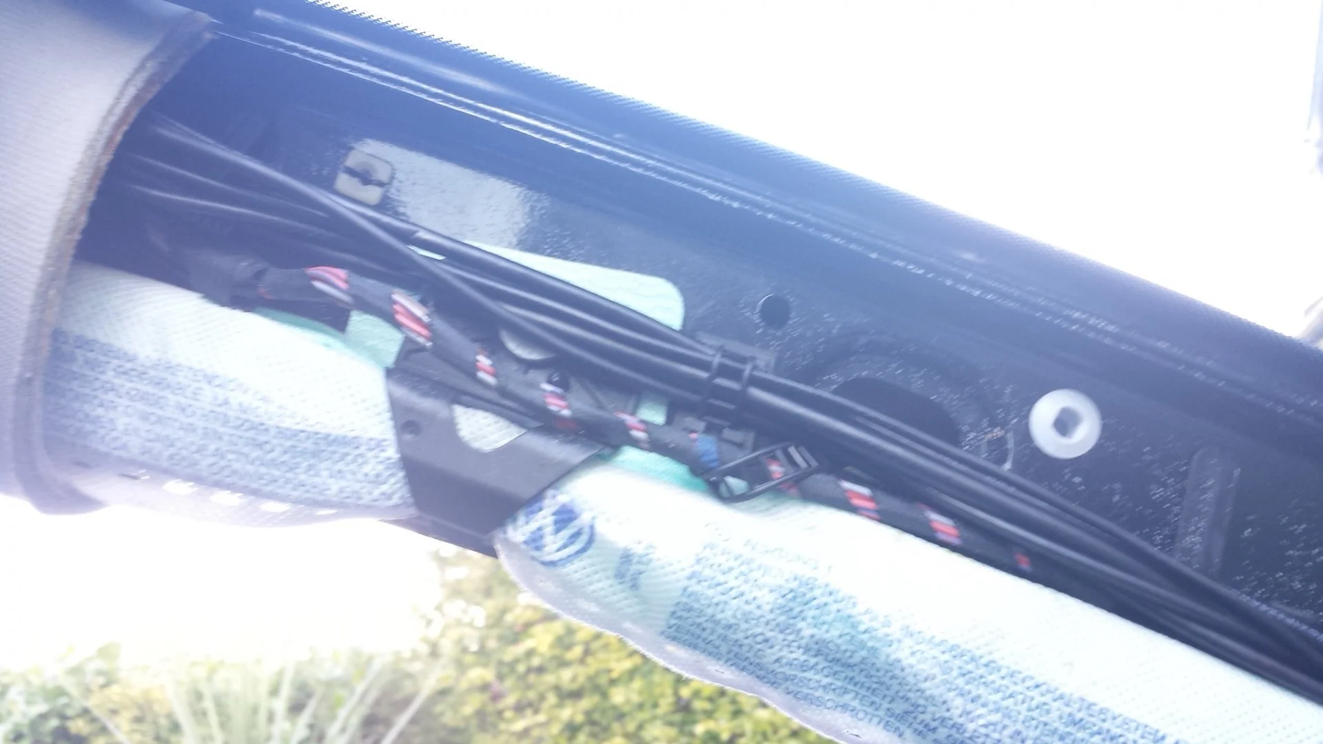

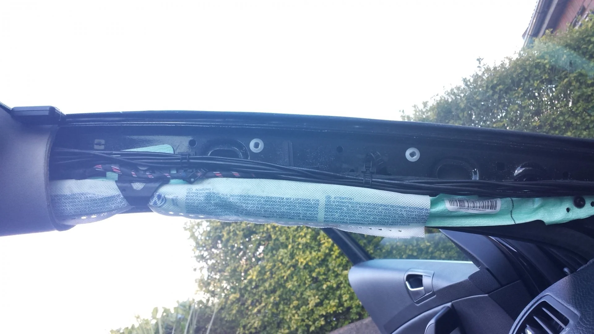

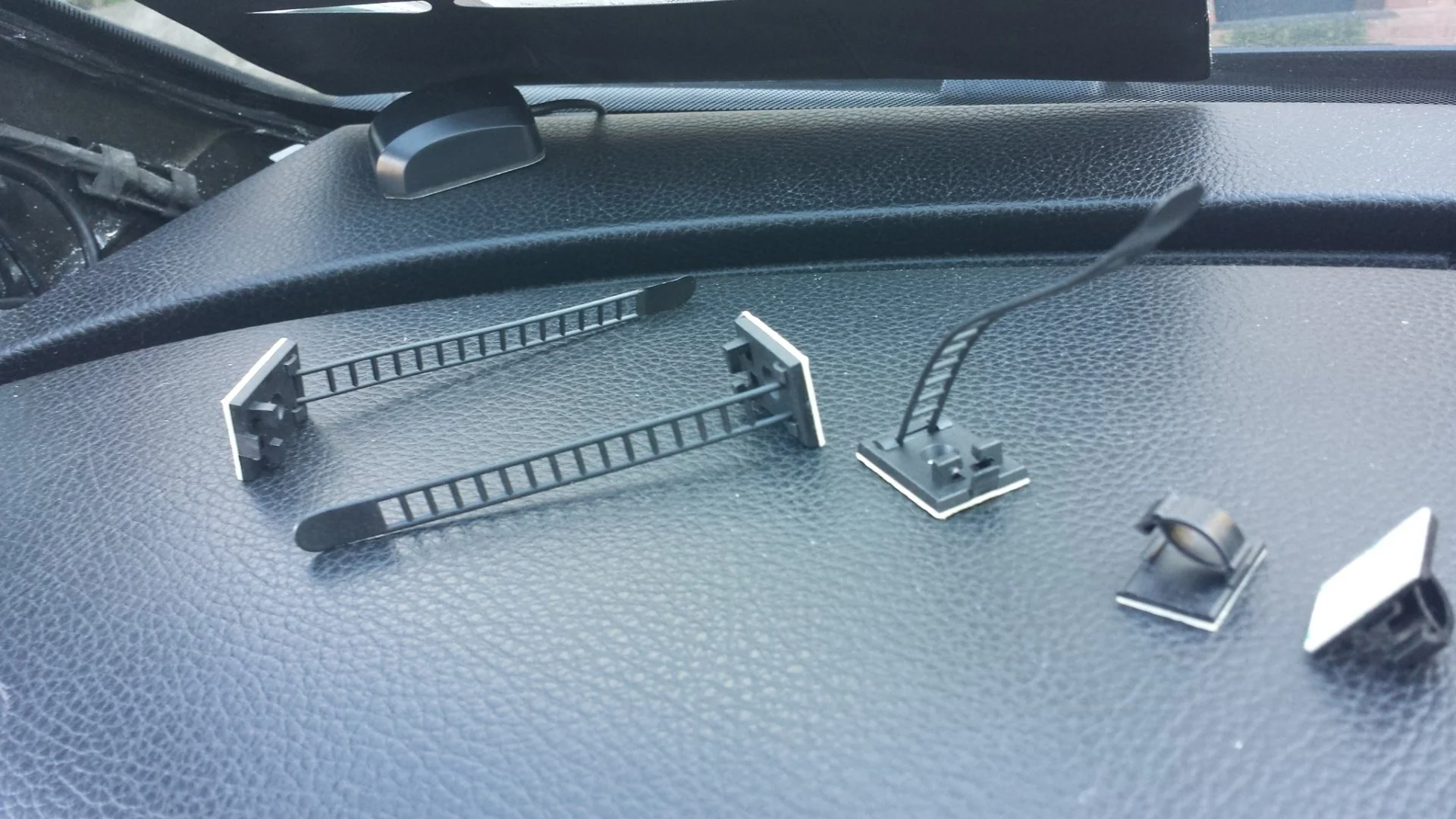

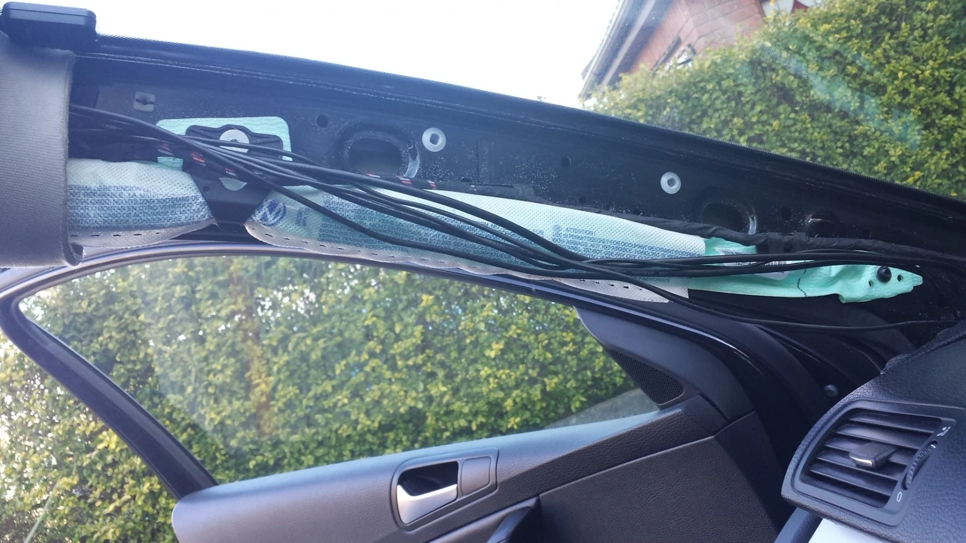

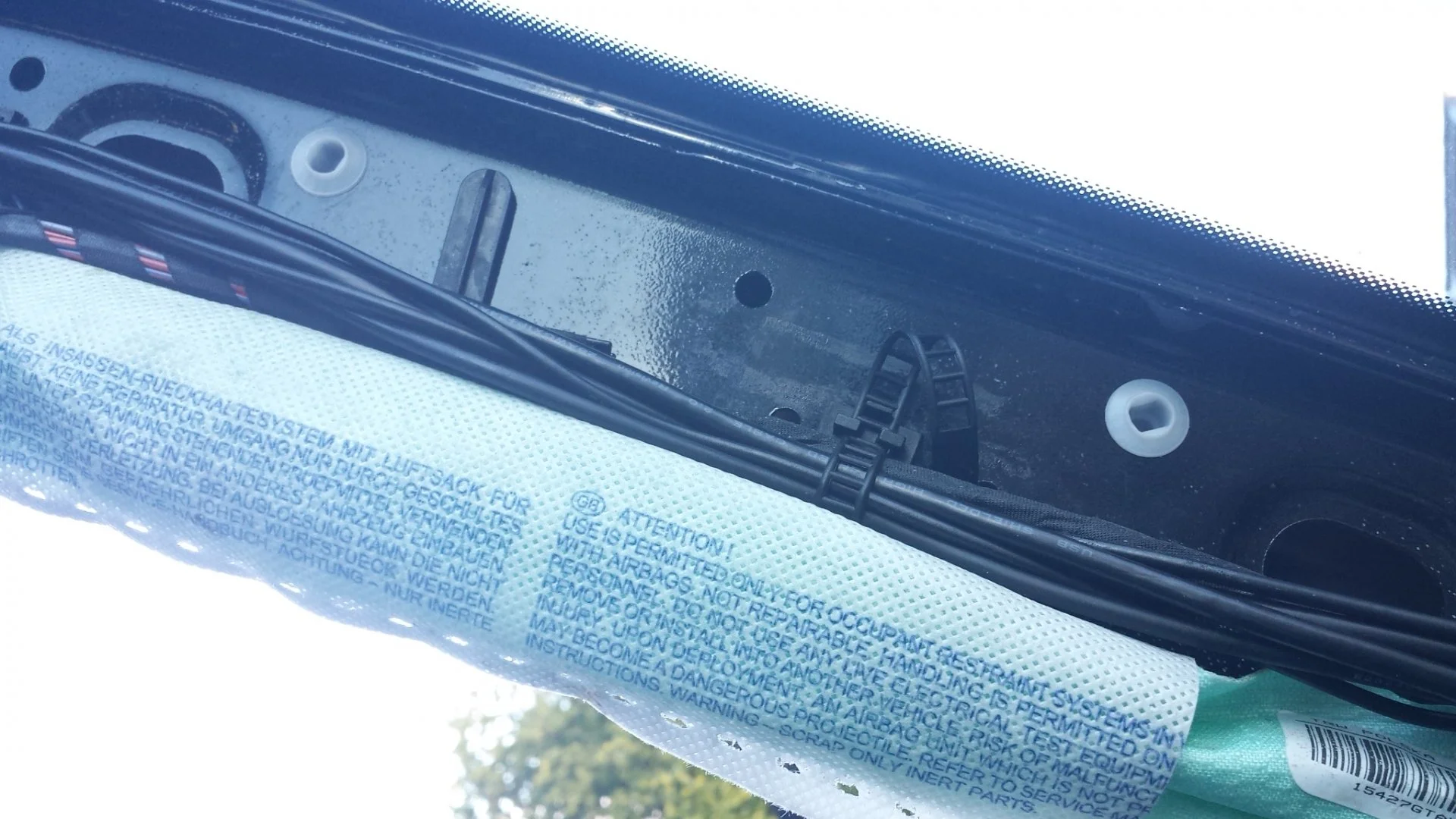

Just as an important reminder for those who running / hiding any additional cables behind A-pillar trim panel, make sure you use some cables clips to mount additional cables / wires to be securely fixed BEHIND an Airbag and not freely hanging to avoid risks of airbag not deploying properly when ( God forbids ! ) something bad may happen.
I am tiding up wires in my car this weekend and made some pictures. My both a-pillars have 5-6 additional cables running trough, so I had to use bigger size cable clips zip-tie and double sided tape, but if you run only few wires, then the smaller ones will do the job.
