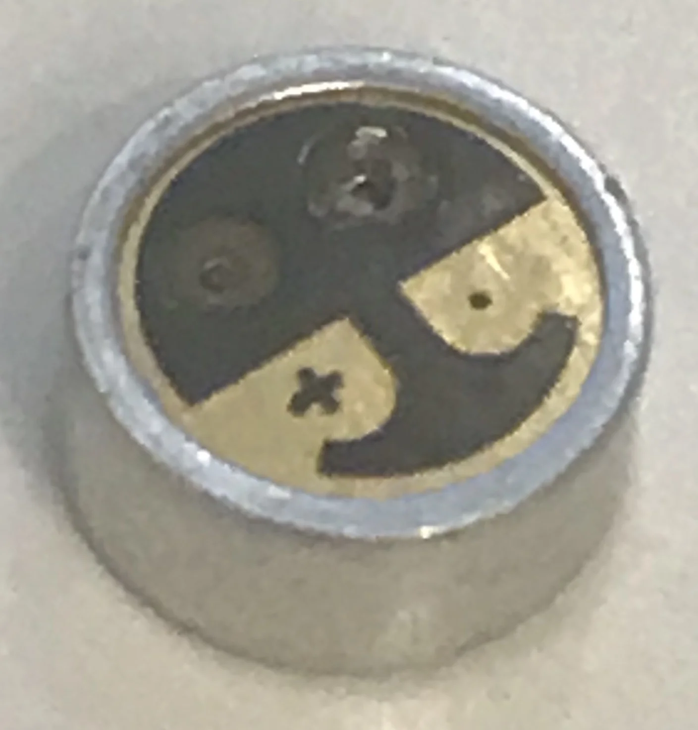

so... after my F750, I started to have the same problem with my F770.
But, as i thought of myself as a pro (since I did such a wonderful job on my 750), i think I went in too fast & without thinking...;
i replaced the battery & put the camera back together. - Easy!
However, although the camera stil worked, it didn't resolve the time problem.
I then had a closer look at the old battery... which al of a sudden seemed to look more like a capacitor!
so 2 questions:
1st; where IS the actual battery as i did not see it?
2nd; is there anyway that i can solder back the capacitor, or alternatively where could i buy a new one?
FYI: I did sent several email to TW about the issue, (it's not normal that both cameras started to have problems after 2 year), but as per their wonderful policy they just don't reply...

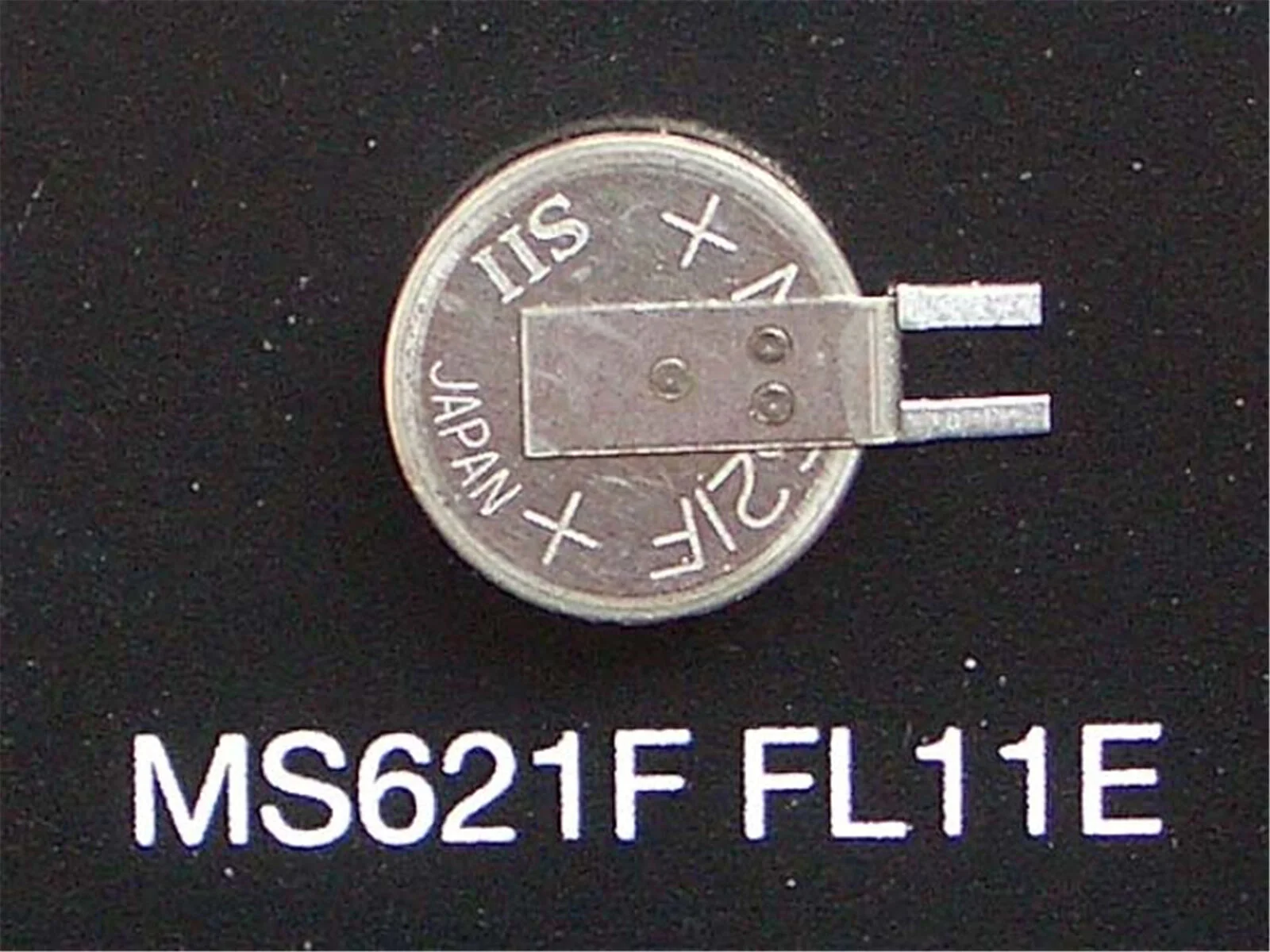

I strongly suspect that's the microphone you have taken out! I think you will struggle to re-solder that back in. The battery looks like below:

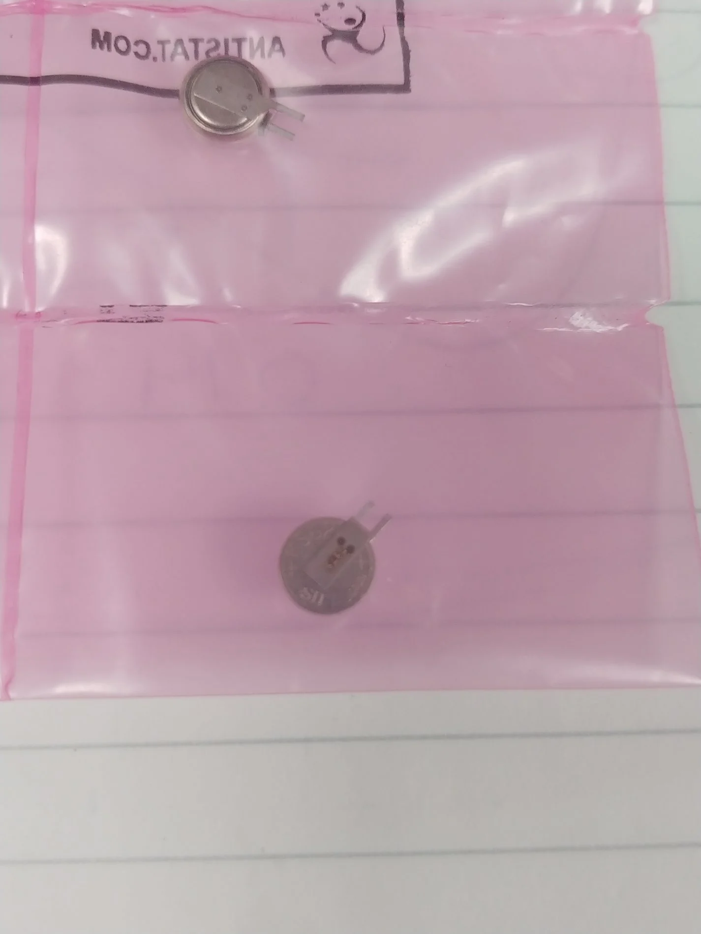

I had a run of replacing about 6 batteries in units approx a year ago (the cameras were around 3 years old) we then bought 100 batteries for stock and i haven't replaced one since!
thanks, feel very very stupid.
I guess the battery is under the 2nd print plate, that I didn't take out (since I thought i'd already found the battery)
as i said, i went too fast, because i do know what the battery looks like, since i changed it in the f750...
already ordered a new one ebay (eur 1.80 from china... no idea how that is even possible...)
if it's indeed the microphone that i took out, it's not too bad as don't realy need sound.

I managed to un-solder the battery and solder it in the right place
Was pretty difficult to do, and to be honest i did not think it would work;
it seemed i had damaged the printplate and that the battery was not making contact, but....
Correct time & date are back :-)
impossible to re-solder thge original mic though, so ordered a new one from amazon, which has 2 "legs"
so it's easier to solder it back on...

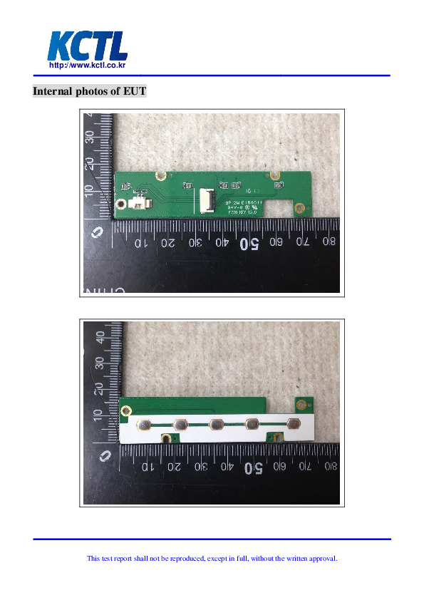

Does someone have pics of the battery into the cam?
I have same issue after 2.5y :-(
Enviado desde mi MI 9 mediante Tapatalk
what model of cam do you own?
F770 2ch
sorry, I have no idea what that camera looks like inside. Hopefully someone here owns one and has taken pictures of it before.

Ok... an update. I’ve replaced the $8 button battery and the camera is operational again. I’ve sent an email to Thinkware customer support requesting a replacement dual camera system that won’t fail due to a cheap on board battery, particular when the camera is supported by a $400 Cellink battery.
