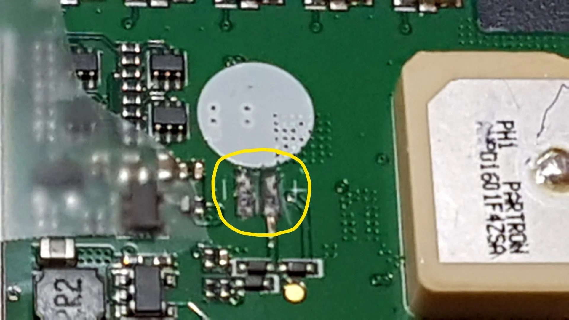

I then re assembled the camera carefully the circuit boards back into the case, noting that the broken corner screw hole on the board was not going to cause any problem, the remaining screw firmly held the boards in place, plugging the camera back into the car was a big disappointment the camera showed no life at all.
So I removed the camera and dismantled it again to check nothing had unplugged, nothing was found I then rechecked the replacement battery it appeared to be soldered well, but I attempted to resolder the battery thinking it may have suffered a cold solder joint, in doing the re solder work both of the tiny contacts on the board itself detached from the printed circuit, I'm now in a situation where do I go now its not possible to solder the contacts back to the board certainly not with the equipment I have, it may be possible to solder two fine wires to the circuit board and solder the replacement battery to them and then secure the battery casing to the board with glue or double sided tape.

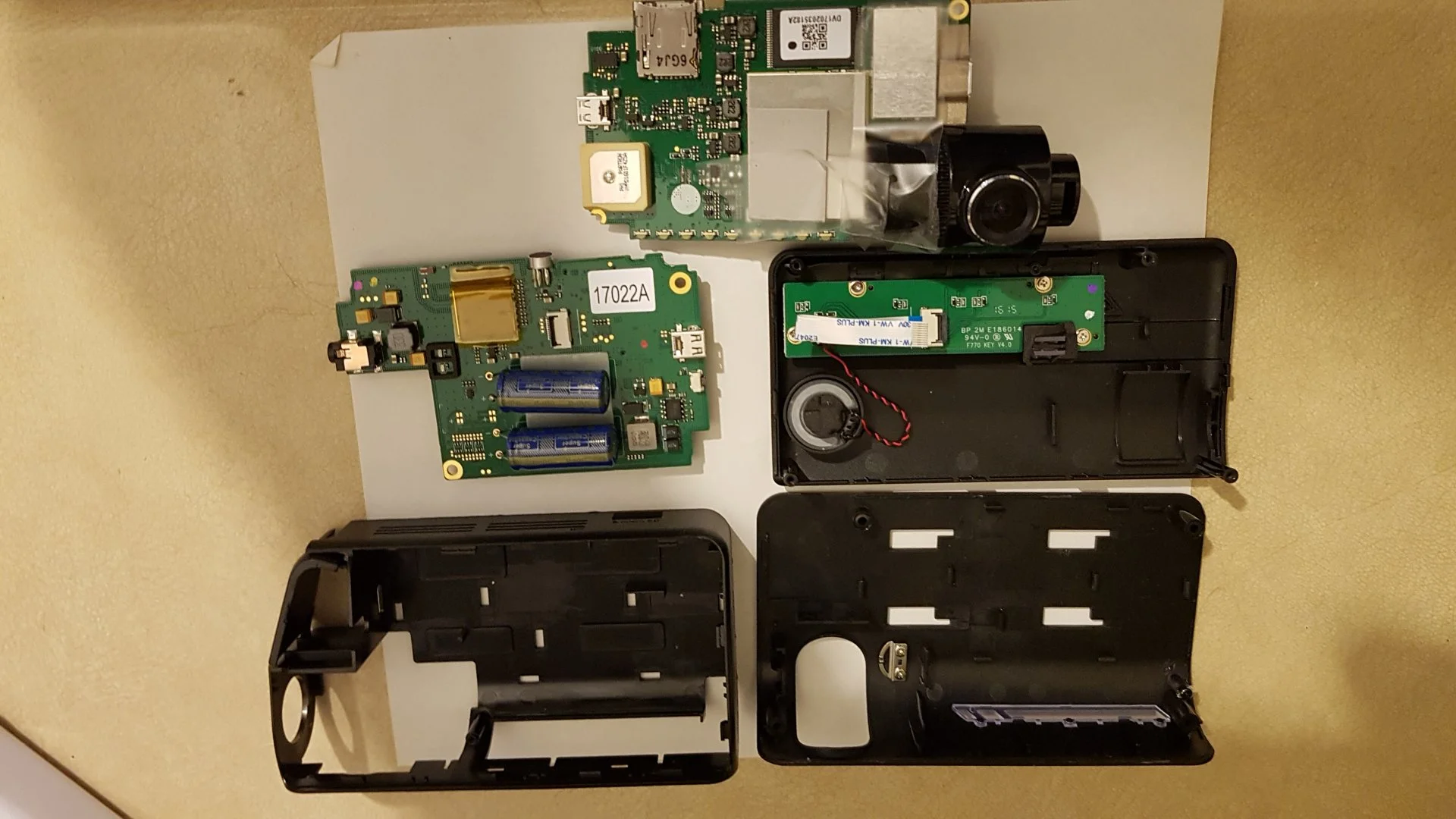

As another member suggested putting some photos of the dismantled camera to help others I did take some photo's including where the battery circuit board contacts on my board broke off, also you can see where my circuit board screw hole fouled the case on removal and broke the corner off.

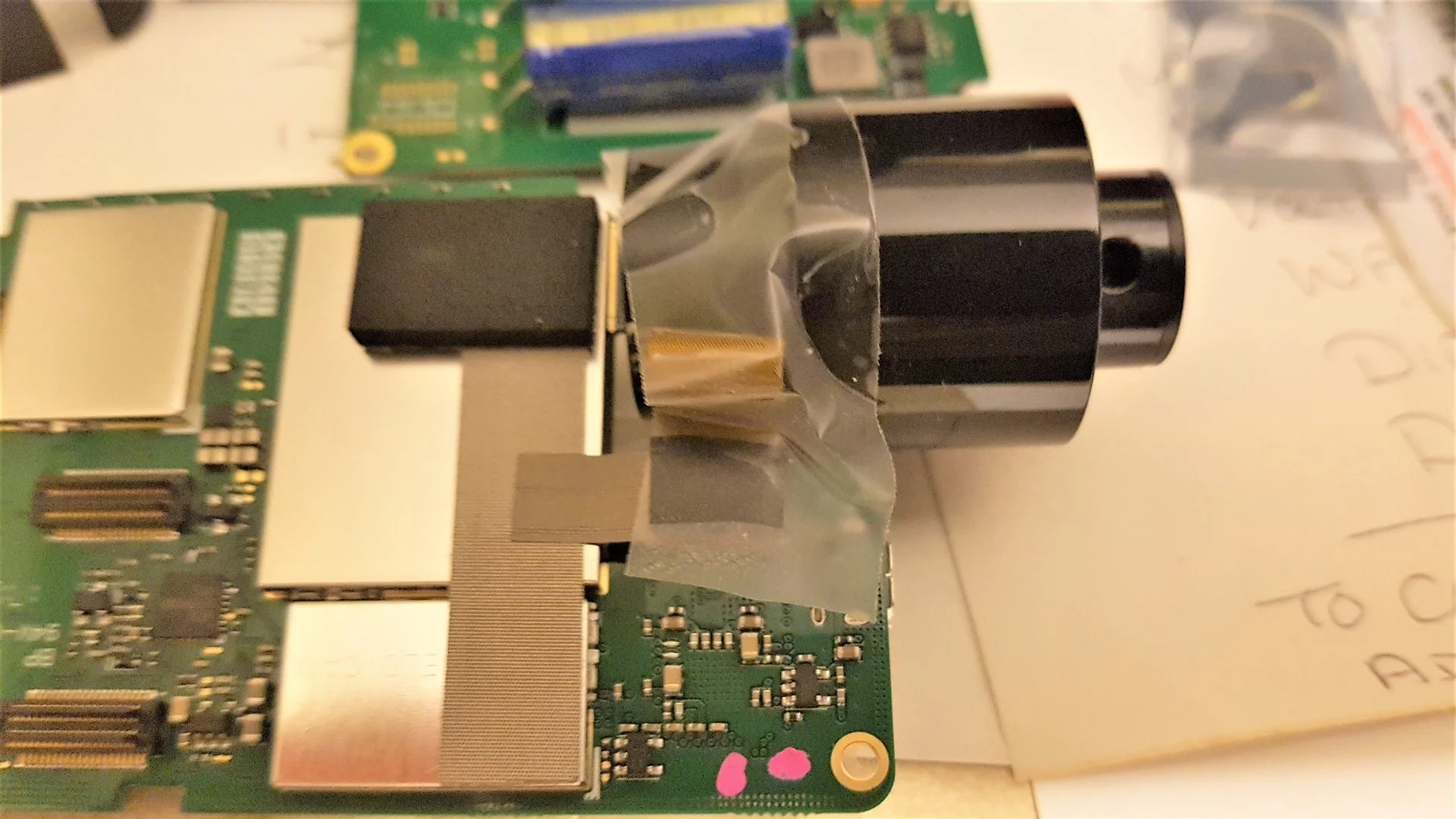

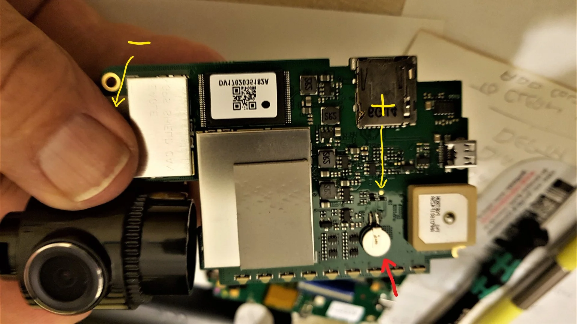

Update - I have managed to salvage the camera from my previous disaster after attempting to resolder the RTC battery in place, I had a mishap and the printed circuit battery contact pads & traces got detached from the board.
After some thought and also checking on youtube regarding repairing damaged circuit board traces and pads, I came up with a possible solution which would also mean if successful it would be easier to replace the RTC battery again in the future without any risk of damaging the circuit board again.
What I did I used a multi meter set to continuity test and checked for continuity from the positive damaged trace and found the round pad marked in the photo gave a continuity, so I soldered a thin insulated wire to that pad, I then checked continuity for the negative damaged trace, this proved to be a bit challenging mostly because all the close by negative ground would not be able to take solder, I then checked some mesh netting for ground continuity this was being used to ground a socket, I then soldered a thin negative wire to the netting on the under side of the board which is attached directly to the metal part of the socket, using the multi meter again checking both wires still gave a good continuity.
I stuck the new battery down with double side tape to its original position, but decided there was to much flex which may cause the wires to eventually break on the solder joint, so I used some epoxy glue to set the battery in place this could be easily removed if required in the future, I then soldered the positive and negative wires to the correct pre tinned terminals on the RTC battery, checking again after completion for continuity from the battery to the other previously soldered ends, all looked good so I was hopeful this time it would work, after finally reassembling the camera and plugging back in success at last it worked perfectly with no more messages about reformatting card for data integrity.
Unfortunately I did not take a photo with the wires in place but have marked on this photo where I got my solder points from, the positive point is the round pad shown, and the negative point is on the under side of board where the grounding mesh is touching the metal part of the socket.

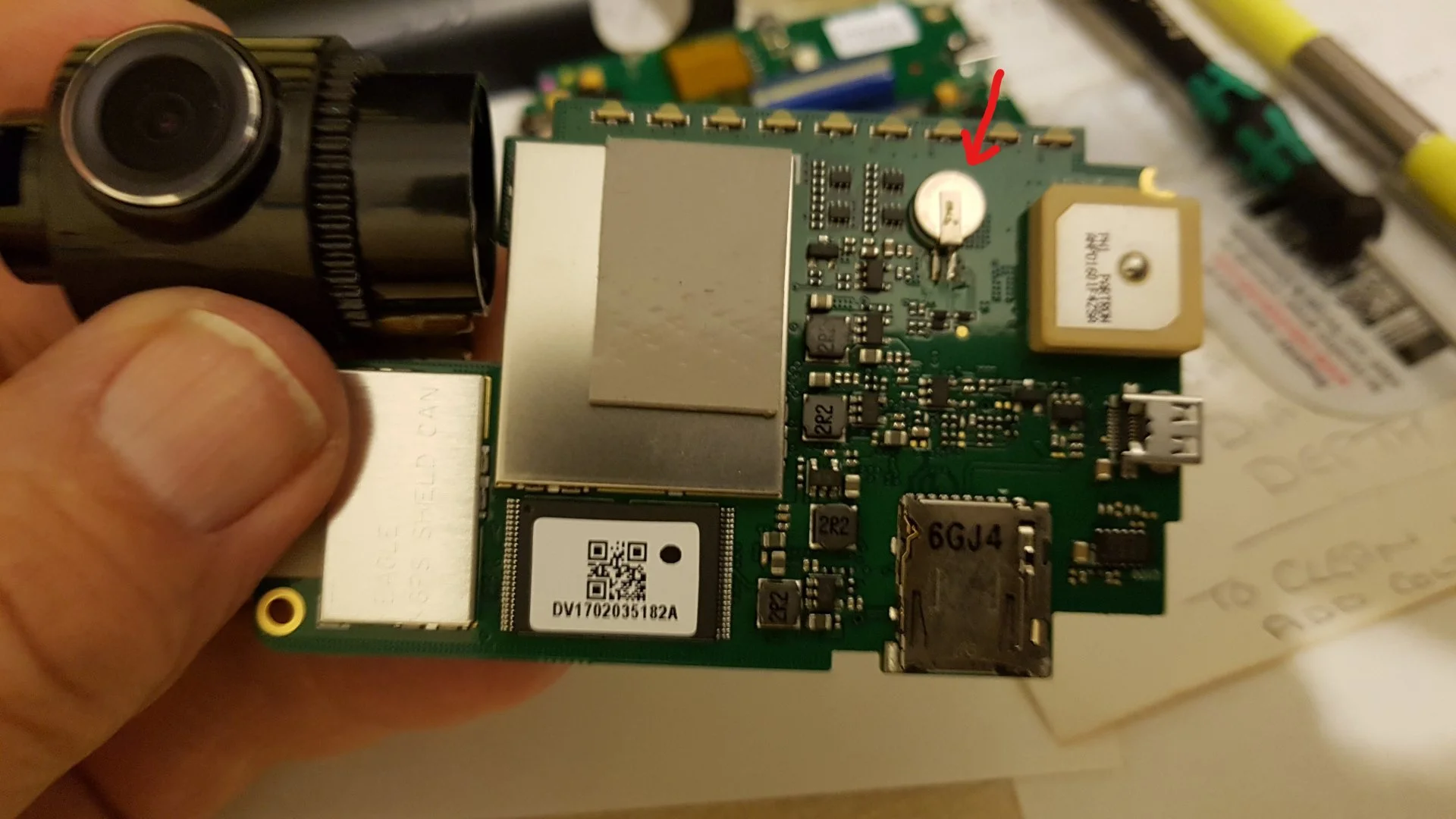

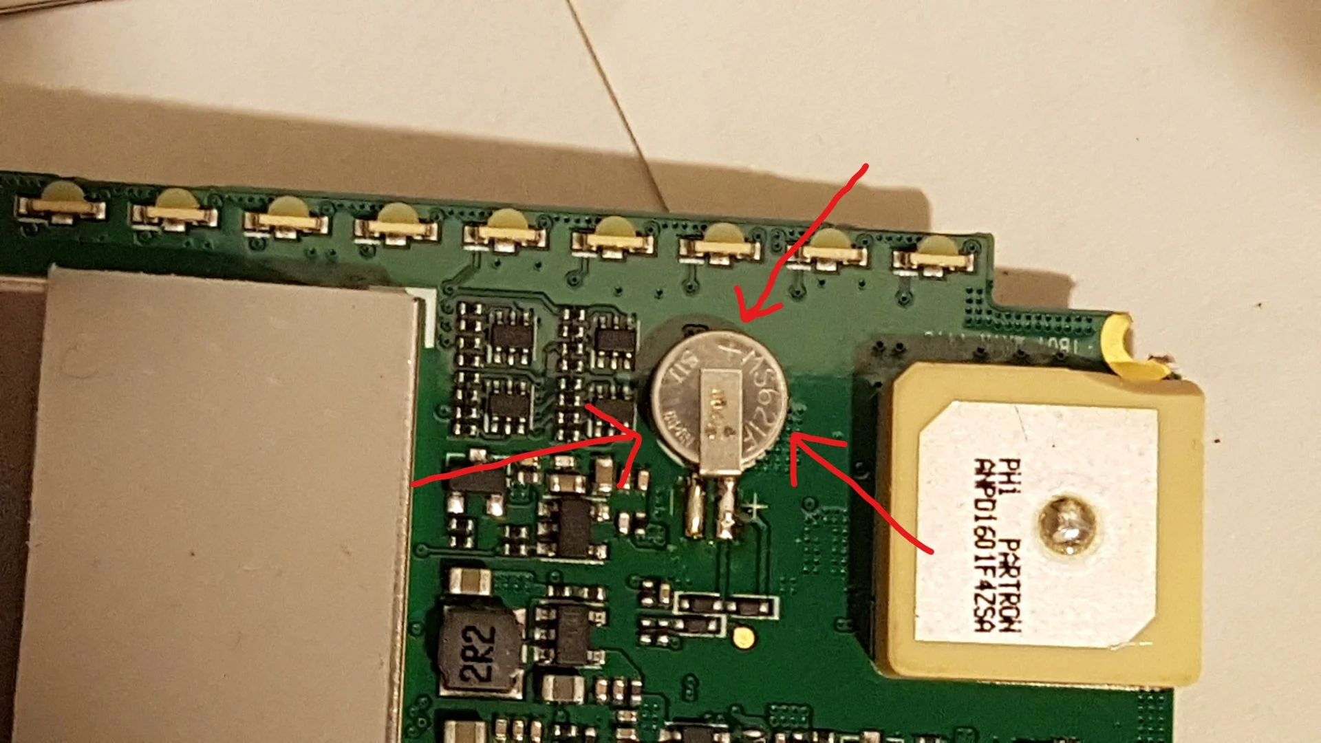

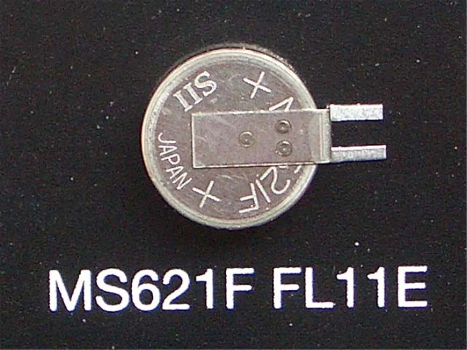

Yes it's a cmos battery, similar to a pc motherboard. I'm an IT consultant so had my suspicions when I spotted it after taking it apart.

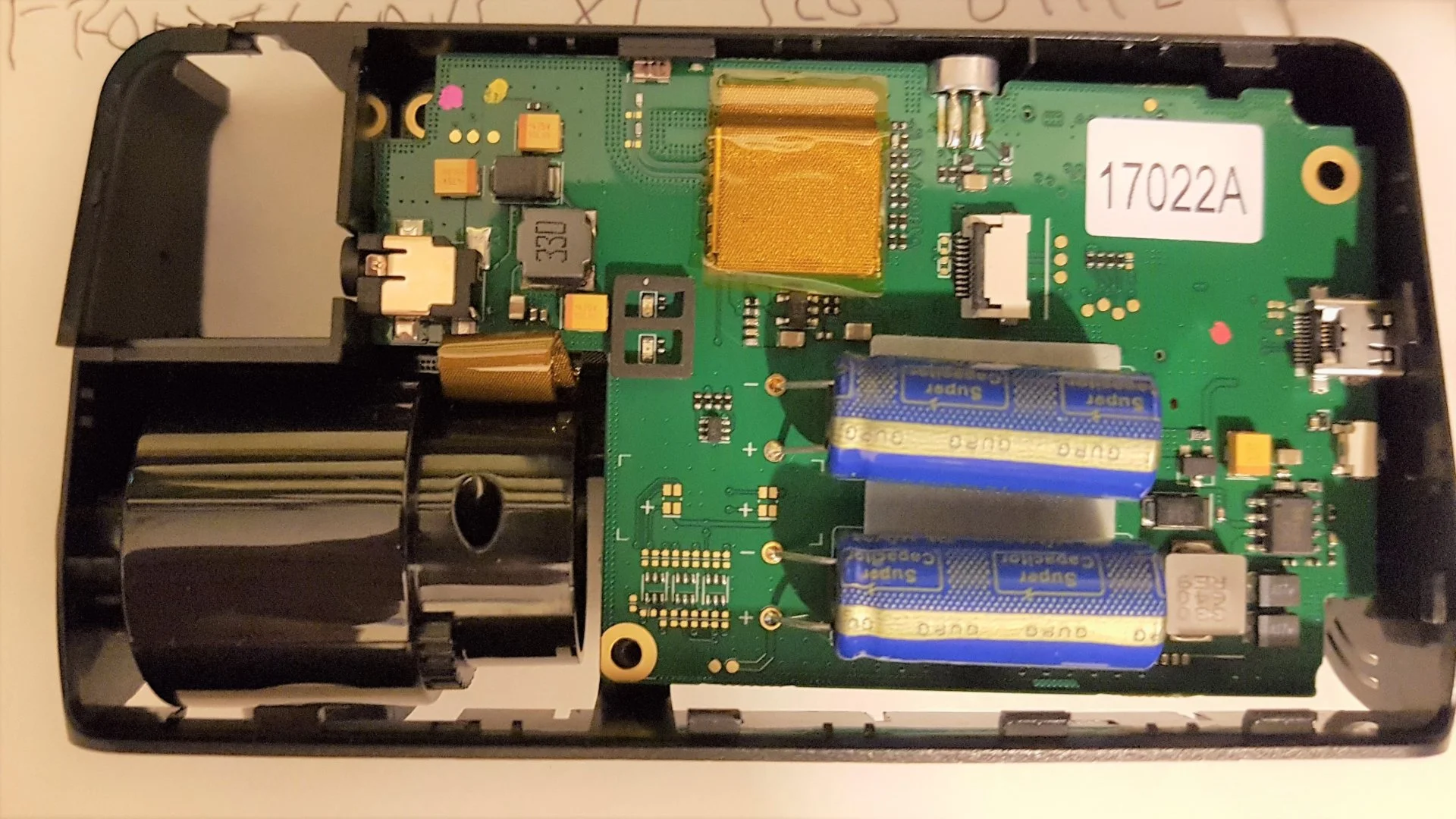

Not really sure a how to guide is needed, it's really just pull the 4 rubber hole covers out, undo the 4 screws and pop the top off. There's an additional two screws inside holding the two circuit boards in place but that's all there is to it. Just be careful not to tear the ribbon cable when popping the top off is all.

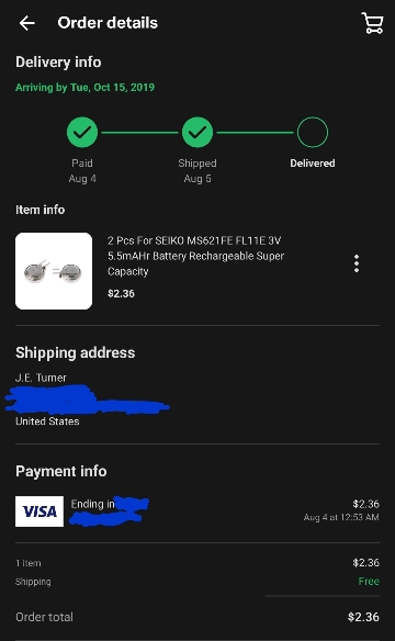

Battery number is written on it though perhaps a little difficult to read. It's MS621FE. It's a rechargeable button battery that comes complete with contacts and so replacement is pretty straight forward. Got my replacement on ebay.

it's very easy to find. it's underneath the 3rd printplate and looks like this:
