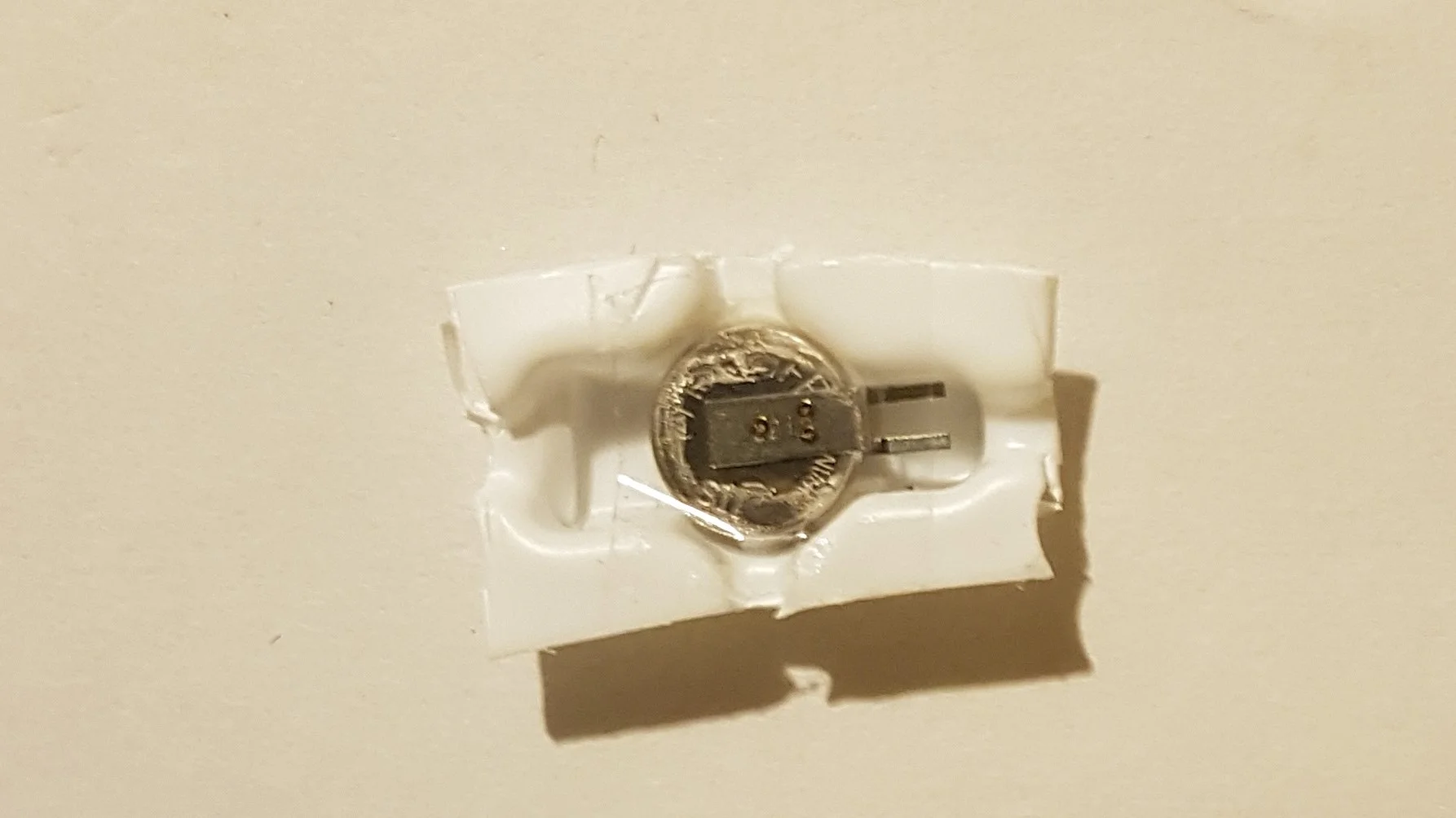

Battery changed few weeks ago, no problems with the camera since that. I had the new battery from eBay (actually I bought 2 of them), both's voltage was 2,8x V instead of 3 V, but that's still by 2,8x V more than the old one had. πŸ™‚ I hope the dashcam will work without any issues at least for 2 years.
I did the battery replacement & all was good for serveral months already. Thanks to all contributers of this thread! But I do suggest if you are not a technical person, don't do it or risk changing a new camera! Beside disassemble the camera for the second card underneath, you need to have a good soldering skill as the terminal are so close, probably 2mm apart! When postive meets negative! Bomb! πŸ™‚πŸ™‚
