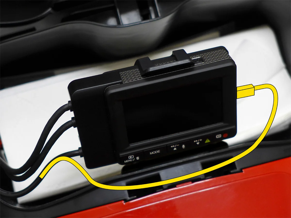

It was for me on two units, the supplied #4 USB power cable that was six inches long! I have two units one for my car and one for bike and both units (K1 & K1S) and I resolved the crashing and recording errors during riding/driving. To fixed this I used the supplied #4 power cable with the A/V output, this allowed me to use what ever usb cable I want. And for the first time since I bought this DVR unit last year, that my entire week road trip (all 1500 miles) was recorded without losing a single mile. Just remember when using this cable the DVR unit will turned off the screen when its plugged in!

NO I plugged it on the left side in the #4 slot at the bottom and used my own cable. The usb connect on the right side is PC transfer only ( I believe)

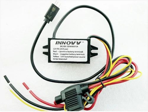

OK – I'm glad I asked! Unfortunately, I won't be able to use my own cable, because the supplied #4 USB cable is hard-wired into the new voltage converter (see attached photo). If you are using a female-male USB extension cable, do you have a link for the one that fixes the problem? Thanks again!

I just used the A/V (Yellow RCA wire at the top ) power wire then used any USB cable of your choosing. Also I have wired up my bike with two USB power converters ( http://a.co/fgaoA8G ) and thats where the power comes from.

I also have a K1S front-rear dual cam system (from Koonlung) and have been wondering for MONTHS, turning in circles, why it was impossible for it to show any picture while recording, also not showing any playback, no visible menu etc....though it used to work fine on my desk BEFORE installation into my car!
Thanks to the above posts -thanks a bunch Moto Freak- I clicked there may have been something about this USB port supply and my black screen issue...
Eventually, issue with it was that i installed it using that bl..dy A/V cable to supply it, as it is meant for!
Let me tell you: this cable prevents ANY screen picture from appearing if it is used to connect an USB supply or EVEN if is simply plugged in port #4 of the recorder while not supplying it (i.e. using inside battery) and not connected elsewhere at all!!!
once i removed it, all menus and pictures came back...
So as a conclusion for K1S systems: make sure you DO NOT supply the recorder unit using this A/V cable, but directly feed the unit with clean +12V , to avoid the screen to desperately turn black....

Here is my final report on this issue. The problem (crash of the K1 DVR system) was caused by power voltage fluctuation (surge) interference from the motorcycle starter. The Innovv K1 DVR would always boot up exactly when the bike was started, which explains why the K1 crashes occurred frequently. The solution was to insert some kind of automatic time-delay ahead of the K1, to allow the power voltage to stabilize before the K1 would get powered up.
The first attempt was to acquire and replace the K1's 12V –> 5V voltage converter with the latest updated version, which includes an extra wire that triggers a 10-second delayed power-up. That simply does not work. There is a delay on shut down (the K1 stops a few seconds after engine shut-down) but no delay whatsoever on startup. The problem continued.
My next step was to install an Innovv Power Hub ahead of the K1. This is a power distribution box, which also advertises a 10-second power delay. This device sounded ideal. Unfortunately, the PowerHub's built-in delay fluctuates randomly and considerably, from between zero to 8 seconds, mostly centered around 2 seconds, which is insufficient. However, having this device installed proved that I was on the right track, with K1 crashes reduced by 50% or more. I don't know if this happened to be a defective PowerHub, but I even tried to install it in series with the Innovv 12V –> 5V voltage converter, which should have given me a 20 second delay. This never happened, either on the bike or on the bench. I suspect that Innovv uses a capacitor discharge to "calculate" its 10-second delay in both devices, as opposed to a digital clock. This is just speculation, but it would explain both the low-cost and the random time-delay variations.
The solution: Stay away from the Innovv PowerHub and install a Rowe Electronics PDM60 power distribution module in its place. The PDM60 is pricey, especially if you use it only for its (programmable) delay feature like I did, but I FINALLY got my Innovv K1 to work reliably (about 98% of the time). It still crashes on occasion because it's a complex and finicky little bugger, but I can now basically rely on it, which is the no.1 thing that matters in any security device.
My opinion: The 10-second power-up delay should have been built into the K1 from the beginning, considering how many other features Innovv crammed into it. It took me over a year and countless hours of diligent efforts to finally conquer this problem. The K1 is no longer under warranty, but it works as advertised. I'll be getting the new 2018 GoldWing soon, and have no intention of installing another K1. Instead, I think that a couple of Innovv C5s might be a better way to go. Who cares if the front and rear videos are on separate SD cards?
