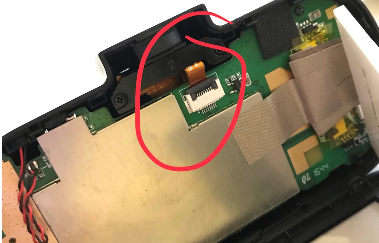

Similar, not the same. You will be able to do it with ease I'm sure.
Two screws on the top either side of the mounting connection, two screws on the bottom edge.
Undo these then pry apart, then undo the GPS tape, small black flip type clip - Image below. Then four screws around the edge.
Once these are undone just take the battery off the same way.
Reassemble.
![1539183161953.png 1539183161953.png](https://dashcamtalk.com/forum/data/attachments/42/42192-2ac408859f45c39be72f4b731d5e2058.jpg?hash=KsQIhZ9Fw5)
Reassemble.
