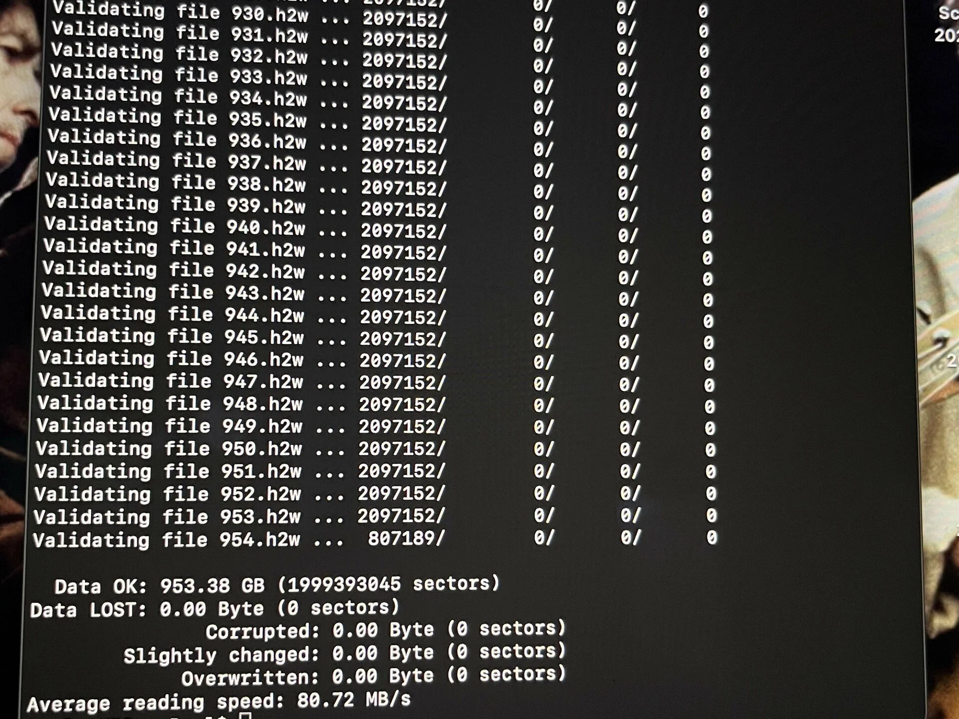

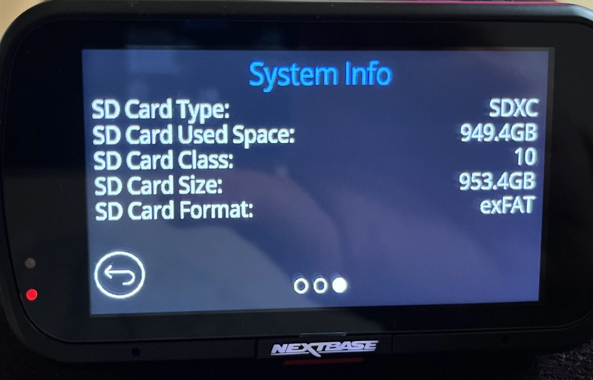

I got a 1TB micro SD card, (SanDisk SDSQXCD-1T00-GN6MA, Amazon ASIN: B09X7CFLDF, sold by Amazon) to see if my 522GW, now with version R23.7, would take it. AFAIK, H2testw doesn't work on MacOS so I used F3 & the screenshot shows that the card is ok. The other screenshot shows that the dash cam recognises the card & I recorded a few seconds of video to make sure it worked.
I've finally managed to fill the 1TB on the 522GW, although it doesn't fill completely. The card formats OK & the 522 reports the card size as being 953.4GB but it won't record more than 949.4GB. Not sure why the remaining ~4GB isn't used. It then deletes the oldest recording, drops to 949.2GB & continues to record up to 949.4GB, repeat...... I put the card into my MacBook & filled the remaining 4.53GB space with renamed dash cam files (Finder now says 186MB free). I put the card back in & the 522 reports 950.7GB used space so don't understand why the ~3GB remaining isn't useable. Might not be an error & something to do with the way the 522 firmware measures/reports card volume & usage. Either way, just some info for those who are experiencing some confusion with reported card size & usage but to confirm that the 1TB card works OK.
